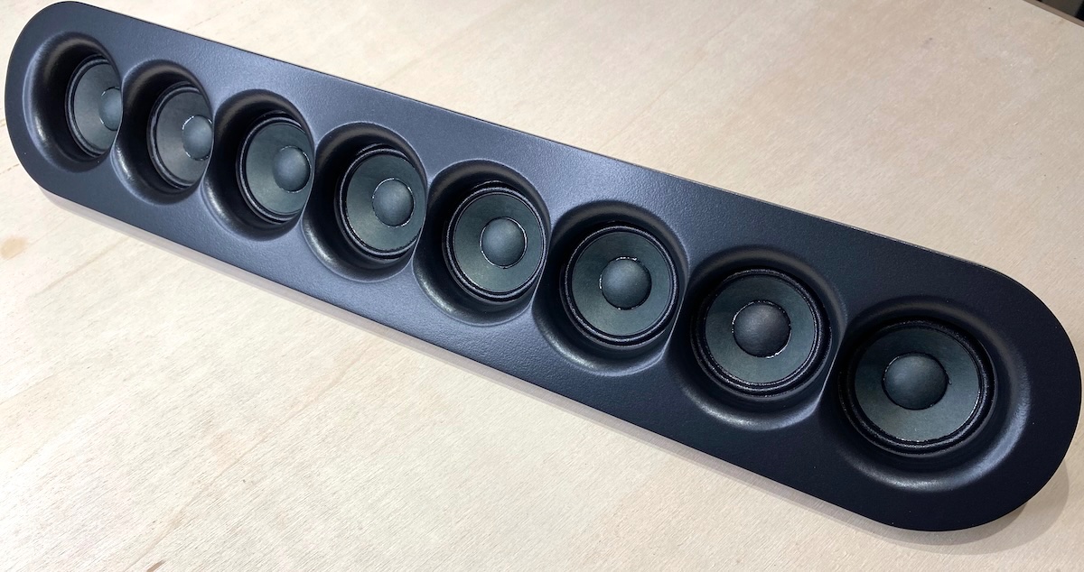

I’ve settled on using eight 2" Lavoce FSN020.71F drivers, featuring neodymium magnets and 3/4" voice coils. I could have used more, but in a typical sized room, they should be more than enough.

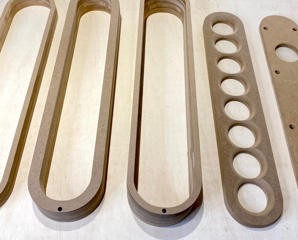

Curves certainly look nice, but they aren’t easy to make. One method for creating a curved enclosure is to form it from layers cut from a sheet of wood. I’m not very fond of this technique, as a lot of material goes to waste, but in this case, the enclosure will be very slim, resulting in little waste. Overall, I’ve cut nine layers from 18 mm MDF on a CNC router. Some layers have inner lips to mount the speaker baffle and the rear panel, plus one in the middle for central support. I also applied 1/2" roundovers to the speaker cutouts.

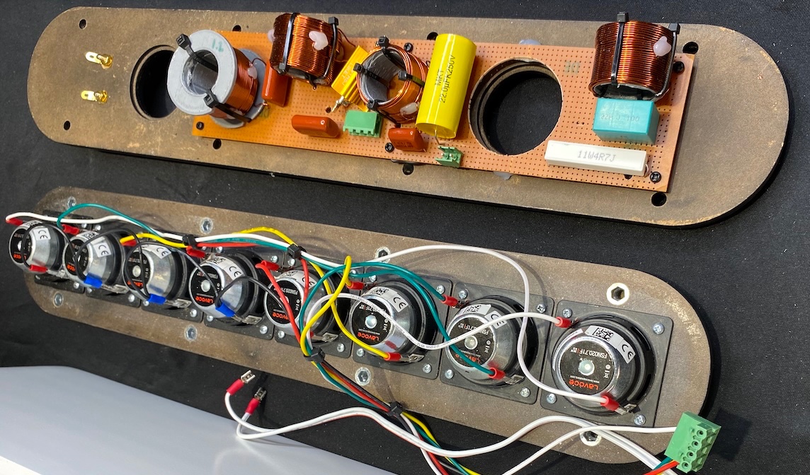

Eight drivers mean a lot of unsightly screws, which led me to mount the drivers from the back. However, that requires either a removable rear panel or baffle (or both) to access the drivers in the future. Since space is tight, I decided to make both removable by using threaded inserts at the back of the baffle and long screws, inserted from the rear panel, to attach the front and rear together.

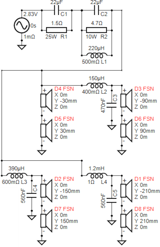

There are four banks of drivers, each with two 8-ohm drivers connected in series. The banks are then connected in parallel, resulting in a nominal load of 4 ohms. However, two filters are necessary to flatten the frequency response for all drivers: a low-shelf cut and a notch. These bring the nominal impedance up to 6 ohms.
From top to bottom, drivers 1 and 8, 2 and 7, 3 and 6, and finally 4 and 5 form each bank. High frequencies are increasingly shaded by 2nd-order filters for each bank as they move further from the center, which helps reduce destructive interference and control vertical directivity.

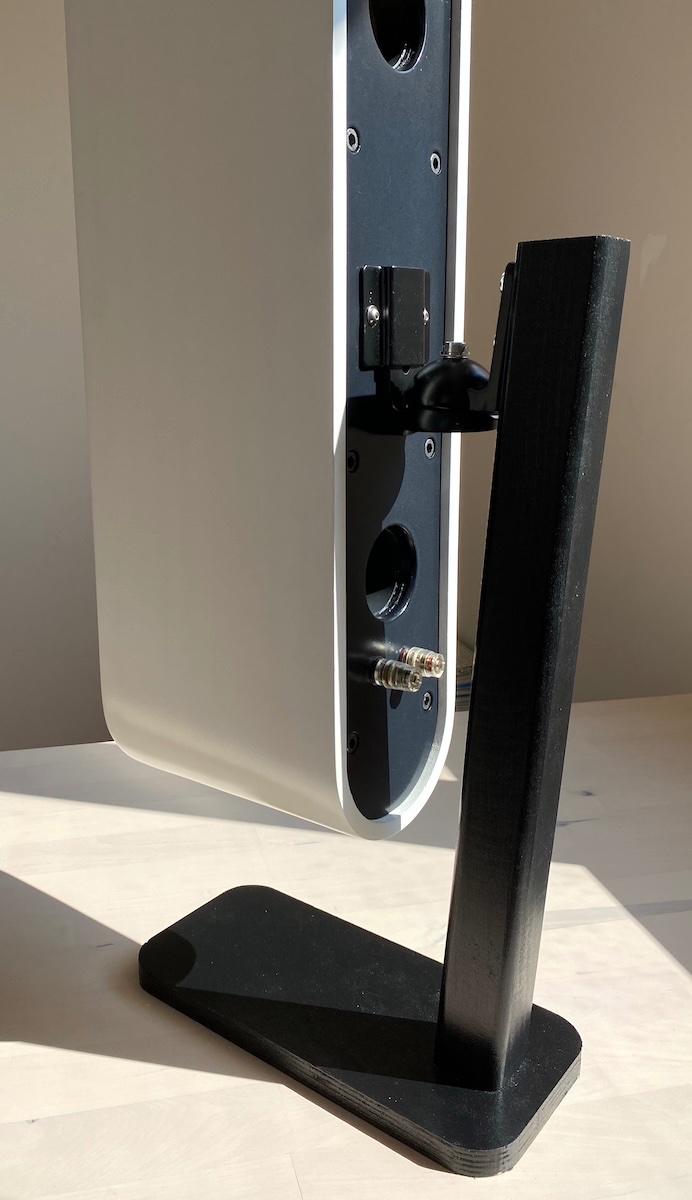

The speaker was originally designed for wall mounting, but I made a quick stand from scrap wood, incorporating the wall mount, so that it could stand on its own.

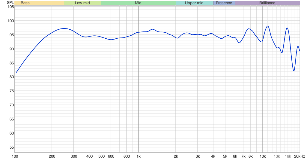

So, how’s the sound? The speaker needs a subwoofer to fill in the missing low end, but once I’d dialed in the subwoofer integration, I was greeted with clean, smooth sound, particularly in the mid-range, and the speaker can go loud for sure. At 95 dB/1m, there was no noticeable distortion thanks to the eight drivers working in tandem. As for the controlled vertical directivity, you can tell the upper frequencies decrease in volume when your ears are not on the speaker’s center axis. The effect is subtle but quite noticeable, especially when you go increasingly off-axis.
The frequency response is mostly within ±3 dB between 150 Hz and 17 kHz (measured outside, gated at 10 ms). The critical 1 to 5 kHz region, where the ear is most sensitive, is quite flat with only a ±1.5 dB variation. There are some response anomalies starting at 10 kHz since the 2" driver isn’t really suited to reproducing these frequencies well, and there are also some destructive effects from nearby drivers. Fortunately, there’s very little content at these frequencies.

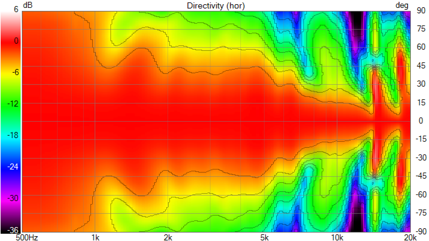

Horizontal directivity is wide at ±60 degrees nominal up until 5 kHz, but it starts to narrow somewhat after that.

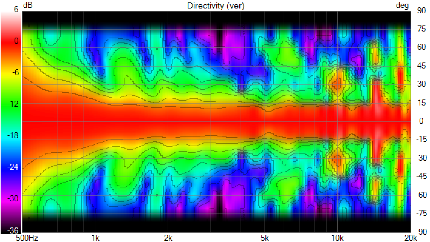

Vertical directivity is near ruler flat at ±15 degrees nominal down to 1 kHz and gradually gets wider below that. This well-controlled and narrow directivity allows precise steering of sound, which is especially well suited for applications such as surround sound speakers in a home theater, where some listeners are closer to a speaker than others.

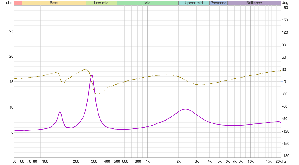

The impedance and phase plot shows no major issues other than a few minor resonances. The bump centered at around 2.3 kHz is due to the notch filter that flattens the response.
