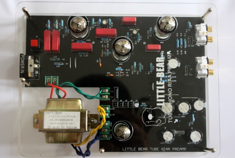

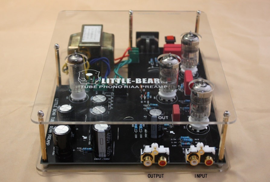

Hi Tankpopper,
Mine just arrived last week.
It had the bottom perspex plate kind of cracked probably due to mechanical stress during shipping.
The seller seems very kind and promised to send another one.
Do not expect a schematic inside. There is none. He sent me by email a pdf but it's full of mistakes. I manually extracted the schematic and will post it soon.
It sounds pretty good for the money. I don't have professional equipment to test the RIAA curve response.
The one and only thing that you MUST do is SHIELDING!
I covered all the electronics and the first tube in aluminum foil and now I can turn my 100W amplifier to max with Little-Bear phono preamp connected and it's (almost) dead silent 🙂. I'll post a photo soon.

trying to set up this new version of the bear and am getting no music, just a bit of hum and it seems the little gz4 tube is not lit up. the other three 12ax7's are lit....any ideas?
Little Bear T10 Pro Tube Valve Phono Turntable RIAA Preamp Preamplifier Ver2 5 | eBay
Check rectifier pins 3 & 4 for voltage. If you get a voltage reading, then most likely the tube is a dud, if it's not lighting up.
I don't know what the deal is with hum with preamp tube circuits.
This particular design is very prone to hum, which is well documented in the AK thread.
jeff
with the tube out and power on.....getting no reading between those pins....solder joints look good to me.
Getting sound now. something's a bit odd with the rectifier tube but seems to work now even though getting pretty clear radio station between songs. sounds pretty good, nice mids. using amperex and siemens 12ax7's

I didn't receive any schematics either, and haven't heard back from the seller yet either.
The transformer printing reads both red leads are primarys.
One has a white tape marker attached, with no printing on it.
Does it matter which wire goes to the circuit board clamps labelled 220v or 110v?
Every picture I've found show one red lead going to each . Not sure if it matters on the 2.6 version, with the toroidal transformer.
Thanks anyone, for help!
I don't want to let any smoke out.
Hi MITsound,
No, the red wires are primaries, so AC, so polarity does not matter. Just make sure the delivered transformer is of the correct voltage for your country.
From http://www.ebay.com/itm/HN-Little-B...IAA-Preamp-preamplifier-Ver2-5-/302220047365:
the transformer with 110~120V and 220~240V both version. i will sent correct version to you by your address.
Here is photo of the Little Bear with toroidal transformer: http://i.ebayimg.com/00/s/NjY2WDkzMw==/z/BgkAAOSwYGFUyOWF/$_57.JPG

I noticed there was some hum; it went away when I moved the unit up about 8 inches from my preamp.
I wonder too, if I'd hear any benefit from moving the transformer out of the case, further away from the tubes.
I'm using a 35 year old turntable, when one of the channels quit, it was just a bad plug.
I took the time to replace the not bad looking leads with shielded mic cable , almost zero hum now, and my Sumo preamp has plenty of gain in active mode!
