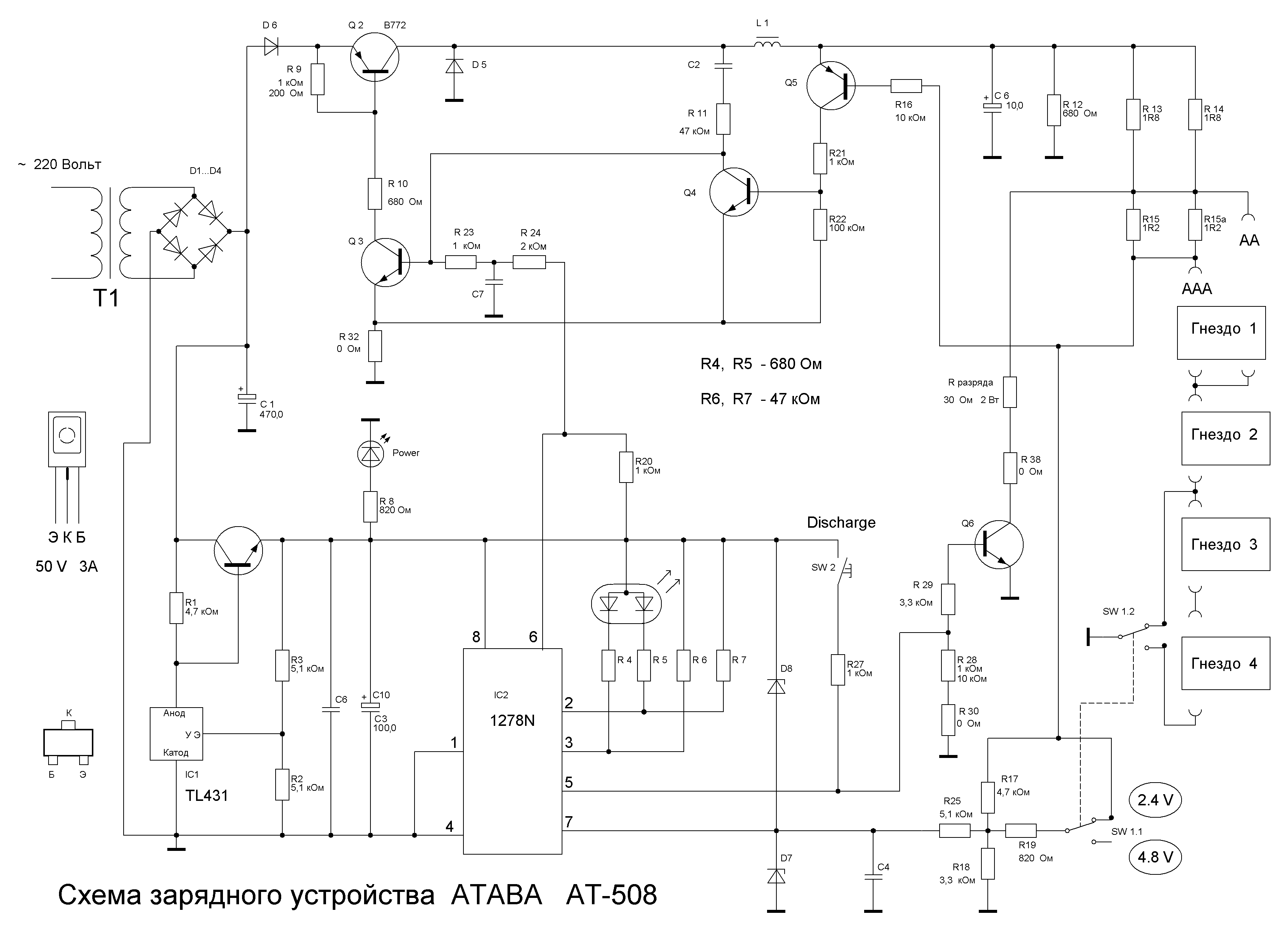

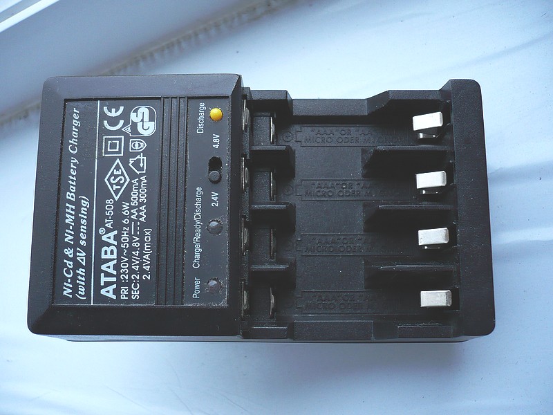

I have a digital camera BENQ GH600, it uses 4 AA batteries. Now I use it for 4xEfceell 1.2-ER 15/51 (AA/R6) by 2700mAh batteries. Show good results! On the Internet, nowhere can I find them?! As a battery charger for use ATABA AT-508 do not know ate a good charger?

See battery cherger ATABA AT-508!!😱

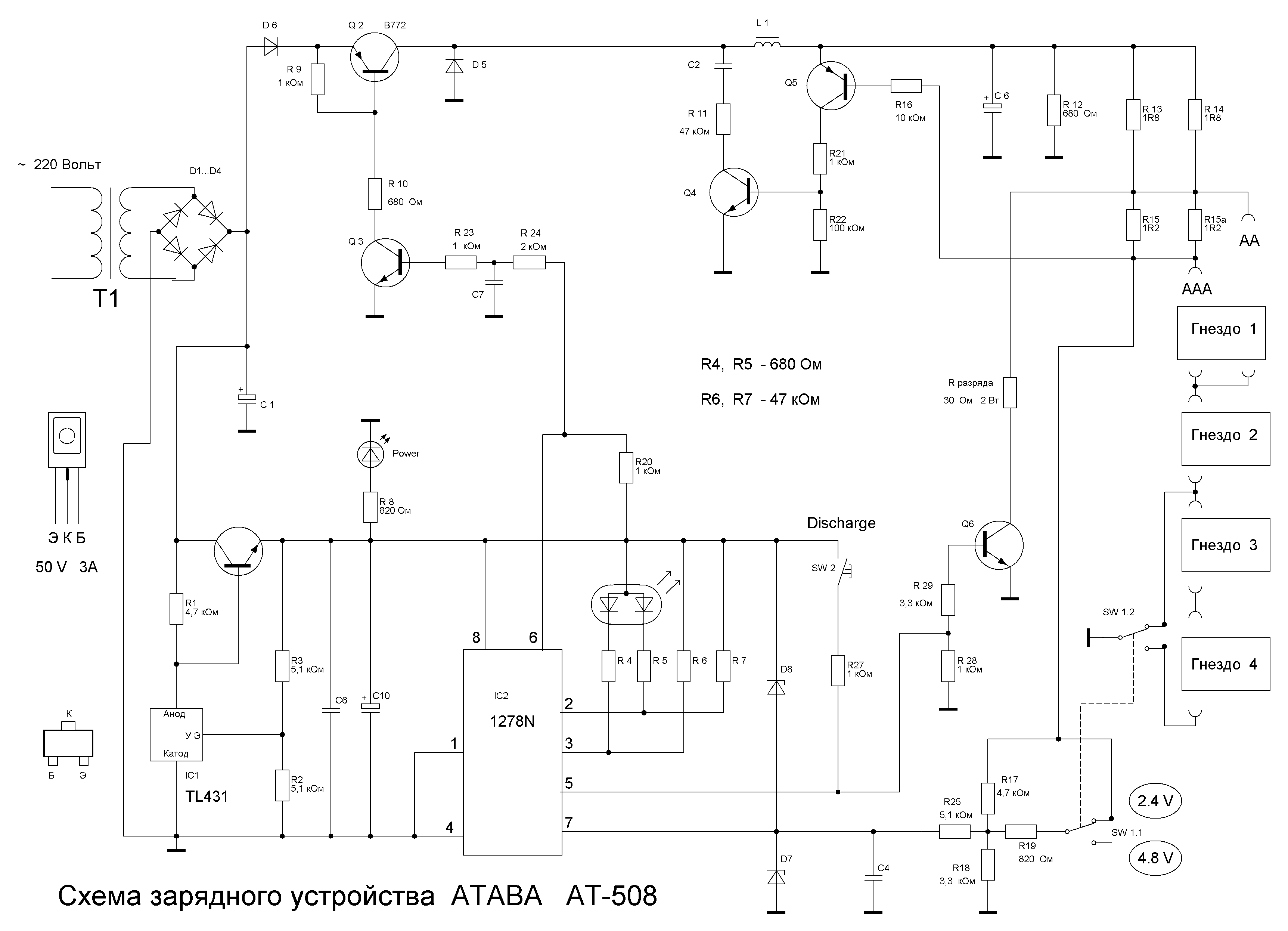

Here is the schematic charger:
Where:
Q1=XY3C
Q3=Q4=HJ3I
Q5=H2TI
Q6=HY3C
Where:
Q1=XY3C
Q3=Q4=HJ3I
Q5=H2TI
Q6=HY3C
