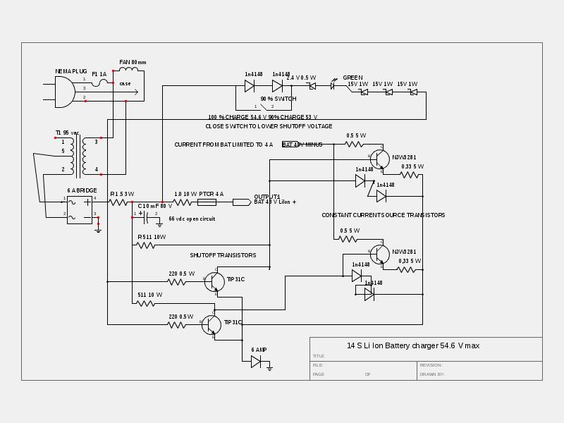

8 stack x 3.2 v is 25.2 v, which is a weird voltage for a commercial charger. You may have to build it.
cells can go up to 4.2 v @ full charge, so 8x that is 33.6 v
You might be able to get away with a 32 v golf cart/forklift charger, but those are not cheap. Those don't shut off at 33.6 v either, you'd have to build your own voltage detection shutoff with a triac or relay or something.
I built the pictured charger for 13 stack LiIon batteries, nominal 48 v, shut off @ 54.2 v . Uses a 47.5 vac nominal transformer, with a diode stack for peak voltage shutoff. You'd need a lower voltage transformer. Realize peak transformer voltage is (nominal voltage * 1.4) -1.4v so for 32.6 v a 24 v transformer would work.
The CCS in the picture is for 14 parallel cells, 4 A max, so you would want a lower CCS value for a single stack of cells. One cell won't take 4 A charge current.
Warning, do your experimenting and charging outside. LiIon cells can catch fire charging, and the only thing that will put the fire out is a pile of dirt.

what i realize is that you don't use a balancer and there is no wires between cells.just two wire one connect to first battery's negative pole and one to last battery's positive pole and all cells charge with a constant current.
am i right?do all cells charge safe?
My bike battery has 14 stacks, and a BMS (battery management system) to balance charge between the cells. The only connections are XT90 main out and XT60 charge in.
You talked about an 8 stack. If it is one cell stack, none parallel, you don't need a BMS. If it is several stacks parallel, you need a bms. The charger drawn goes to the charge input of the BMS.
