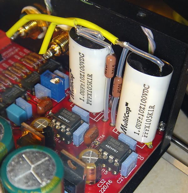

its so good for the price I've got two !
one has been modded .....
sil bridges replaced with 11DQ10's
coax in socket moved and rewired with 4n silver
opamps swapped for ad 845
output caps changed for stacked wima film caps
output rewired with silver
decouple caps bypassed with tant beads
all electrolytic caps by passed with wima film caps
psu supply caps swapped with panasonic fc's
case damped
signal path resitors upgrades
the difference with the stock unit ......
greater trancparency ....finesse...sharper imaging ....foot tapping
The NOS sound now is very good.... and runs my quad 99 dac very close......
the quad 99 feed to the modded AH is very good ......and thats currently how I have my setup. The 99 acting as transport and digital switching for my other sources.
I would say that the unmodded AH is not as good as the NOS dac but the modded one well out performs it.

Zanash. Thanks for that. How much did all the mods cost. I have some spare dual op-amps. Is the op-amp single or dual ?
its a single op amp .......
the mods cost .......in the region of £30
but I had all the bits to hand.
I also got my fist AH for about £80 total...the second was about £90 off fleabay and both got through with no import duty.

This is a std. board and below the same with upgraded op-amps,resistors and capacitors.

Its interesting to see the mods and probabley do a similar job to the ones i've done.
The big green and gold 220uf caps are worth changing in the opamp psu ...
I't may be worth running the opamp in class A too....

Not on this dac yet but in other opamp devices yes......
both with a simple resistor and a constant current source
both are worth while if not a little fiddly to impliment if you have great hams for hands.
