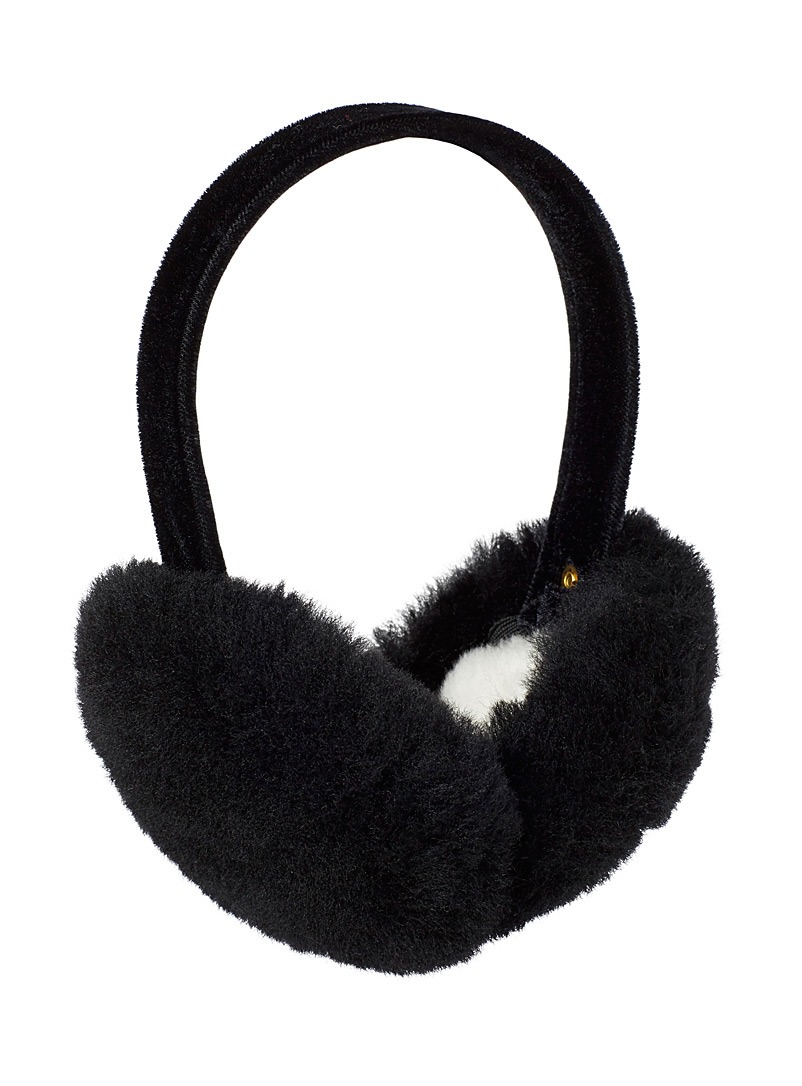

I gaurd my hearing the best I can short of wearing these.
Ear damage however slight because its so slight that your unaware when its evem occuring. Every object accidentally falling, being blown up, very high pitched dog barking, or broken car exhaust and otherwise contributes. Then I believe in turn that can also add to fatigue, or induce it in shorter time period.
However I am not a doctor.
And we have to be realistic. I avoid loud noise if it causes discomfort. Im not reached the point of wearing these around yet.

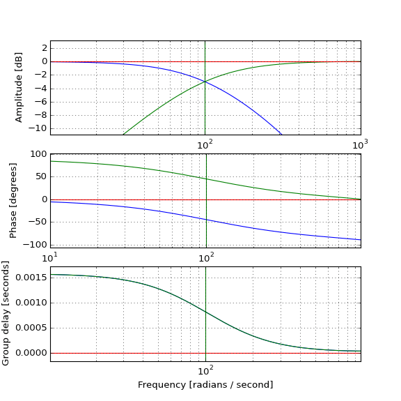

3. Phase and group delay distortion of loudspeakers (due mostly to phase growth through crossover filters employed)
In my experience, phase distortions of greater than 60-90 degrees through the crossover regions are audible (i.e., higher frequencies arrive before lower frequencies) and produce harsh, fatiguing sound quality--and timbre shifts.
