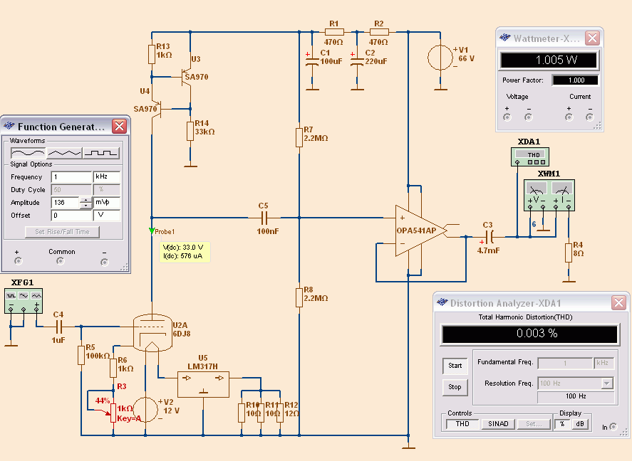

Listen to 6DJ8 Triode through Power Chip IC. Easy project.
The idea can be seen in diagram.
This is only a basic simplyfied schematic. I post in more details later.
Should be noted that these circuits are so far only in my SPICE.
But should work good and give fine performance.
Power chip OPA541 can fead 50 Watt into 8 Ohm.
Max rails are for the chip +/-35 = 70 Volt.
Here I run 6DJ8 and OPA541 at 66 Volt.
Even if OPA541 can amplify voltage, in this case it is used as buffer.
Voltage follower at unity gain.
What come in comes out to speakers.
Distortion is low and can not be perceived as effecting sound.
This means that 6DJ8 totally dominate the distortion, the effects on sound signal.
There are 2 alternative circuits.
One where Triode plateload is resistor, 100kOhm.
One where Triode plateload is a CCS constant current source.
Big difference where CCS gives near hifi performance
and resistor load gives more Triode Tube sound.
Enjoy 🙂

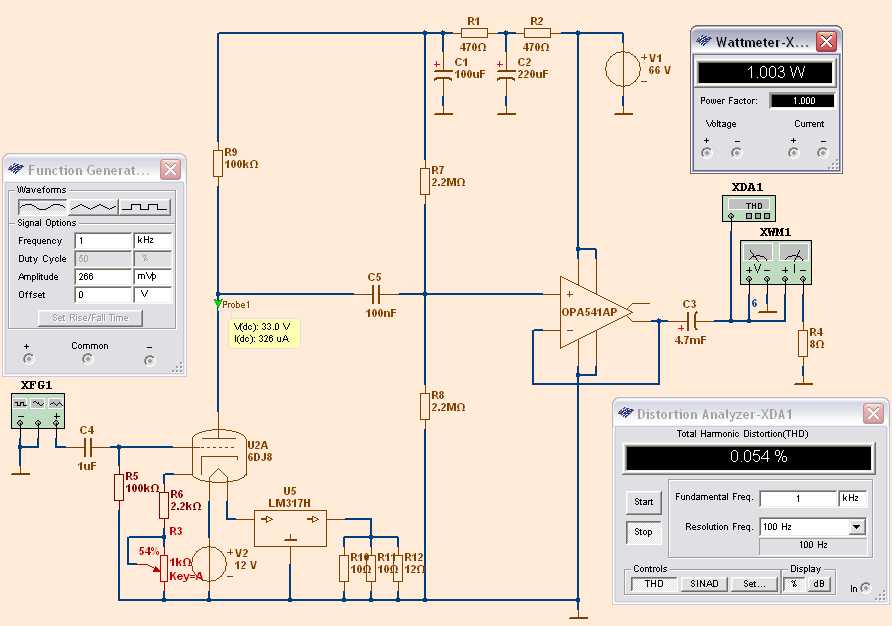

Here is Alternative 1.
With resistor 100k as the plateload.
I think this can give Triode Sound as there is a bit distortion.
The output is at least 40 Watt and maybe upto something 50 WAtt.
At 1 Watt THD, mostly 2nd harmonic, 0.054%
At 40 Watt 0.446%
The voltage gain is x15.
See figure 1 for a compare THD with Alternative 2. CCS-loaded.
Figure 2 shows the complete circuit of Alt. 1.

Here is Alternative 2.
With 2 transistors forming a CCS constant current source.
Distortion is low. Near to Hifi!
See figure 1 in previous post for THD figures.
This circuit below, or the one in post above, should be easy to build.
There are few parts and straight foward connections.
Need one transformer 2x24VAC ~200VA to give like 66 Volt DC.
Also some smaller transformer 9 to 12VAC for the heater feeding.
Enjoy 🙂

Ah, I see, you don't get that the PS detail isn't shown. That's kind of important, because lineup's schematic just shows the PS as a voltage source, you'll still need to figure out what to build.

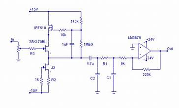

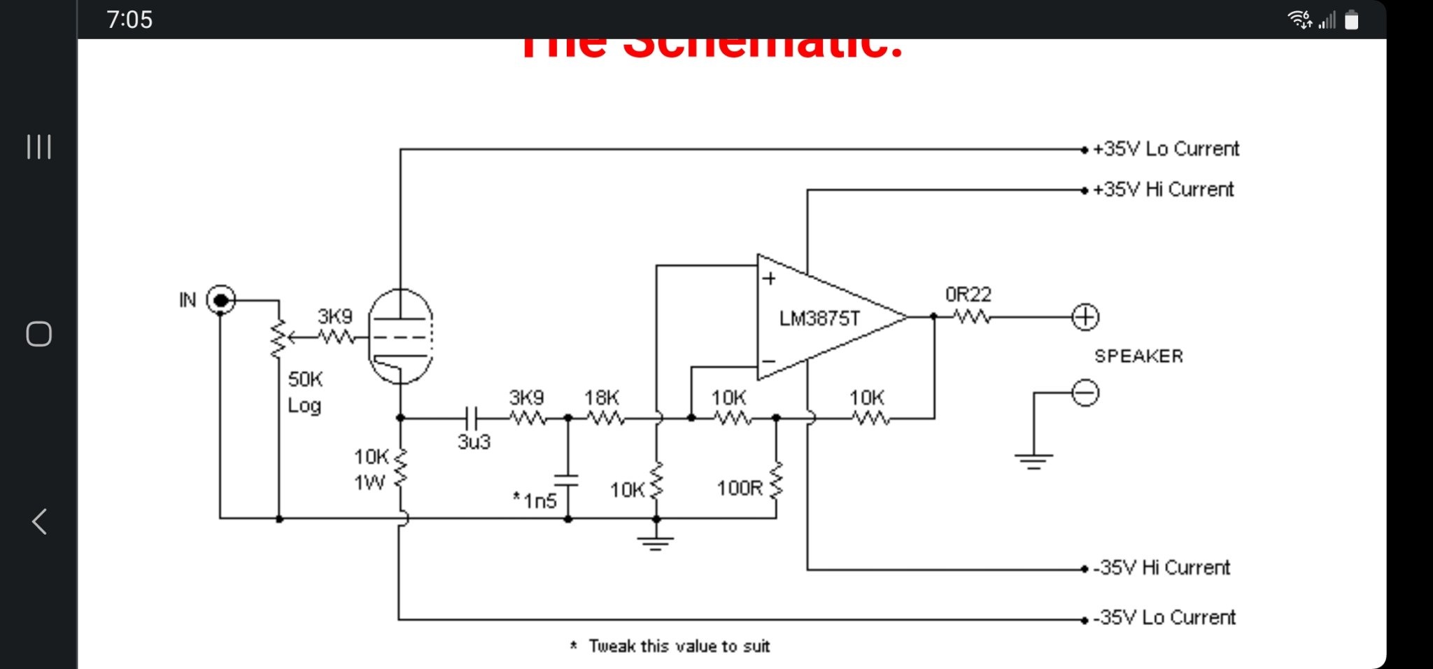

True, that's why schematics i attached is using tube as cathode follower, no gain.
But the main reason i posted it was that chip amp is in inverting configuration, signal in is part of feedback. This can not have just volume pot on the input, must have buffer. I built many versions with various jfet buffers, and the sound was way better than recommended application schematics.
But you still cant explain why the inputs carry speaker output current BECAUSE THEY DON'T.
If I want to fry chips, I should follow those last two schematics, believe it will sound better because I'm following a topology that is totally illegitimate, while bellows smoke and hot smoldering opamps ensue.
I mean, If it looked legitimate like lineups schematic, I could comment nicely, but literally those ciruits do not work and are untested and unproven.
