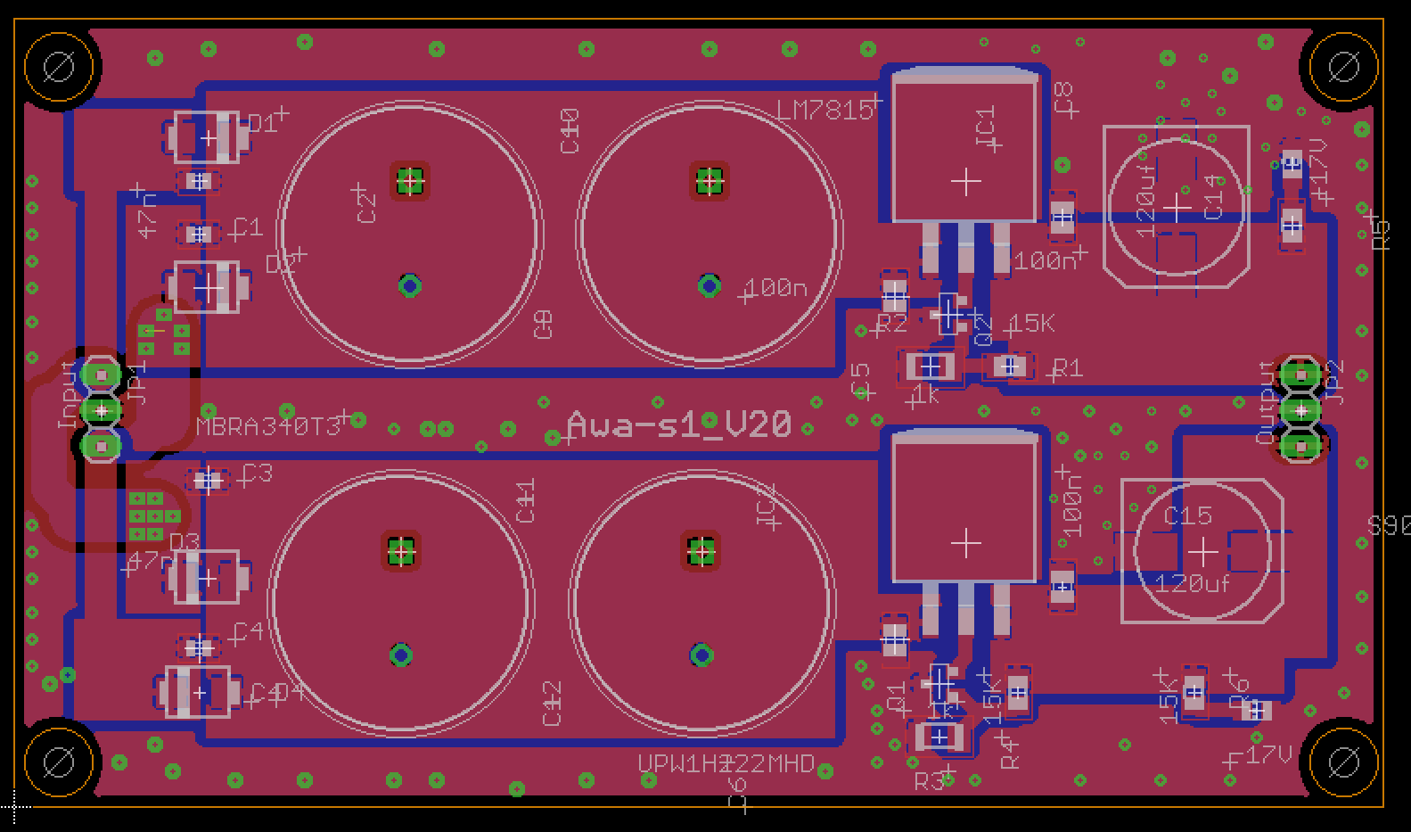

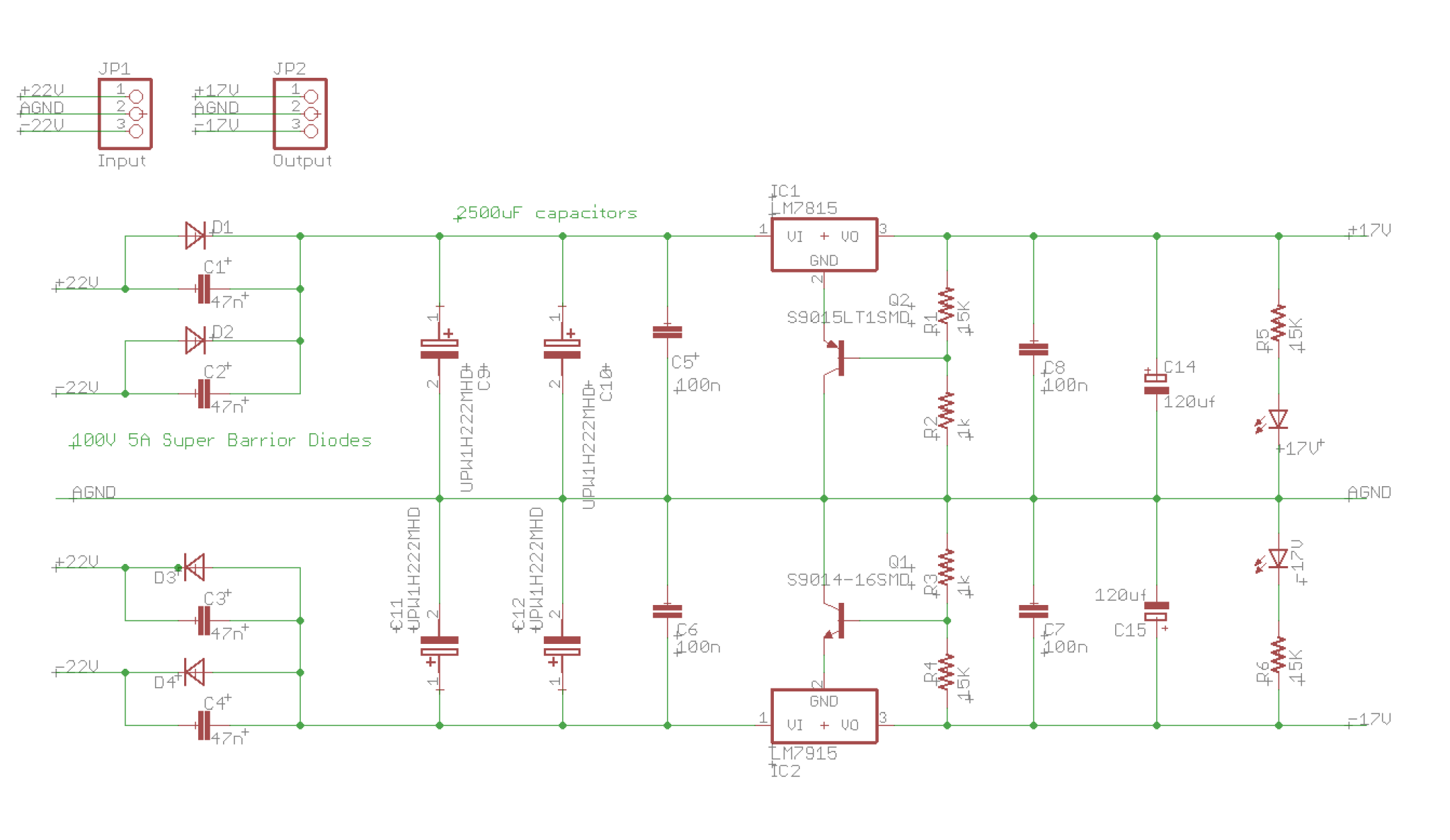

I am looking for a replacement for the BC560 to be used in a power supply that is going to be made SMD, not my design, but I made some modifications based on available parts and the a prior post on the forum. I have checked the BC847BS / BC857BS but I am concerned about the low power handling. As a placeholder for the design I used the 9015, something similar in specs to to the 560 but with a lower power rating. This was what I could find in JLCPOCB, not the optima choice. I need to use a SMD since this is a test project to learn SMD automated manufacturing. Given the low noise of the DC560 I was looking for something that would not increase the noise too much. This is the design and Board. ( input and output caps are also 50V, another change from the original design)
