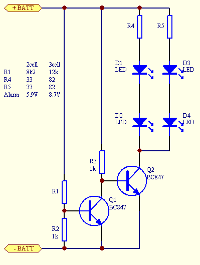

Now, can anyone recommend a low power circuit for detecting undervoltage, so I'll know when discharge has reached the approximate 10V point where its time to stop using my batterypack? I thought this would be so easy... an OP-amp comparator with a resistor voltage divider on one input, and a similar divider with a zener diode on the other. Trouble is, at least the zeners I have on hand require a good 40mA or more to stabilize thier rated zener voltage, and that's 40mA totally wasted IMHO! I'm sure there are chips for this, but maybe there's an easier makeshift OP-amp circuit I could use?
Low voltage detector for LIPOs
Well on that last topic, here's a useful circuit I've found as a low voltage detector. It's a starting point. The author apparently is using some very high brightness LEDs, presumably to be able to see the low voltage indication from the ground when flying an RC plane. For me, a little 2mA LED was sufficient for my Guitar Amp (low voltage warning). So in my case, R5, D2,D3 and D4 were eliminated, and R4 was anywhere around 4.7K worked fine. If you only have a 20MA LED, you may have to go as low as 470 ohms. I also used 2N2222 transistors, since I have so many of them. Finally I used 10K instead of 1K for R3, because I AM using such a low current LED and I just don't need very much current amplification. Plus, the 10K resistor results in only about 1mA wasted to run the circuit in its usual non-alarm state vs over 10mA. The other values shown for R1 seem "about" right, but I used 10K for a my 3 cell monitor. With the other changes I mentioned, this will cause the alarm LED to come on when the 12V pack gets to about 9.2 volts.
I was thinking something along the same lines.
Some of the ones for R/C planes etc have a "home" type feature that reduces your speed down to half, giving you enough time to get the model back safely.
These circuits are built into the speed controller, although I have seen a stand alone version similar to the one you are describing.
