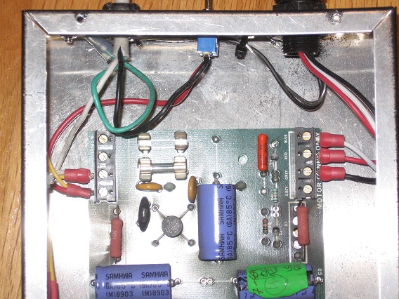

I would like to change the Valhalla (or Hercules) such that the switch acts as a 'standard' series mains power switch and not a latch. I will ONLY use the 33 rpm setting and not interested in 45. How do I change the ribbon cable circuit such that this works ?
Do it the easy way and install a switch in the incoming mains. I wouldn't touch the speed switch.😱
Check out the pic. This is my old Valhalla in an external box. You can see the switch in the center, that cuts power to the board. I'm now using a Hercules, but the connections are the same.
