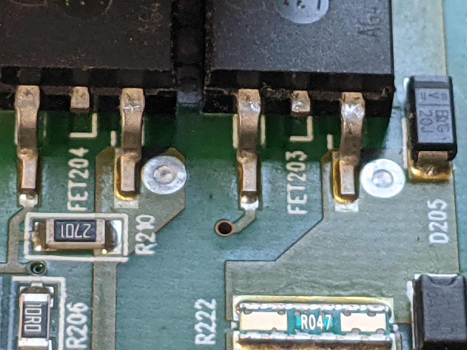

This SMPS has four open-drain MOSFETs (20N60S5) which are probably 'gubbed'! There is some scorching on the metal enclosure/sleeve but that seems to be under the ETD-39 transformer - can't find a data sheet for that either (8+4 pin) so it's not been a great start!

If you don't have a semiconductor tester a Fet/Mosfet tester is easily built but open drains are certainly not right.
Simple MM test-

Some of the larger components are easily measured as they have some form of ID but then we get to the ETD-39 transformer where I can't find a datasheet for this 8+4 pin configuration? Unless I know the windings I can't check?
Also the 20N60S5 FETs have me puzzled as only the two outer legs are connected leaving the central leg (Drain?) floating - never seen that before so don't know how to check - see attached image.
Linn SMPS
