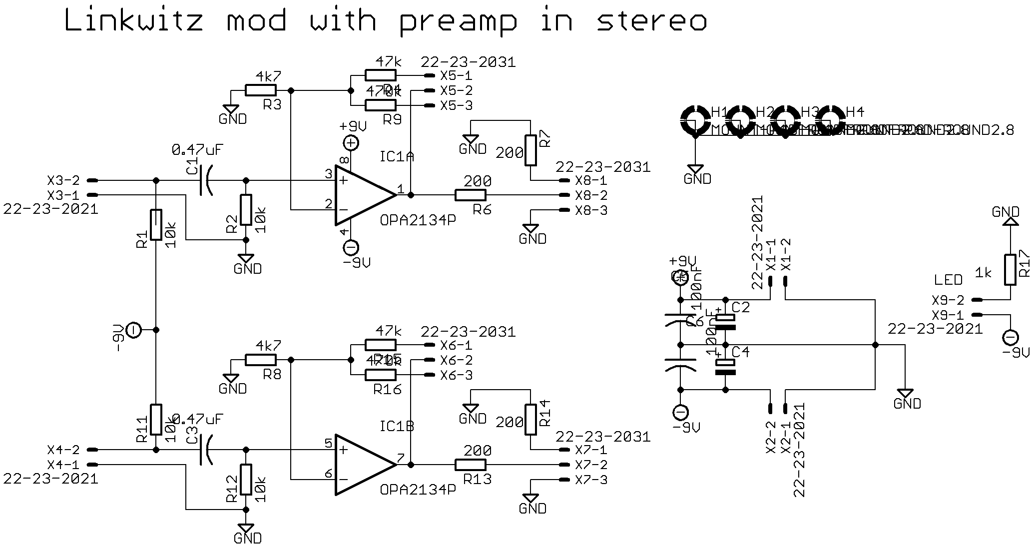

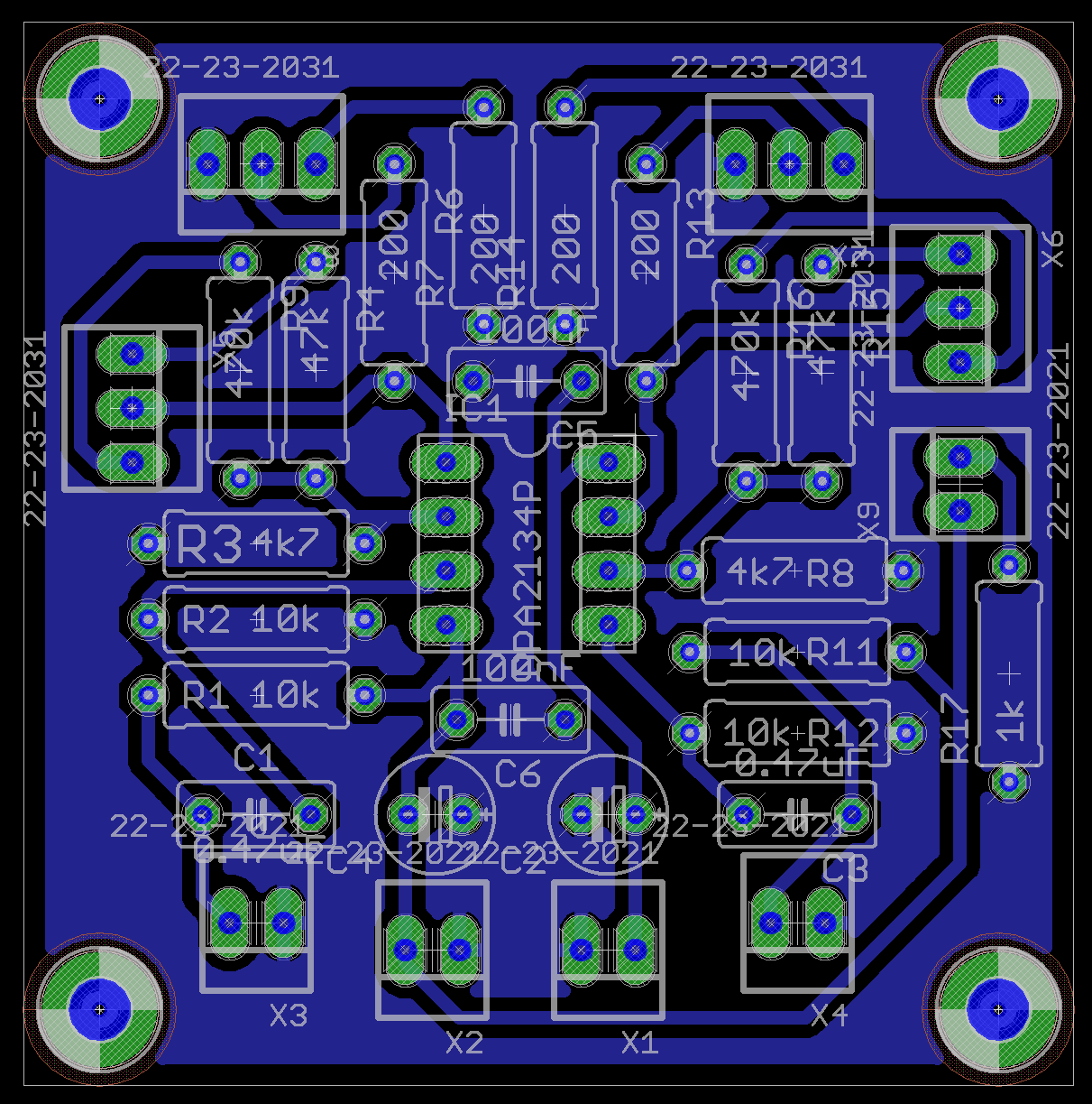

Linkwitz wm-61a mod preamp PCB, any comments?
Hey guys,
I have designed a PCB for Linkwitz WM-61a mod preamp.
I went for a design with two gain options (x10 and x100), pseudo balanced output (hence 200ohm resistors). Also, I wanted to make it as-small-as-possible and all DIP based for easy beginners assembly.
Any comments?
Thank you!
