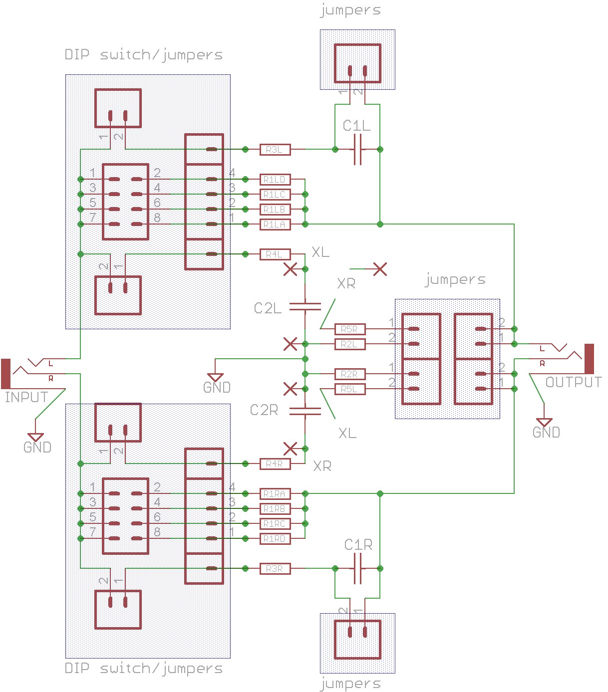

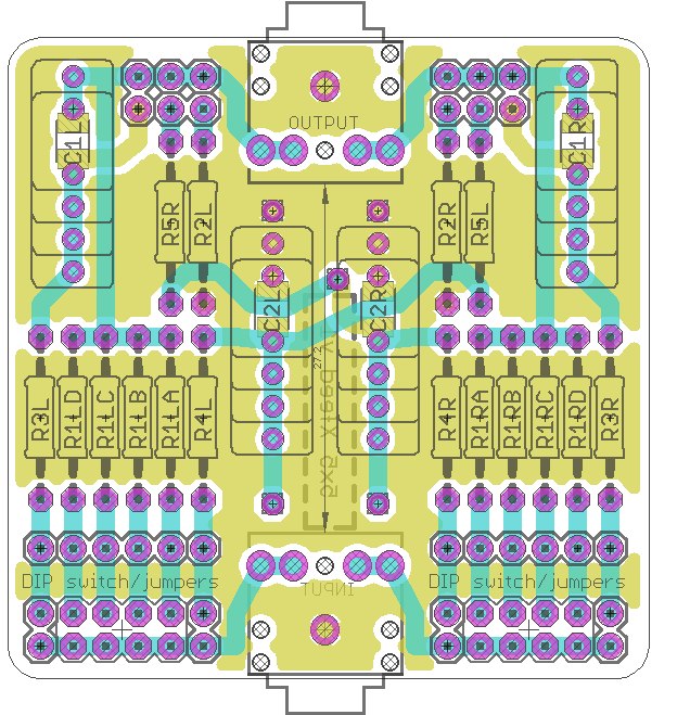

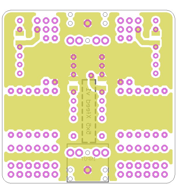

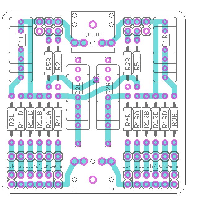

Linkwitz low impedance xfeed board
Linkwitz low impedance cross feed board & variable impedance adaptor
Configurable with DIP switches and jumpers.
Board size 5x5 cm.
Enough room to fit these caps:
Wima MKP4 0.22mF W/H/L/PCM/Part number 6/12/13/10/MKP4D032203G00
Wima MKP4 1.0mF W/H/L/PCM/Part number 7/16.5/26.5/22.5/MKP4D041005D00
Cross feed can be completely bypassed with jumpers, remains configurable impedance adaptor, 4 parallel resistance (R1abcd) switchable by DIP switches or jumpers.

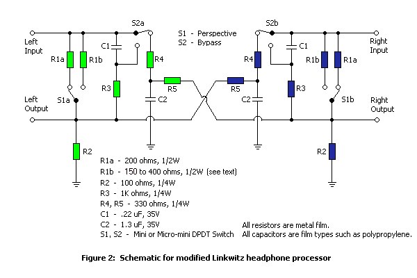

Hi Sikahr!
I like your design, it looks very clean. Do you have gerber files that you would like to share? Or maybe even just privately?
I might also want to try an smd version...
Cheers
