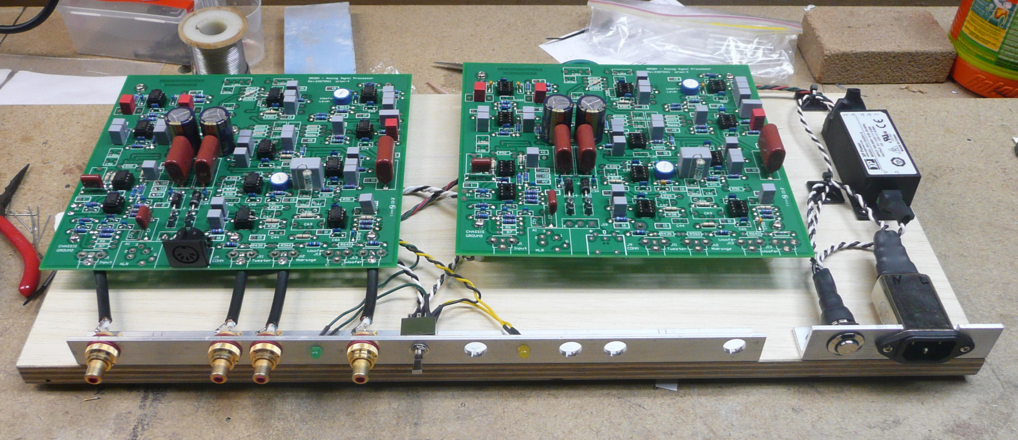

"GETTING CLOSER ALL THE TIME"
I'm getting there slowly, I'm seriously over measuring & have made the last changes for the time being. The plan now is to finish the second board & spend some time listening.
I have ditched the suggested tabletop PSU & purchased a very nice little XP Power PSU from E14, not cheap, but it is surprisingly small & looks very well made, should fit in the case nicely.
I won't be making the case until I build the Twisted Pear Dac/Preamp, then I will build both cases together.
