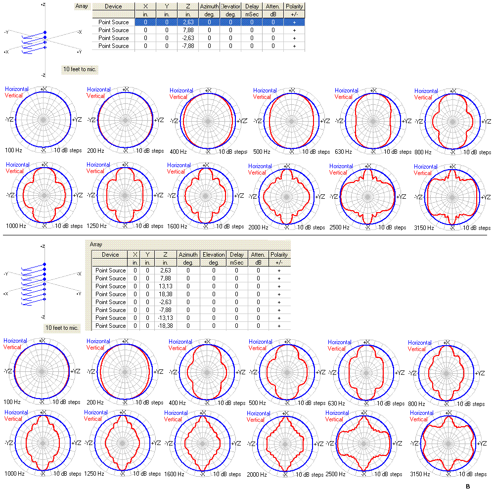

I was thinking of working up to short lines of 4 drivers, maybe possibly working up to 8 drivers per side long term. I thing I'll need to damp the back wave on the U baffles a bit to cut down on the raw concrete ring. I know I should be getting some sort of combing artifact, but I've never heard this for myself before.
Kensai,
Take a look at the simulation I’ve attached with point sources. Draw your own conclusions.
You will never get better summation from real drivers especially for frequencies over 2 kHz were the drivers are already beaming.
Just a thought :
Use 5 drivers per side. Wire the bottom 4 in series parallel.
Then 1st order series crossover them at the baffle step frequency.
Remove the centre cones and add cheap mylar super tweeters to suit.
http://www.partsexpress.com/pe/showdetl.cfm?&DID=7&Partnumber=290-010
Using 5 of the above, and converting it to a closed back vented box
with an EBS (extended bass shelf) alignment would give decent bass.
🙂/sreten.

Interesting idea. The BR should work OK from what I can see as a first pass. Decent down to ~40Hz or so anyway.
