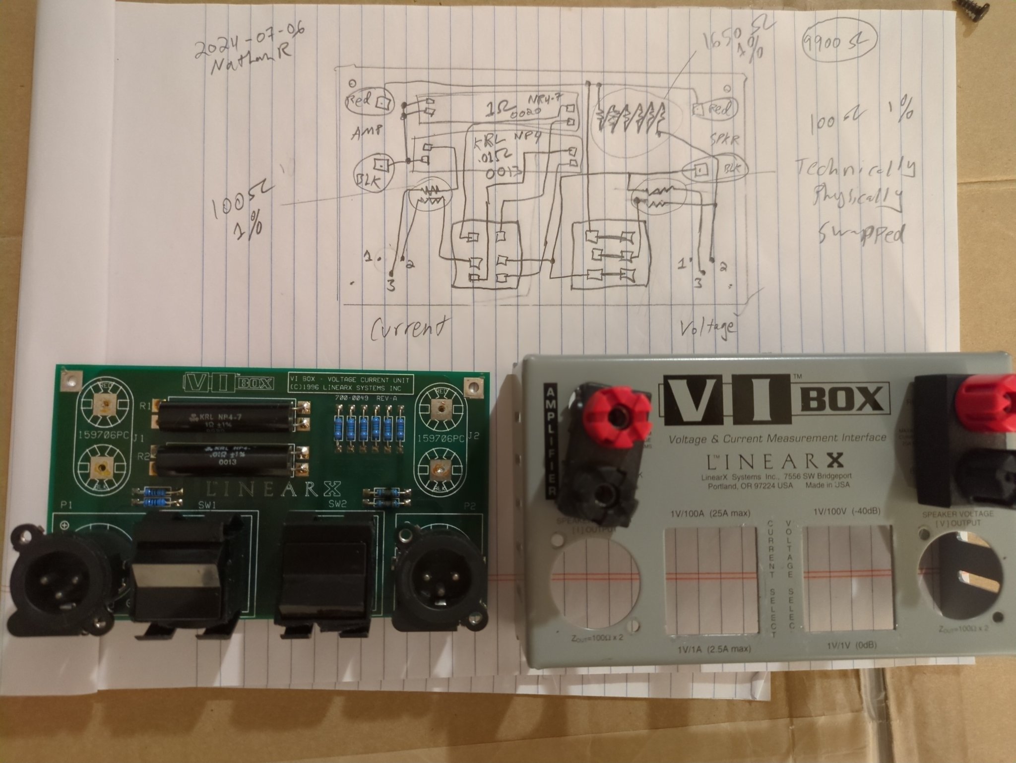

Hi bobthedespot, I'm still looking for something to assemble one replica. I would like to get some internal shots and components list.
The only documentation I have is downloadable here: https://manualzz.com/download/7201779
I do not have any Linearx software. I would like to adapt that VI-Box clone and use with some loudspeaker measurement software.

If you want the current shunt I found an ohmite replacement
https://www.digikey.com/en/products/detail/ohmite/17FPR010E/998539

Hi lightingman117, what does it mean "techically physically swapped"? It does refer to the two 100R/1W resistors?
Pins #1 of the two XLR connectors are not connected anywhere?
Schematic is functionally identical.
Physical Layout is reversed.
I used 100R 1/4W to replace, I don't think the originals are 1W, that'd be too large.
Pins #1 are connected together and U-shaped ground plane on PCB.
This Ohmite Series do not list any 1R0 current sense resistor.If you want the current shunt I found an ohmite replacement
I found KOA BRT Series (not four leads) from my italian supplier. Looking elsewhere.
I have to manage italian distributors 🙂 That's not easy 🙂
Going to get some parts, Ohmite and KOA, maybe Caddock, from my supplier. For a first prototype.

I learned recently I should use metal foil resistors to reduce inductance.
So I ordered some from mouser.
