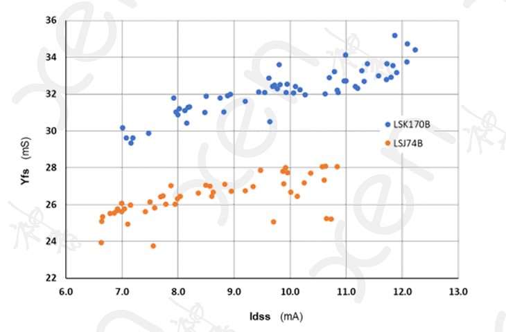

I need an advise regarding the LINEAR SYSTEMS JFETS LSJ74 and LSK170. Unfortunately I’m a beginner in this field and I think I’ve made a mistake. I intend to build the F6 amp and I have ordered LSJ74 Grade A and LSK170 Grade B.I had the feeling they have to be matched only on each type of JFET ( 2 matched LSJ74 and 2 matched LSK170) , now I realize that all 4 of them have to be matched. Am I right? In this situation do I have any chance to match them somehow? what is the range anyway (10 %...)?

For the F6, we will see a small amount of 2nd harmonic creep in with
mismatched P and N, but it isn't very serious, and since we routinely
adjust 2nd harmonic at the output stage, you should be able to null
that if you want.
Idss and Yfs Distributions
For those who no longer have access to NOS Toshiba’s JFETs, the Linear System equivalent (LSK170 and LSJ74) becomes the only alternatives.
However, little data or statistics have been published about these substitutes.
Earlier, we have published some noise data for the LSK170 compared to the original 2SK170.
Recently, we have gained access to 50 pairs of the LS devices (B grade), and have taken some measurements of them.
So here they are.
They would no doubt be of interest to those who intend to use them instead of paying extra for the NOS Toshiba’s.
Firstly the Idss and Yfs distribution of both the N.channel and P-channel JFETs.
As can be seen, there is quite a bit of spread in Yfs for the same Idss.
This is especially so for the LSJ74.
Furthermore, while the LSK170s have very similar Yfs as the Toshiba’s, the LSJ74s have much lower Yfs (~25mS) than the 2SJ74 (~40mS).
This should be taken into account when trying to substitute the 2SJ74s directly with 2SK170s.
Patrick
How about the matching yield ?
A matching pool of 50 pairs is a reasonable size for hobbists, especially considering the asking price of the LS JFETs.
Because of the large difference between the N and P channel devices in transconductance, we can only aim at matching Idss of all 4 devices.
And then transconductance between the N devices, and between the P devices respectively.
The so called NN-PP match.
The first thing to notice from the distribution shown above is that there are no N devices below 7mA Idss, and no P devices above 11mA Idss.
Those outliners will not find NN-PP partners, and can therefore serve as as NN and PP pairs only.
For those with Idss between 7mA and 11mA Idss, only 14 quads of NN-PP can be found; i.e a reject rate of 42%.
Those 13 quads can further be classified as :
3x __ Class 0 __ Idss to < 0.05mA; NN-PP Yfs <1.5%
7x __ Class 1 __ Idss to < 0.1mA; NN-PP Yfs < 3%
2x __ Class 2 __ Idss to < 0.2mA; NN-PP Yfs < 3%
2x __ Class 3 __ Idss to < 0.3mA; NN-PP Yfs < 5%
In our experience, the yield will only improve significantly with a much larger pool, e.g. 500 pairs.
Patrick

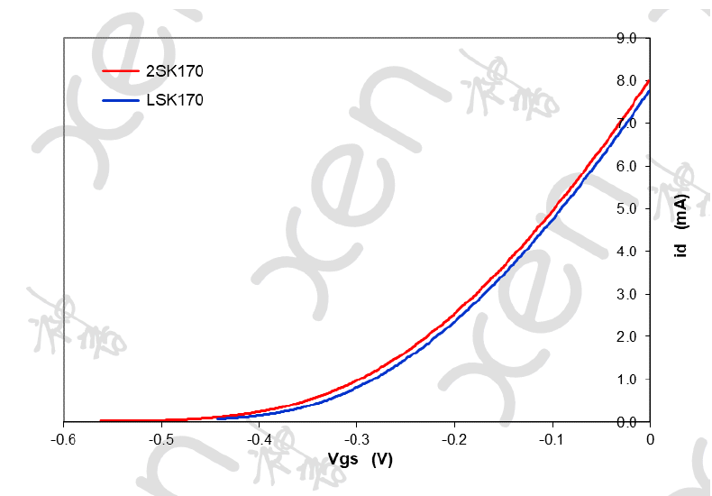

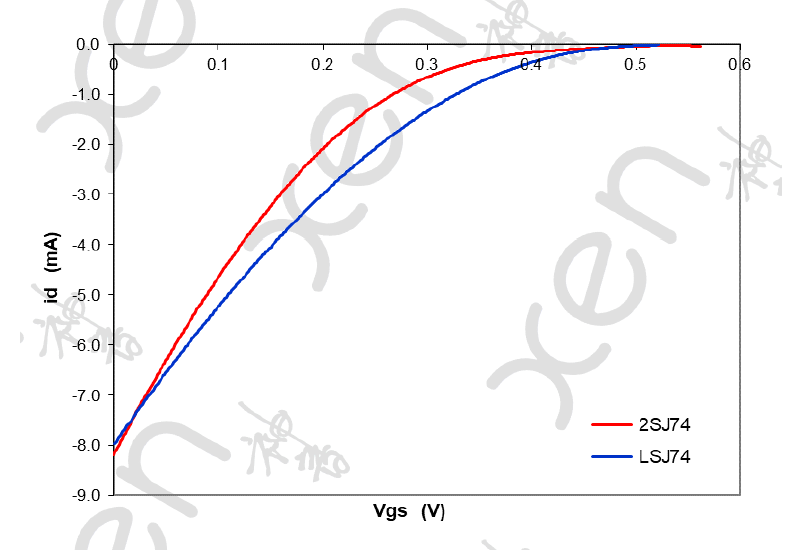

Curve tracing
Two LS JFETs with 8mA Idss were selected, curve traced and compared to the same from Toshiba.
As can be seen, while the LSK170 has essentially identical characteristics as the 2SK170 with the same Idss,
the much lower Yfs of the LSJ74 mentioned above can clearly be observed here again.
Patrick
