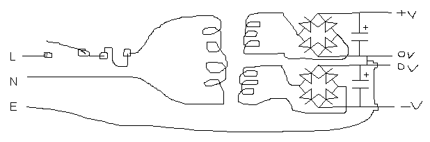

I have build a simple linear power supply, as per the circuit diagram with a +/-25v, 25VA transformer, and 15,000uf capacitors.
This power supply will power my gainclone amplifier. I realise it is underpowered, but my gainclone never draws more than 200ma from the supply, and over 150ma of that is for the cooling fans, so I feel it will be adequate.
The DC is fine, ~+/-35v output, but there is also ~0.5v AC on each output. So my amplifier now has a nice 60Hz tone along with the music. How can I get rid of this voltage?
Sorry about the messy diagram. Everything is connected correctly, even if I have drawn it incorrectly. Both 0v outputs are connected together, to the mains earth, and to the case.

Aside from the diodes drawn backwards..... you can save a FWB by connecting the windings in series. Which reminds me, what is it with these SS guys and their whacked up rectifiers anyway? :xeye: Not to mention the capacitance, a 25VA transformer is what, 1A, maybe 0.5A DC? At 15mF that's more like 300mA...or less! Certainly no more than 200mA with +/-35V output.
And 200mA for a what, 20W amp? Sounds to me like your chip is toast...(have you tested it at full power?) It should have hum immunity built in anyway.

Im not bothered, the current power suppy is a bench supply rated at 1A max and it has never drawn more than 200mA.
I dont know the output of my amp. My sub reached xmax before full power so I havent tested the amp exept into a dummy load. It still hums.

I have re-aranged the wiring so it is less of a mess and now there is ~0.05v AC on each output. The amplifier now hisses.
It never did this with a regualted power supply. :bawling: Im tempted to just buy some ~25v voltage regulators. :dead:
Any help with the hissing?
Ok, solved the problem.
The PSU was fine, one of the opamps in my array of filters had blown. I've replaced the blown chip, and it all works fine now.
