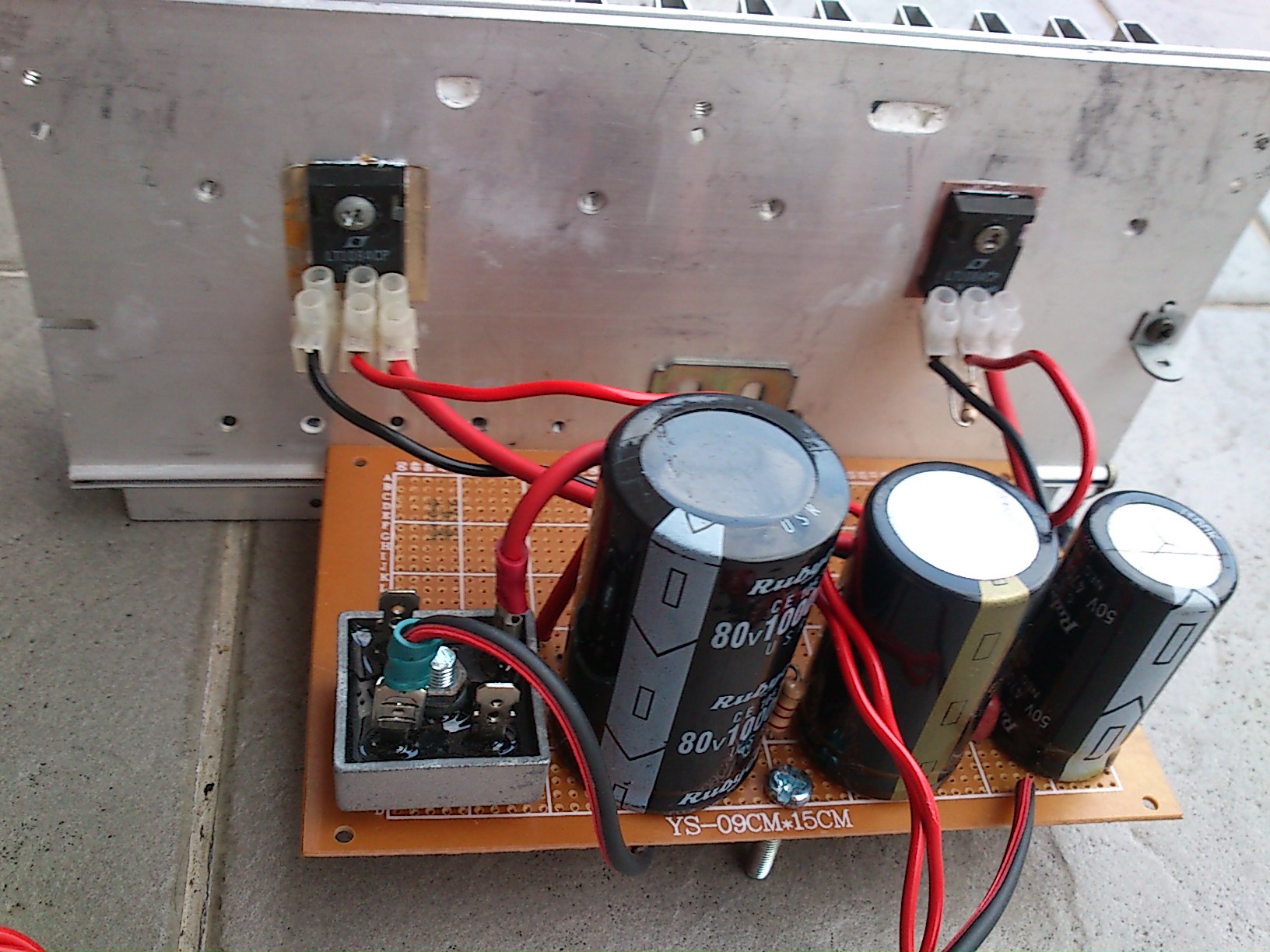

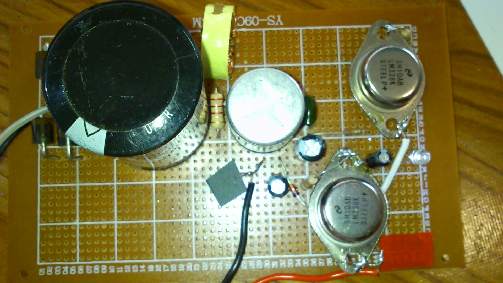

I made this linear power supply based on LM 338 with pretracking regulator and the regulated output is 11.8 V. I use a 10 V zener to reg the output.
The trans is 13.5 V ac out and at least 400W capability and is source from an old medical laser printer.
I made it to power an atom based pc which utilize a 60 W smps.
The reg power supply will not power on the pc .
What are the special requirements to use a linear power supply for pc use ??
pointers are most welcomed.

13.5Vac, with pre-tracking regulator and series regulator !!!!!I made this linear power supply based on LM 338 with pretracking regulator and the regulated output is 11.8 V. I use a 10 V zener to reg the output.
What is the output of the transformer at the smoothing capacitors?
You may find that the regulator drops out when demand goes a little bit higher than just ticking over.
Linear PSU's have one major drawback, for verry good stabilised outputs you have to take into account the minimum possible mains voltage and at that level the psu still has to deliver the needed power, that means higher voltage outputs for the transformer, high current capability and ofcourse much power lost on the series regulator, at hig mains level the PSU will experiance the lowest efficiency and the most power lost on the regulator, all that means you will end up with one big PSU ( real big sometimes ) and much more money spent on it, so that is why swithcers are prefered.

I realise that with the pretracking reg , the Vout do not have enough headroom . I think it requires about 5 to 6 V differnce between the input and output.
I remove the pretracking reg and manage to power the pc for 2 minutes before it went into shutdown because of overheated Lm338 !

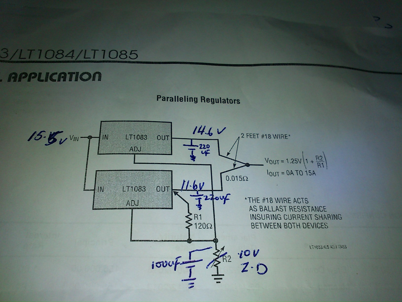

2nd attempt with LT 1084 --success
Hi
I rebuild another module of the power supply for my atom based pc with linux os.
Try it for a few hours and is stable.
Bridge rectifier is the hottest at about 55 C. There is minimal increase in temperature for the 2 LT 1084 .
Those who thinks that power supply for pc audio does not matter should build one to try for themselves.
I will spend the next few days trying to optimize it. I do not have a scope and i seek advice from more experienced diyer. The circuit is from LT 1084 datasheet . The original circuit do not have cap in the output.
I wonder why is there no 120R from V out pin to adjust pins of the top LT 1084.???

what makes you think you have a cleaner ground plane? LDOs, which includes the 1084, generally have pretty crappy transient response and either way what has it got to do with the ground plane? the PC is still covered with little SMPS and the processors are still the same high bandwidth, fast switching, very transient load. all this still dumps into the ground plane, just like before.
