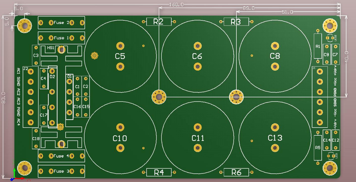

could you post the size of the linear supplies (length-width-heigh)? I am interested by 4x18000uF/71V+2x18000uF/71V.

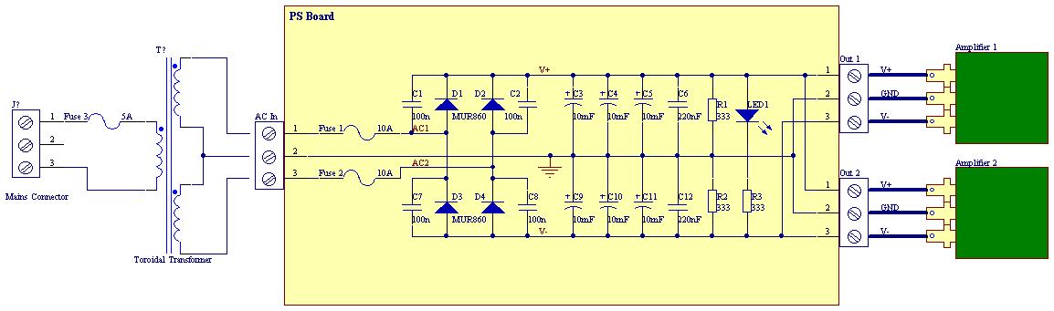

I bought a transfomer that is:
1KVA
Primaries: 115/230V 50/60Hz
Secondaries: 0-16V 1A, 13V-0-13V 1A, x2 40V 12A
What linear supplies would work best with this trafo? Can I hook up two boards? I am pretty new so sorry for such a rookie question.

This type of power supplies Connexelectronic can accommodate 2 differential voltages, one for power stage and one for driver stage. it has 2 separate rectifier bridges and separate GND for each circuit. the capacitors values can be different as well.

The amp boards that I am looking at take +/- 45 to +/-60. So from this trafo can I run 2 of your linear power supplies? If so which ones do you recomend? I'm trying to put together a home theater amp.
Kind Regards,
Robert
Any of the boards suggested before, and the capacitors value and voltage can be chosen from the available ones. for your voltage, need to choose capacitors with working voltage at least 20% higher than the required voltage. capacitance, as big as you can afford, if you will use a soft-start circuits along with the supply boards and transformer, to limit the inrush current.

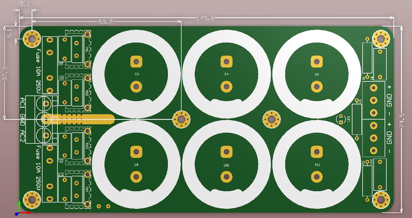

What is the height of the capacitors used on the Power Supply 6x15000uF 63V ([PS15K63]) board?

Boris,
i uploaded the schematic and pcb view at this section: Connexelectronic this is the direct link to the file: http://www.connexelectronic.com/documents/PS10K80.pdf
I also clean-up the products list at the Linear Power supply section, and instead of 10+ products which are basically two boards with different capacitors, now are just two boards and the capacitors can be selected from the drop-down menu. Only the capacitors which are on stock right now were added, some others which were available before i removed from the list due to insufficient stock and limited supply with long waiting time and very large price fluctuation. if any other value than the ones listed are needed, don't hesitate to contact me for availability and price.
