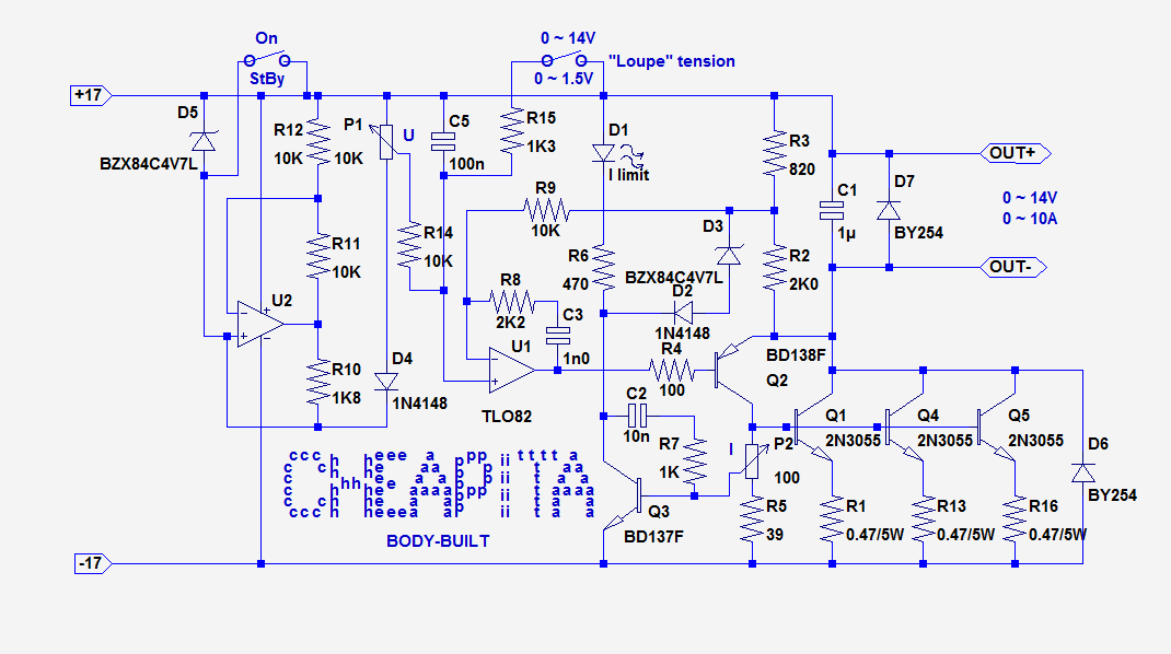

Of course there is the dirt DIY approach:
12V 10A Power Supply | Circuit Diagram

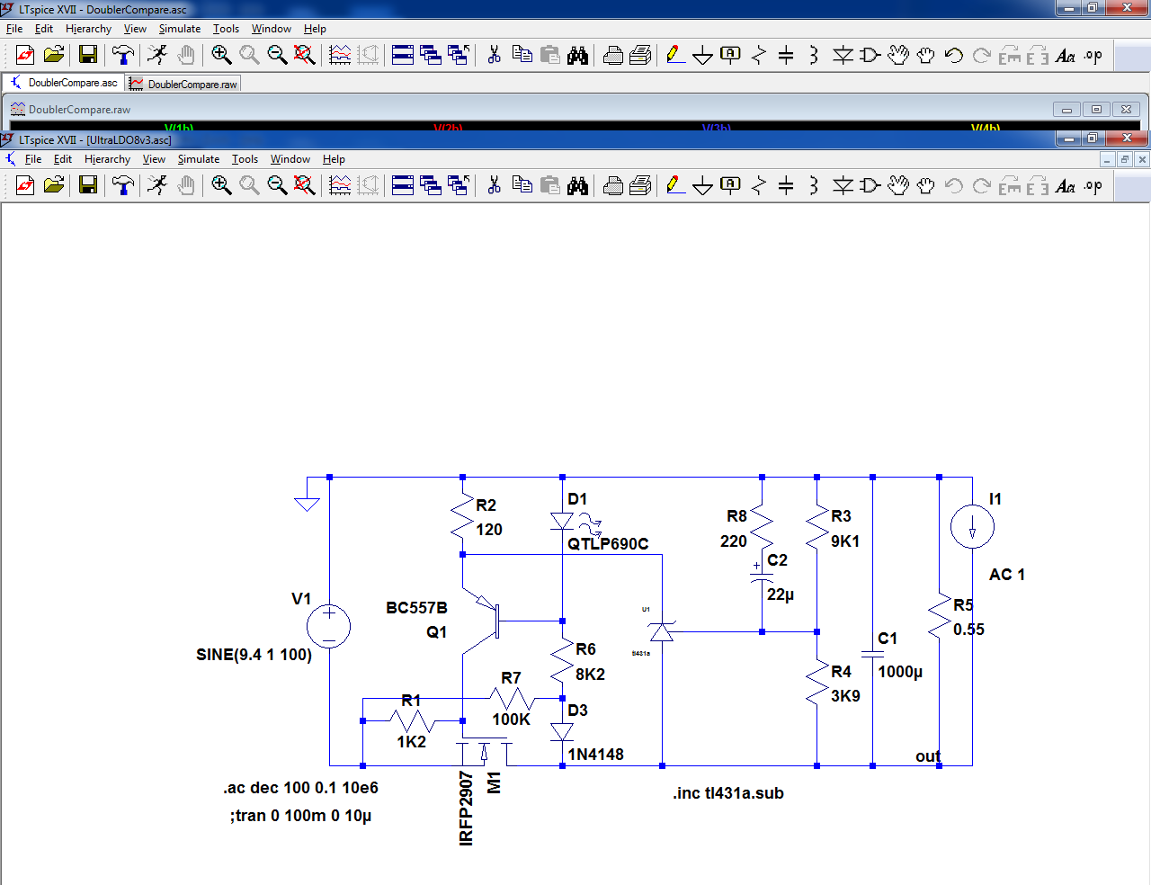

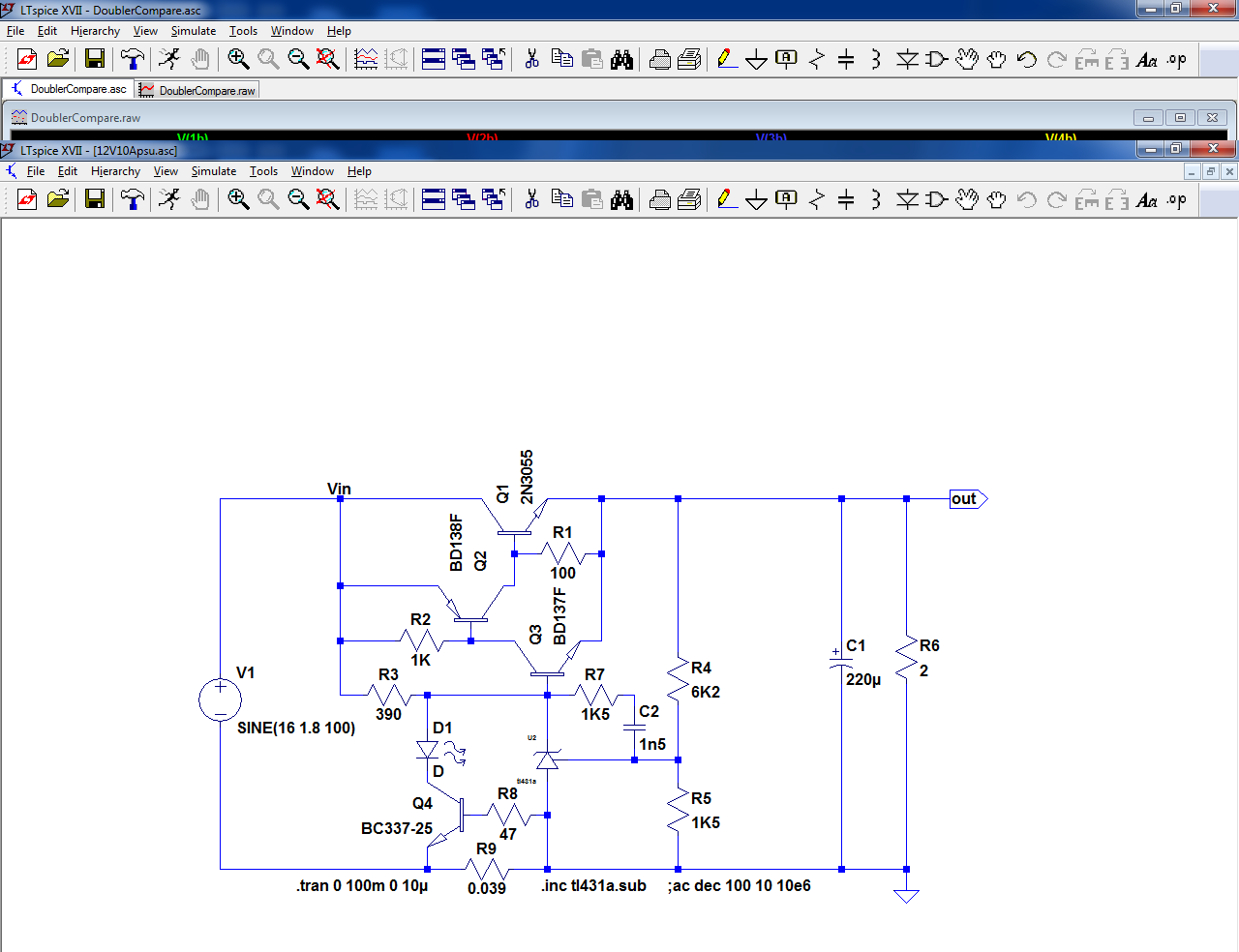

There are thousands of examples on the net, but some aren't really optimal, you need to chose carefully.
I have built a number of my own, I am not sure I can locate all of them but here are an example or two.
This one is based on a TL431 as a reference, and has a current limitation (you can remove it if you wish). A single 2N3055 is shown, but for 10A 2 or 3 is a minimum (with 0.1 ohm balancing resistors):
This is a LDO, negative regulator (it does not matter if the source is floating).
It has a 8.3V output, because I adapted it for a forum member (it was built successfully), but the output voltage can be changed to 12V by altering the ratio of R3 to R4.
I have also built more conventional types, based on a traditional zener, but I don't see them in my files. I need to look more carefully
