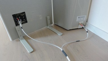

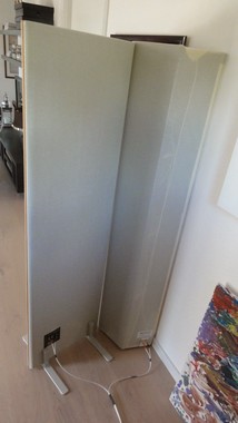

Then I designed a line source dipole subwoofer:
4 x Peerless SLS 400 – 830867 pr side. And I used the sidewalls for the outside baffle – see picture:
To get the same finish as the Magnepan 1.7 I orderd two “Socks” directly from Magnepan – great service and in a week I receive them here in Denmark !
More pictures:

And here comes the measurements of the subwoofer alone:
All measurements are made from my listen place with a window on 60msec and smoothing = 1/N=5
A: Blue Left, B: Red Right without crossover & eq
A: Blue Left without crossover+eq, B: Red with crossover: 75 hz-48db/octave + par eq at 20hz, 80hz & 165hz and hishelf from 90hz - yes many function on my Lyngdorf
Difference on left and right
Hello ,
Nice work , i love the look and being that close to the side walls will help the bass , but i cannot see it not affecting the sound of the 1.7's ....
why not seperate them ......

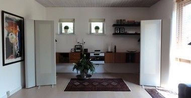

Space neded ! If I had another room = Wider then ...
But I will try to put the Maggie with the tweeter outside and about 10cm from the subwoofer.
Sorry I may be missing something here but what is the point in this?
Considering that the bass coming from your subwoofers is omnidirectional (Definitly true for 80hz down but the effect starts at arround 150hz)
The only directional tone you will be able to hear from them is the harmonic distortion.
I have now placed the Maggies with a little space = 10cm from the subtowers and at the same time switched them L/R - so the Maggies now plays with the tweeters outside. Very interesting is now that the roomresonance I had before in the lower mids are almost gone so male voices are now more clear !
