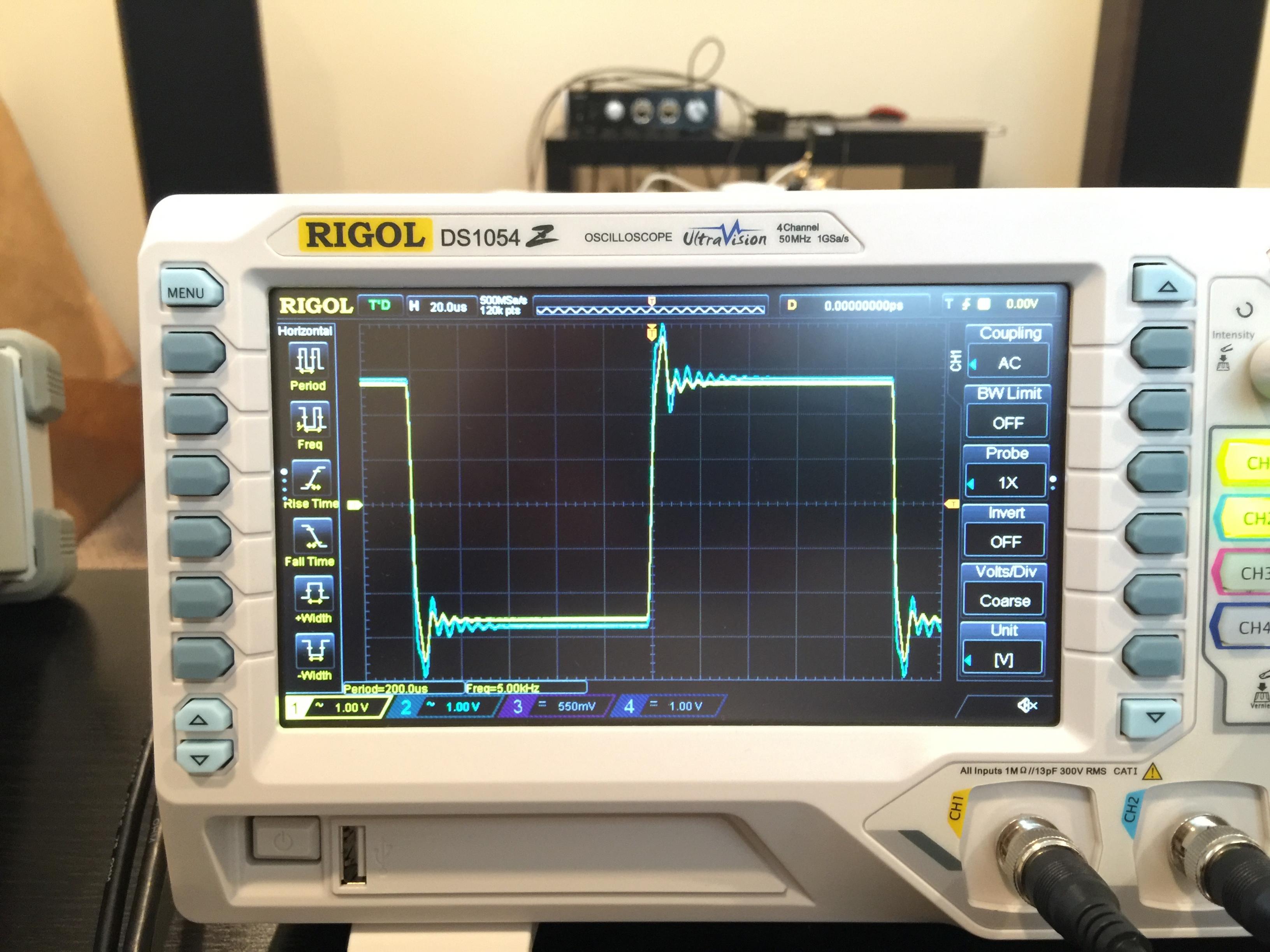

In addition to the hum the amp also exhibits very pronounced output transformer high frequency oscillations -- a square wave overshoots by 26%!! Please see the attached picture.
It appears I bought a bad amplifier. 🙁
