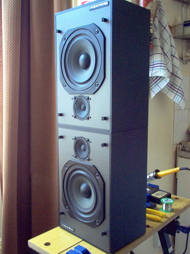

Since these speakers are cheap as chips at $100 a pair, I see no reason why you can't buy a second pair and wire them in series for 16 ohms. But 4 or 8 might be getting silly.
Makes a cheapie MTTM. You gain loudness and authority on axis. Multiple driver's power falls off more slowly with distance, which is why they are used in PA systems.
You can try mono right now.

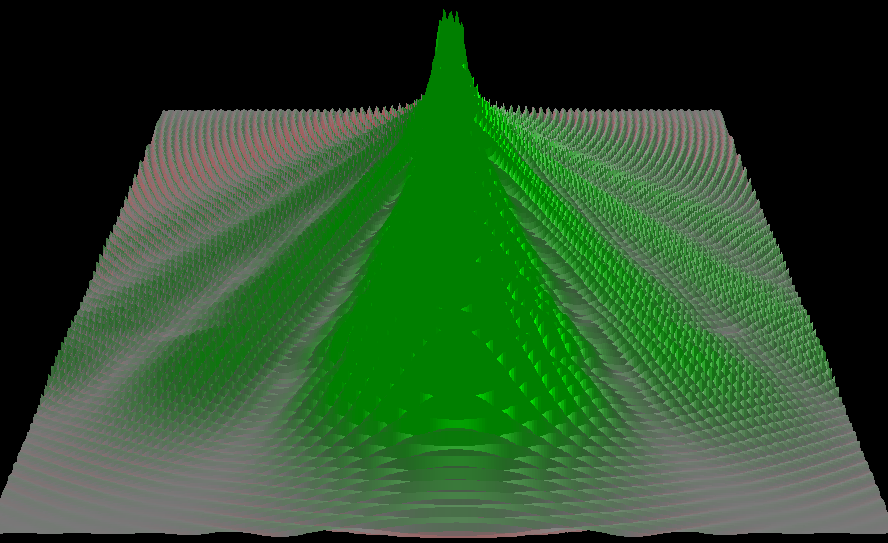

I went into this looking for a sign of widening directivity at some point but it appears to be persistent with distance (plane source a few wavelengths across). Directivity appears to be related to the interference pattern with some of the power being lost in the 'crossfire'.

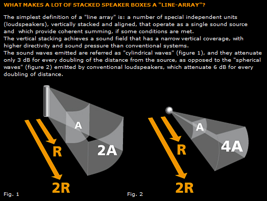

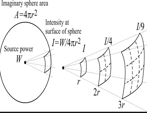

I always like the mathematics in these sort of situations.
Something about line arrays which I quote in the pictures:
INTRODUZIONE AI SISTEMI "LINE-ARRAY" - Palcoplus - professional array system

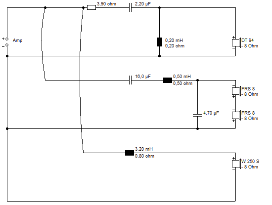

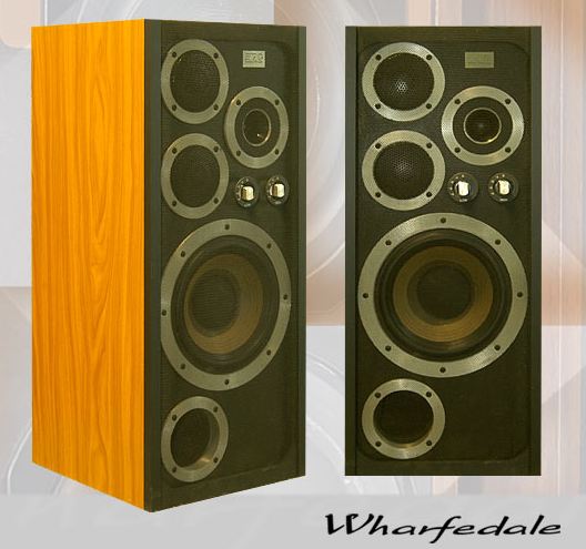

Whatever you think of combing, on the horizontal axis there is none. When you double up drivers in an MTTM you are only using half the amplifier power for the same sound level. This must help distortion for one thing, since each driver is only outputting a quarter of the power.
MT has a problem in delivering sound across a room. You've experienced this. Get close to a spherical falloff MT type two way up on the nightclub ceiling and it blasts your ears most unpleasantly.
MTM has a problem too. The tweeter falls off at inverse square, but the twin woofers or mids at inverse distance. I like the MTTM idea, but a certain subtlety in using wider dispersion BW3 filters which is for the real enthusiasts.

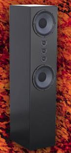

How about MTTTM? This is interesting. The Tekton Pendragon uses it. Philips came up with the idea that three stacked drivers should be connected in a 1:2:1 binomial voltage level to lessen vertical combing. Or 1:3:3:1 with 4 drivers. I don't know what Tekton actually do here.
Anyway, lots to think about. It's fun. 🙂

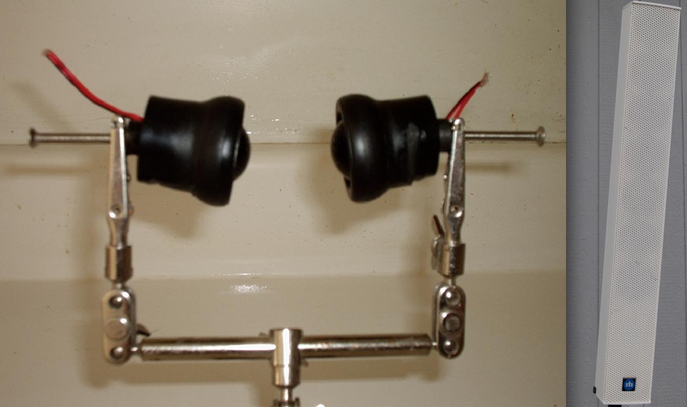

And I have the results pictured below of what happens to the center tweeters when shading is applied at higher power levels 😉.
The two "mushroom meltdowns" are from a pair of Renkus Heinz ICX7 mini line arrays, the outer pair of (7) tweeters receive -10 dB (1/10th) the power of the center tweeter which is (was) effectively doing most of the
"tweeting".
Before burning out, the center tweeter's voice coils got hot enough to deform the plastic pole piece extending through the woofer voice coil former, which then started rubbing on the pole piece, alerting me to the problem.
Art
