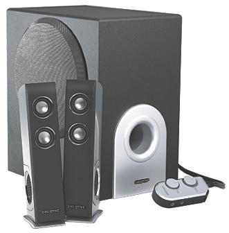

Scott_jcp,
There are some 1 inch wide range speakers that are often used in small computer speakers. Madisound carries them and they are quite good sounding and have a wider frequency range than typical tweeters. There is almost no flange so they can be mounted very close together. I think about 10 USD each. These would work very well for a line array I think.
Here is picture of a computer speaker ny Creative that uses them.
Hezz
Hezz
