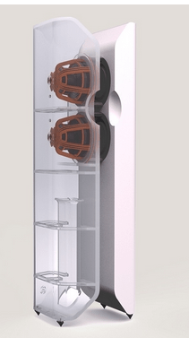

Then to my surprise Monitor Audio did something very close with a concept speaker. The full speaker is a 3-way with separate mid/treble section but look at how they do the bass section. The two towers below are part of a single speaker:

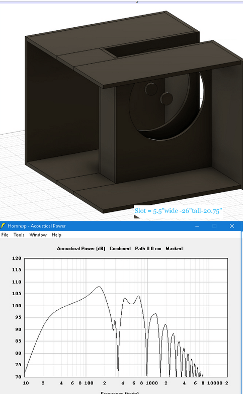

Eric,Assuming the drivers could get to 20kHz on axis, what are the physics of the response when loaded essentially by a slot, as seen above?? Am I even going to get any treble at all? Is this essentially a very short horn?
The slot will create an acoustical band pass filter, reducing upper response, while causing narrow "Q" peaks and dips in the frequency response, the spacing and depth depending on the "very short horn" dimensions and it's enclosed volume.
Here is an example of a slot 5.5" wide by 26" tall with 20.75" depth.
The peaks and dips would move up by ~an octave for each halving of dimensions.
The response simulated above is "kinda OK" for a subwoofer, but the frequencies that would "beam" with a 4" driver may be rendered useless by the slot.
The slot's acoustical band pass filter would reduce some high order harmonic distortion when the drivers are driven past Xmax, but won't reduce doppler/IM/AM distortion.

The Monitor Audio is more of an insideout push-push box with both woofers in a single basket., and only the woofers. They had to do something different han KEF's.

From the transparent image above, the hole at the base suggest there are 2 reflex boxes working as one.

Yes, you read the MA diagram correctly. Just imagine two woofers each in their own enclosure (ported in this case, but not relevant) pointing at each other.
