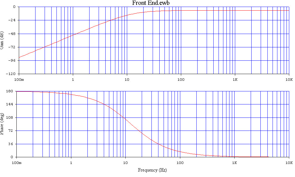

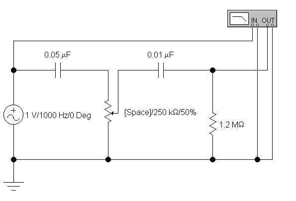

A first approximation would be something like this where C3 and C4 are used to limit low frequency response. Initially the slope is second order but the cathode bypass cap shelves so the ultimate slope is not that great. I think an argument could be made that it could be worth the trouble to implement a higher order filter.
By decreasing the coupling cap to the driver also (making C4 and C1 .027uf) we get -3dB at 40Hz and -10dB at 17Hz which may be adequate. anything further would seem to beg for a separate active filter stage.
