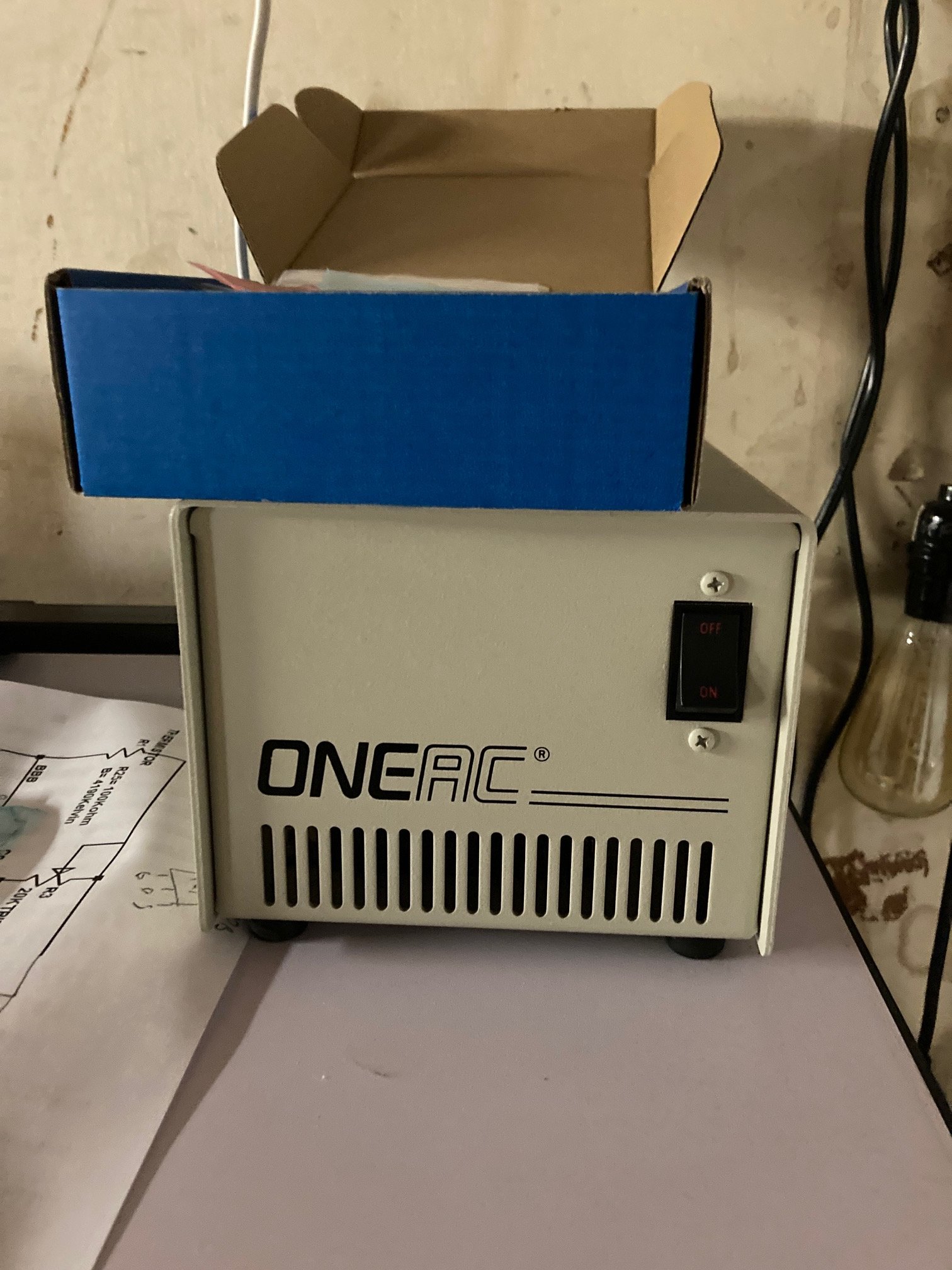

Maybe try an isolation transformer between the variac and the wall, you know the 1:1 things that are used for power conditioning? That way there's two cores that need energizing.
