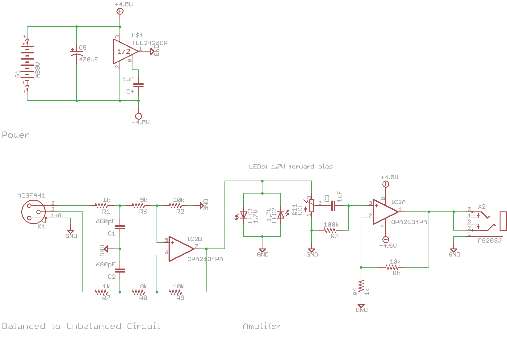

Sorry to resurrect and old thread, but I'm trying to build something similar into a headphone amp to function as an in-ear stage monitor solution (IEM). Where I am getting stuck is where the limiter should go. The docs on Headwize have it after the volume pot or even after the op-amp depending on which article I'm looking at.
But if I want a hard limiter to protect me from things like feedback or dropped mics, shouldn't the limiter go before the volume pot? Then I can tune it to the expected nominal levels from my mixer so that the limiter kicks in if that source is too loud (regardless of my headphone volume).
Another potential issue is tying the output to L and R as the input will be mono. If I understand impedance correctly, that means I'll halve the impedance (to about 12 ohms for the in ears I plan on using). I'm using a TLE2426 so as long as I don't exceed it's power rating, I should be good there. Anything else I should be mindful of when splitting the output?
You must first define what you want it to do.
1) do you want to protect your earphones from destruction and you from deafness?
Meaning it will never act except on accidents?
Then limit *after* the volume pot, or at the power amp itself.
2) do you want to set a limit level which will be reached often, and then set said level to some user adjustable comfortable volume?
Then limit before the volume control, as you show in this schematic, but in that case I warn you that you need to add some resistor (say, 1K to 4K7) between the first Op Amp output and those clipping diodes.
Personally I'd go for option #1, but of course it's your choice.

Doh you're right I am missing the resistor 4k7 resistor. That was by mistake, although it's function is a bit unclear to me. In circuit simulations, it seems needed - just not sure why? Is it for impedance matching or?
Indeed the purpose is to protect against ear damaging noises and deafness. With regards to #1, that basically means there is a maximum volume attainable before limiting, yes? That means I have to calibrate the limiter to both my headphones, sensible dBu, and my listening preferences? I guess that's probably more wise - I was just worried if I set the limiting too low and needed more volume, say, in an actual show, but have no way to fix it (I was going to make the limit adjustments internal so they don't get accidentally bumped or otherwise changed)? I suppose that is where some sort of headphone measurement system would be helpful. I've got an o-scope but that's about it.
In Headwize's schematic for a post amp limiter, I noticed the trimpot output is hooked up in a feedback sort of things instead of from the input to ground which I found odd. In searching around, I didn't find a good explanation of why that is the case, though I assume it's because we're tuning an already amplified signal and connecting a pot normally might cause too much current to flow to ground?
My thought with #2 was to calibrate it so that normal audio is right before limiting. So anything that wasn't desired is limited and, with a hard limiter, also rather obvious. In that way, it's still generally safe against mic drops, but, to your point, doesn't prevent me from turning up the volume past safe limits for normal audio. At least I assume that was your concern?
I suppose I could technically do both - set an absolute protection limiter after the amp and a configurable limiter before? I could even make the first limiter a soft limiter too (though that would likely demand some sort of indicator so I know when I'm hitting the soft clip).
Hi didi!
I ended up just using a standard 4-channle rackmount gate/comp/limiter going to each of our three IEMs. I would still like a circuit I designed, but I've otherwise been fairly happy with the solution.
