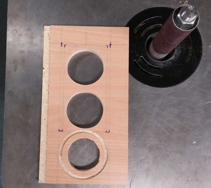

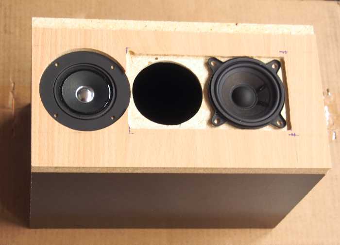

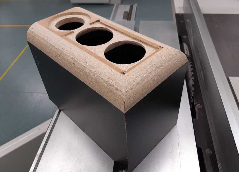

Yes, wide pattern. Tweeter would be at 79 cm height, midranges above it. This part is rounded edges (sides and top). 9 cm straight baffle and total width 16cm. So radius of roundings is 3,5 cm.

I am prepared to make experiments with foam and felt to adjust tweeter directivity. Mid-high protobox is almost ready.
