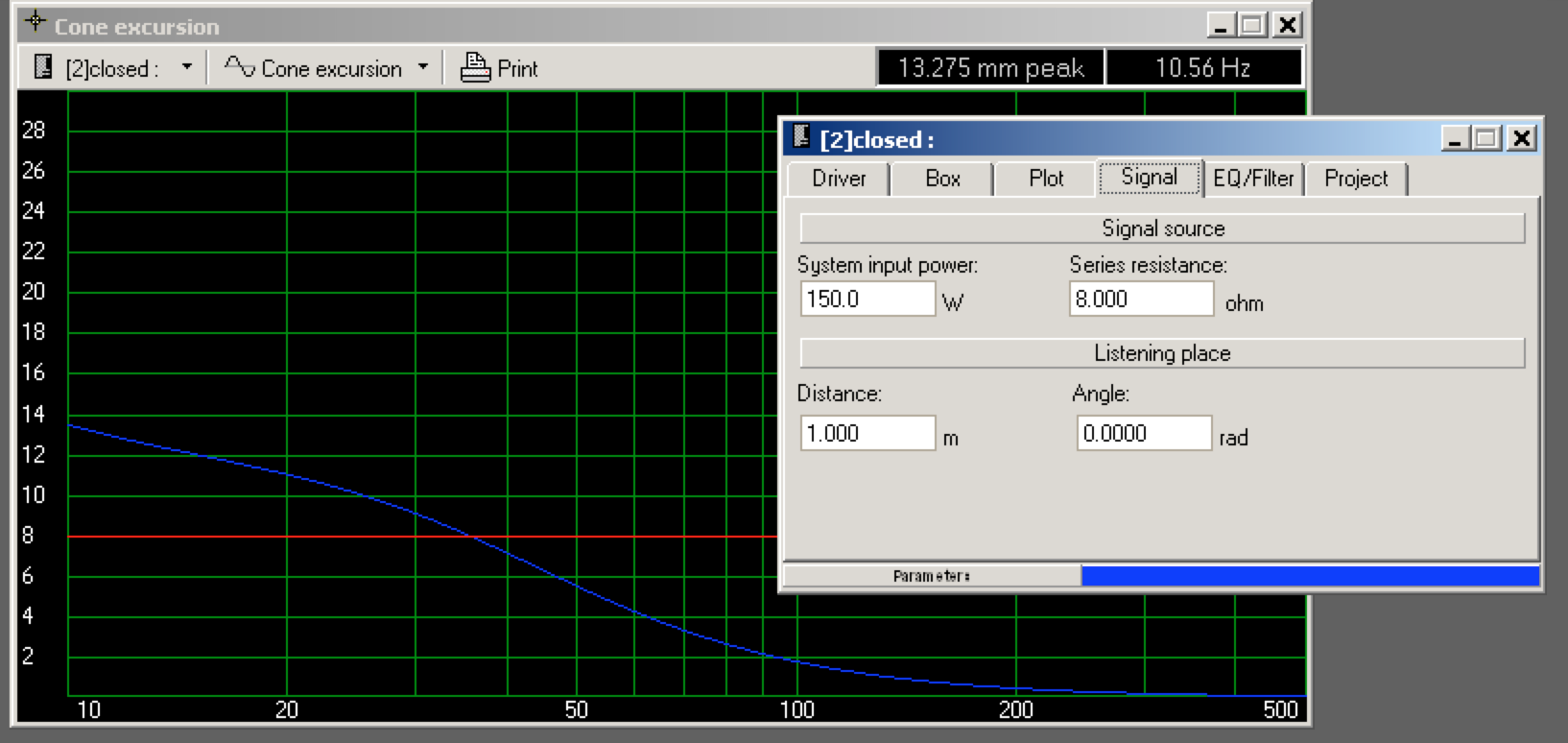

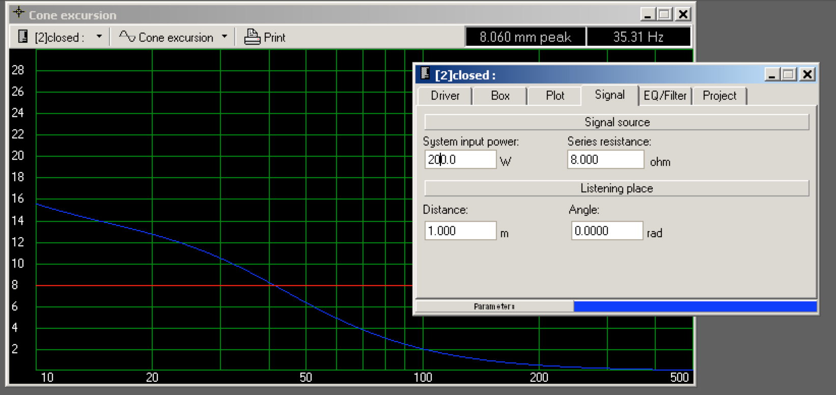

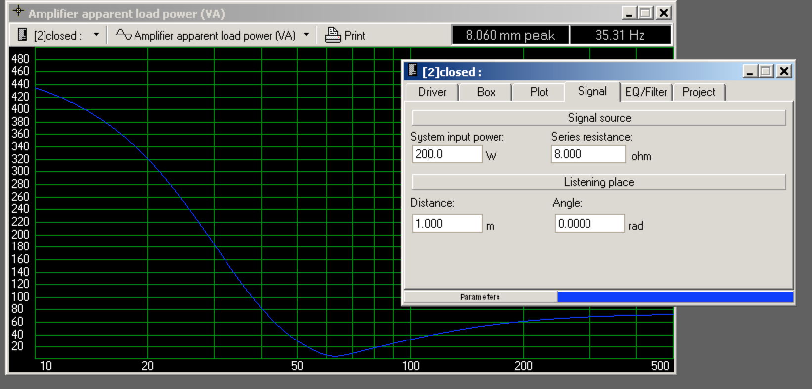

After looking at the apparent load graph this is all starting to make a lot more sense to me.

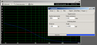

I have included a graph of apparent load of 200w at nominal power for the 100l box. It looks like I would need to increase box size significantly though (to about 250-300l) before getting a significant improvement in efficiency. To me it looks like the ICE125 module should be just about enough to power this driver but it may be worth upgrading to the ICE250 to give me some overhead.
I have also attached a cone excursion graph for 200w and 150w. I think I should be safe as long as I cut off frequencies below 20Hz. If nominal power is kept below 150w the driver can go to 35Hz without exceeding Xmax.

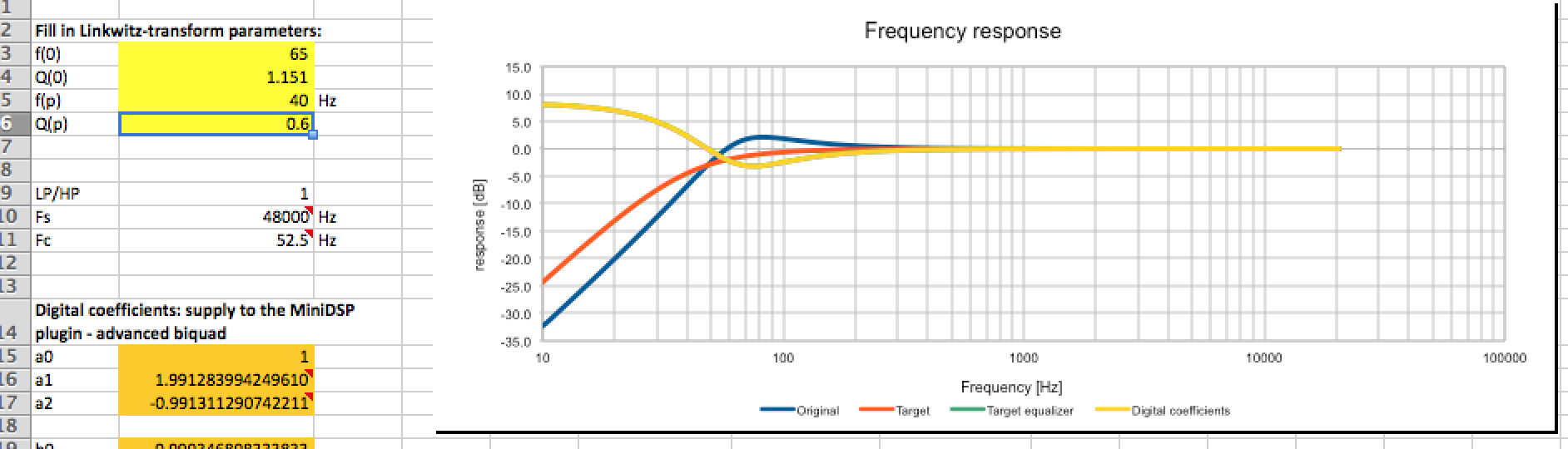

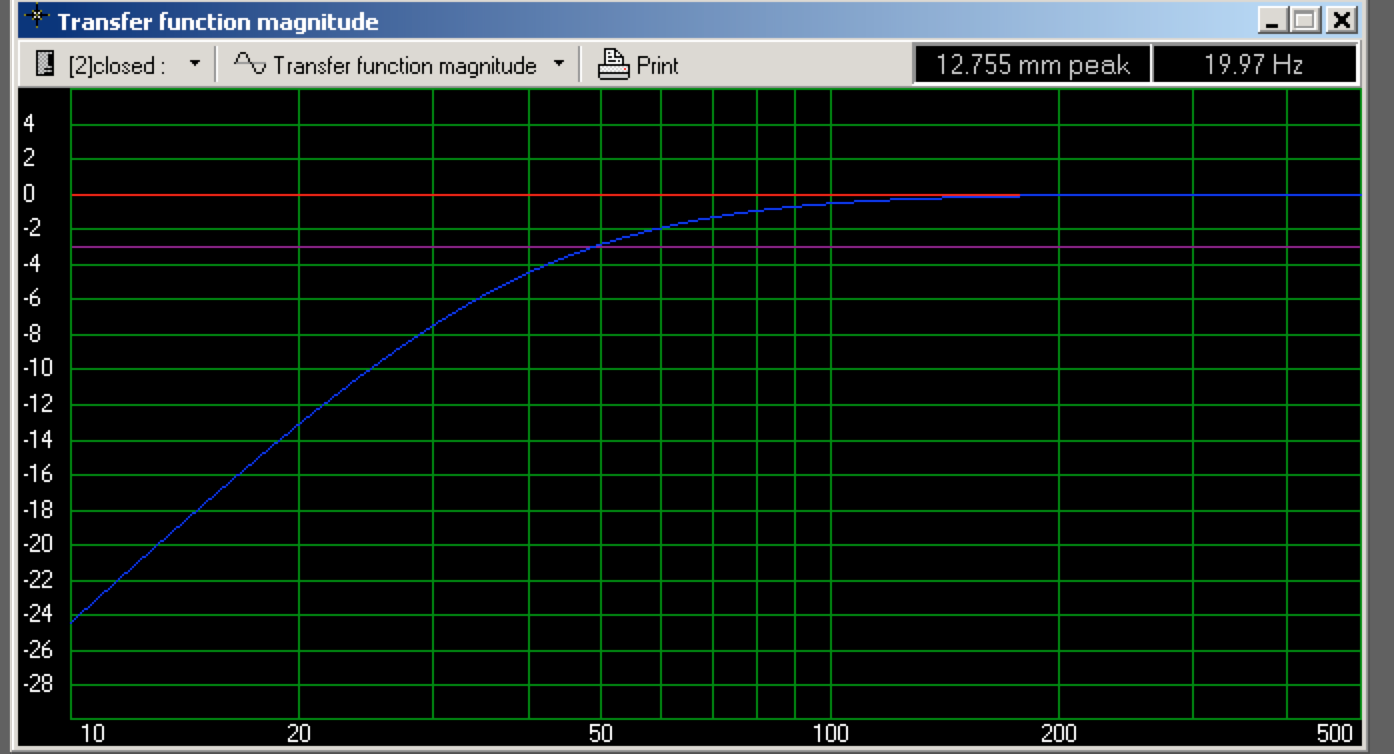

I have also included the transfer function. Let me know what you think
Neither matter much . . . the graphs which tell all are SPL and Cone Excursion.
Looking at those while adjusting the signal and equalization parameters is where you will find understanding. For use as a subwoofer you will see much better results with that driver in a ported box (but it will be big).

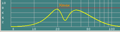

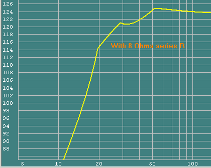

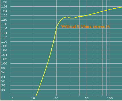

Hi, what made you choose that driver ?

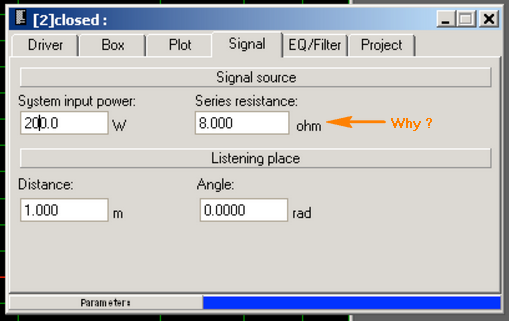

Why have you input 8 Ohms series resistance ? I guess it's a mistake.
You haven't mentioned a required LPF for the sub !
If you "must" use this driver, & in a box no bigger than 150L, i would design it as a Bass Reflex, see my screenies 😉

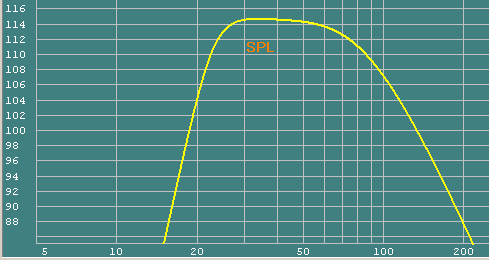

Think you are right about that the SPL graph for the PD driver does not look very good.

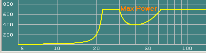

To be honest I chose this driver because I was trying to built a smaller version of the 21 inch sub project I posted a link to earlier. That sub is also built around a Precision Devices driver plus everything I've heard about their products is positive.
Yes, the 8 Ohms series resistance was a mistake. Should have kept it at 0.1.
As for the LPF I can do that digitally with the miniDSP
Fair enough
Well it makes a BIG difference to everything, & means ALL your sims are wrong ! See my screenies for only one difference
Sure, but if you don't sim with All filters in place, you won't get a true indication of the end result.
Try simming again with the above measures in place 😉
