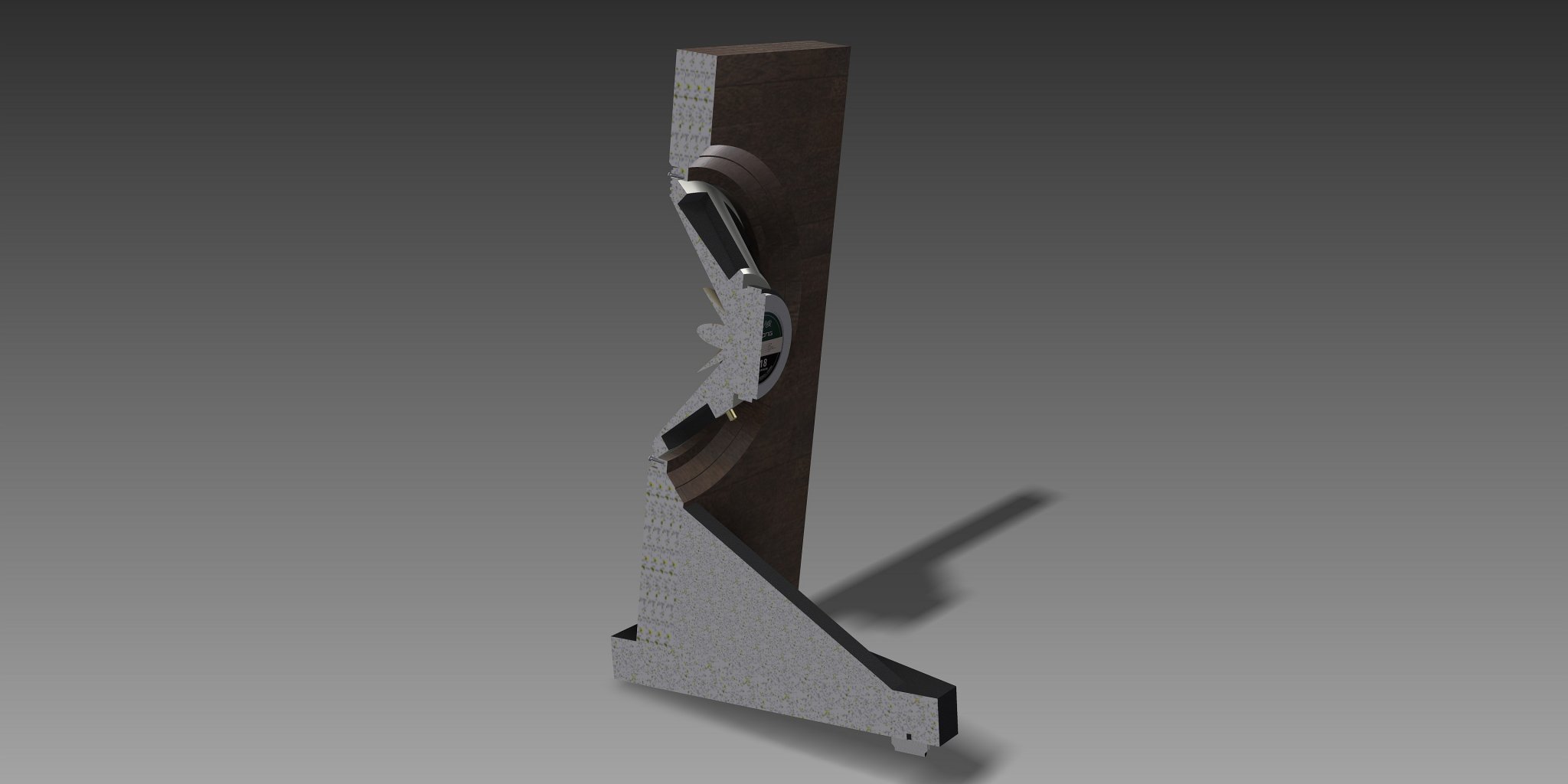

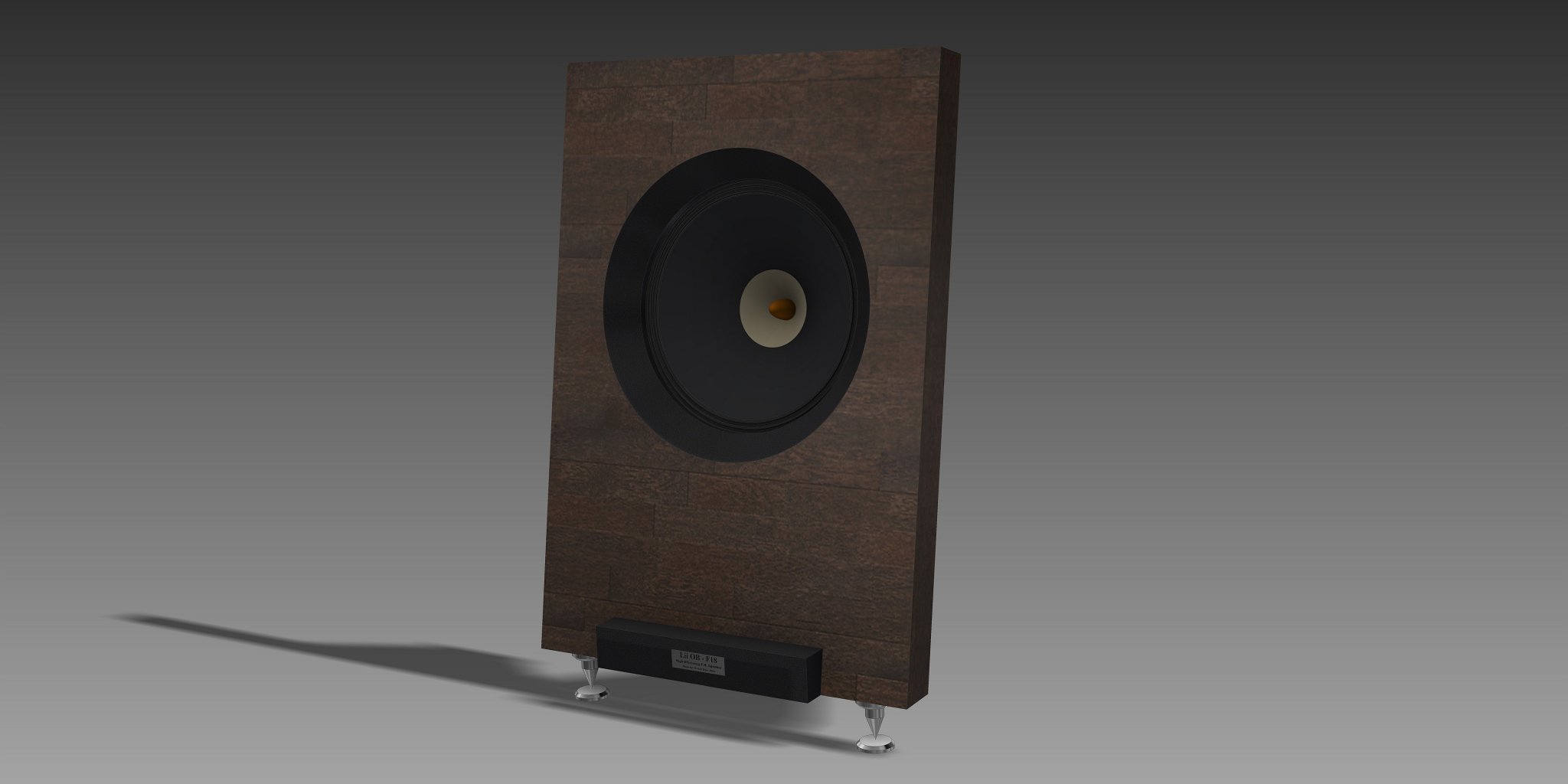

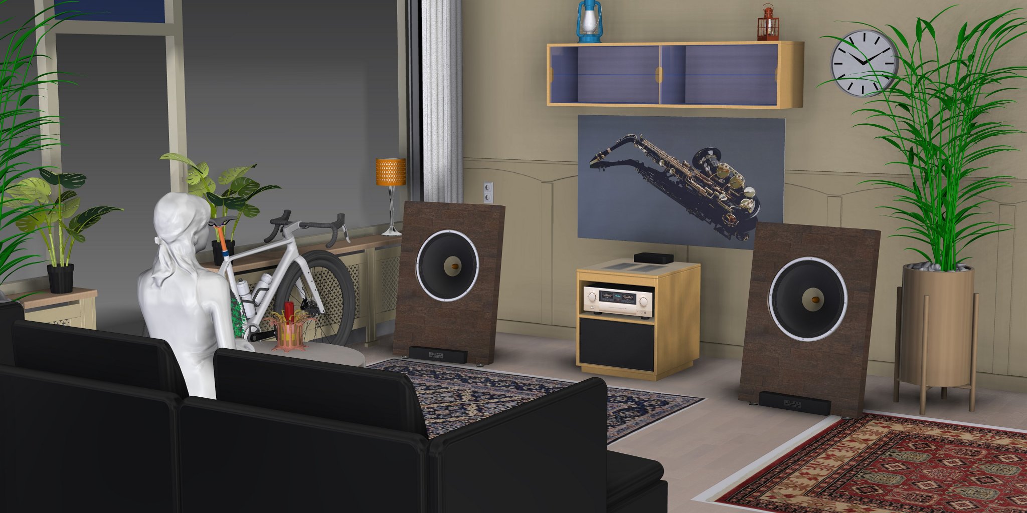

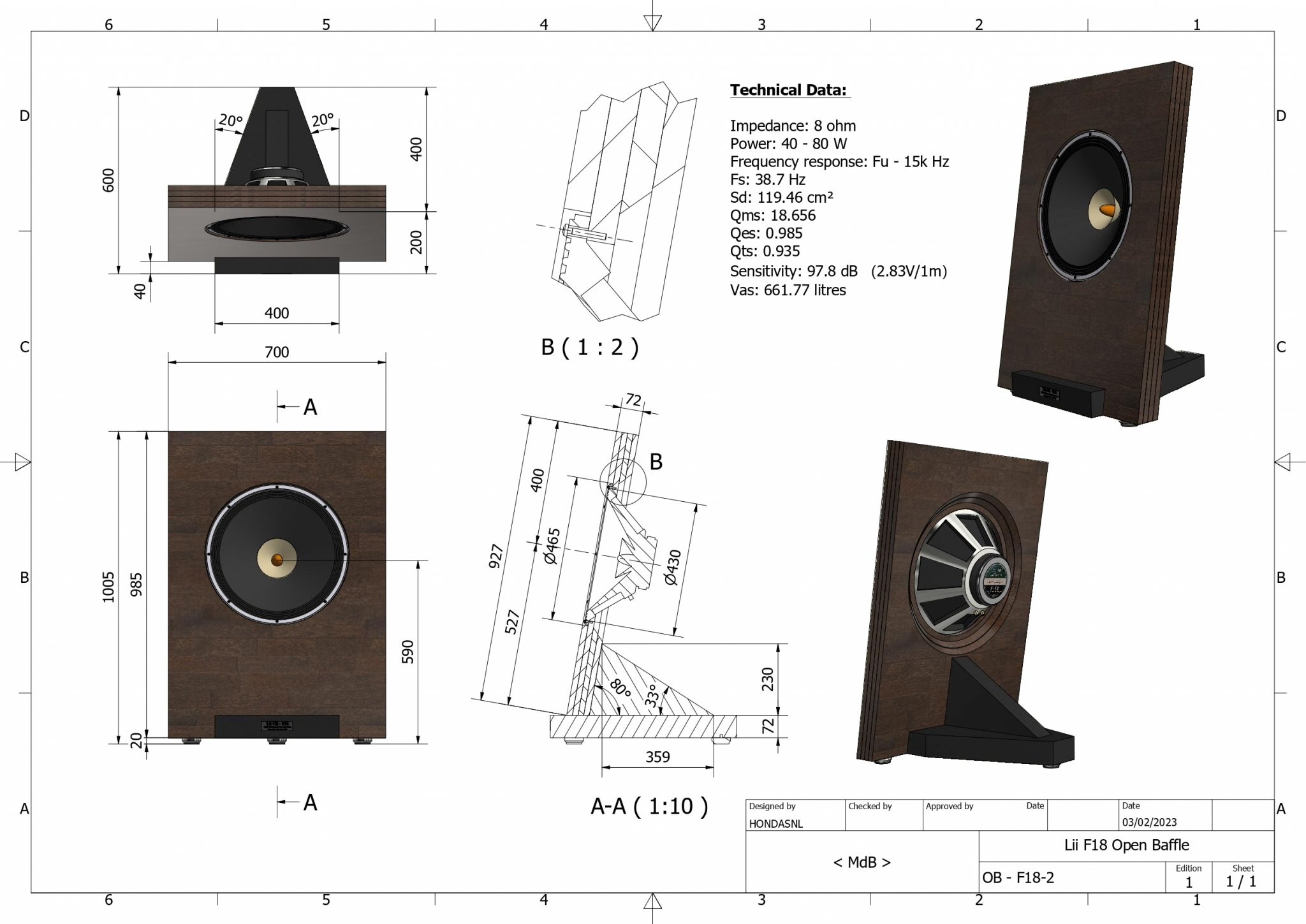

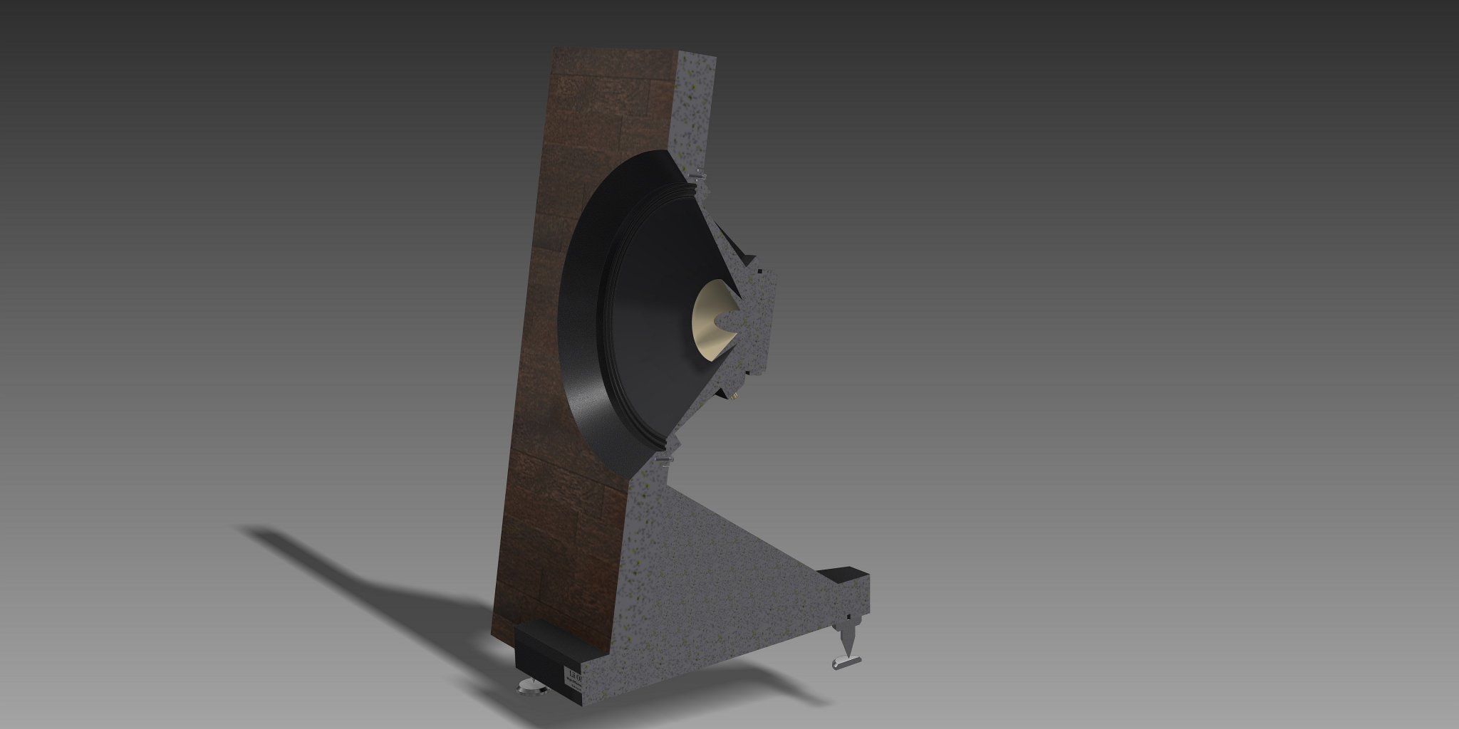

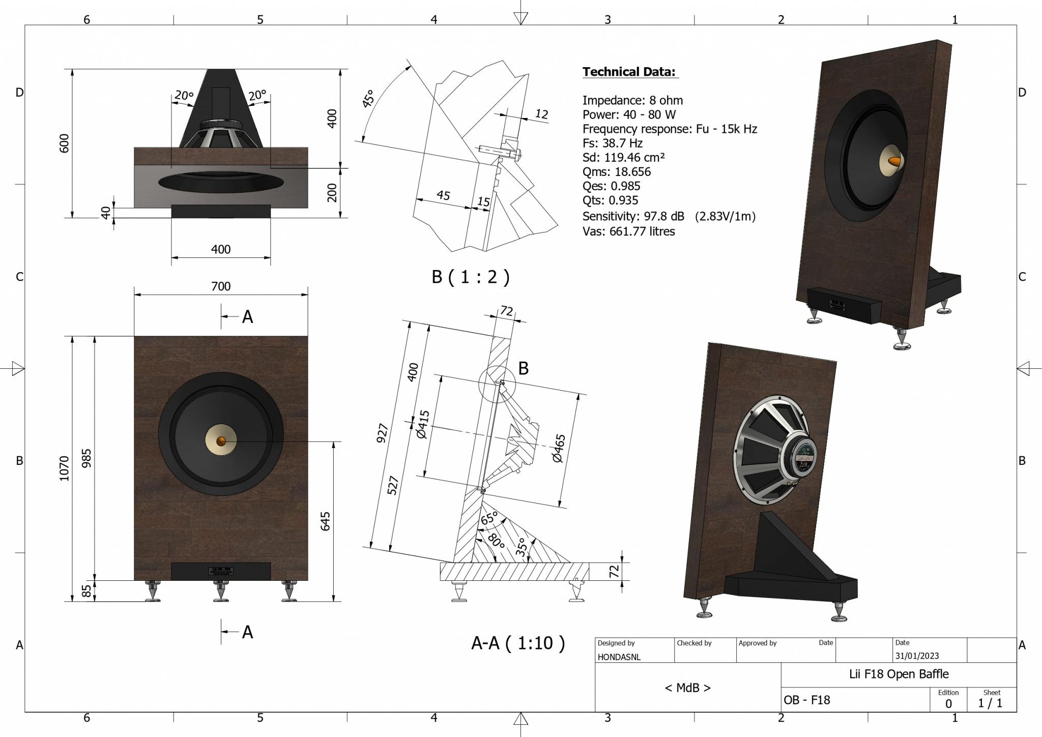

Maybe in the futere I like to built some open baffles for my Lii F18 that I already have.
A sleek, simple, heavy and robust design for the very beautiful 18-inch full range driver of Lii.
Lii's biggest driver that they deliver at the moment I believe.
Consruction made of 4-layer 18mm solid MDF (glued togehter), total panel thickness is approx. 72mm in total.
Finished in desired veneer type and/or paint color combination.
The whole is glued together and placed on 3 robust and stable spikes.

The short waveguide created by rear mounting will alter the frequency response. Maybe negative, maybe positive but worth testing the impact before committing to a final build.

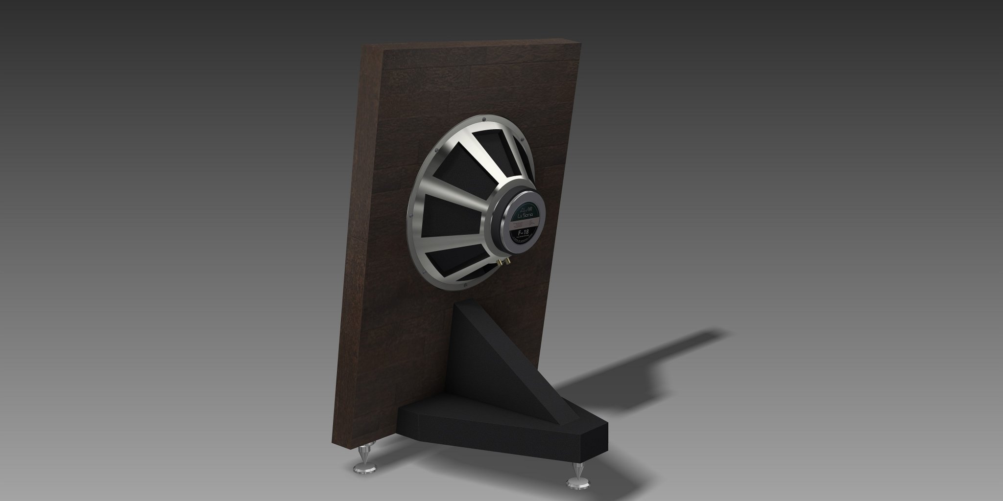

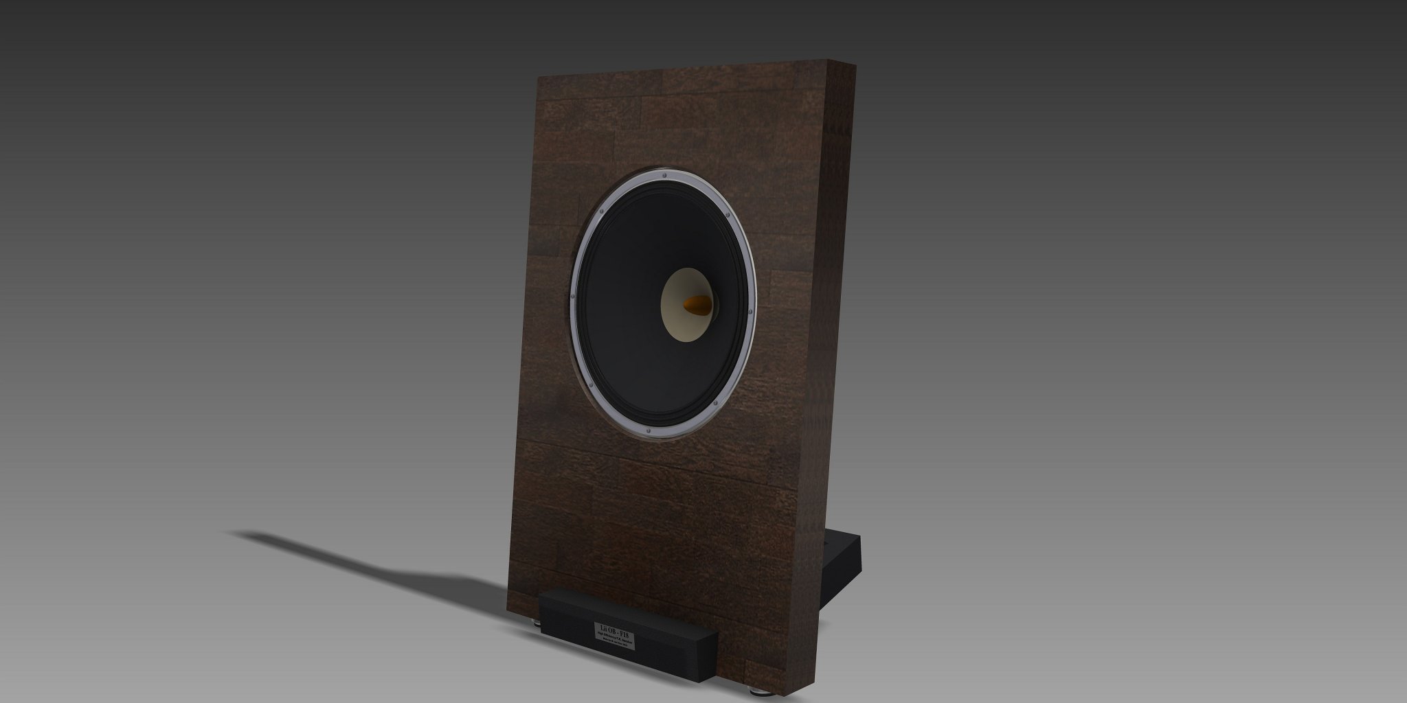

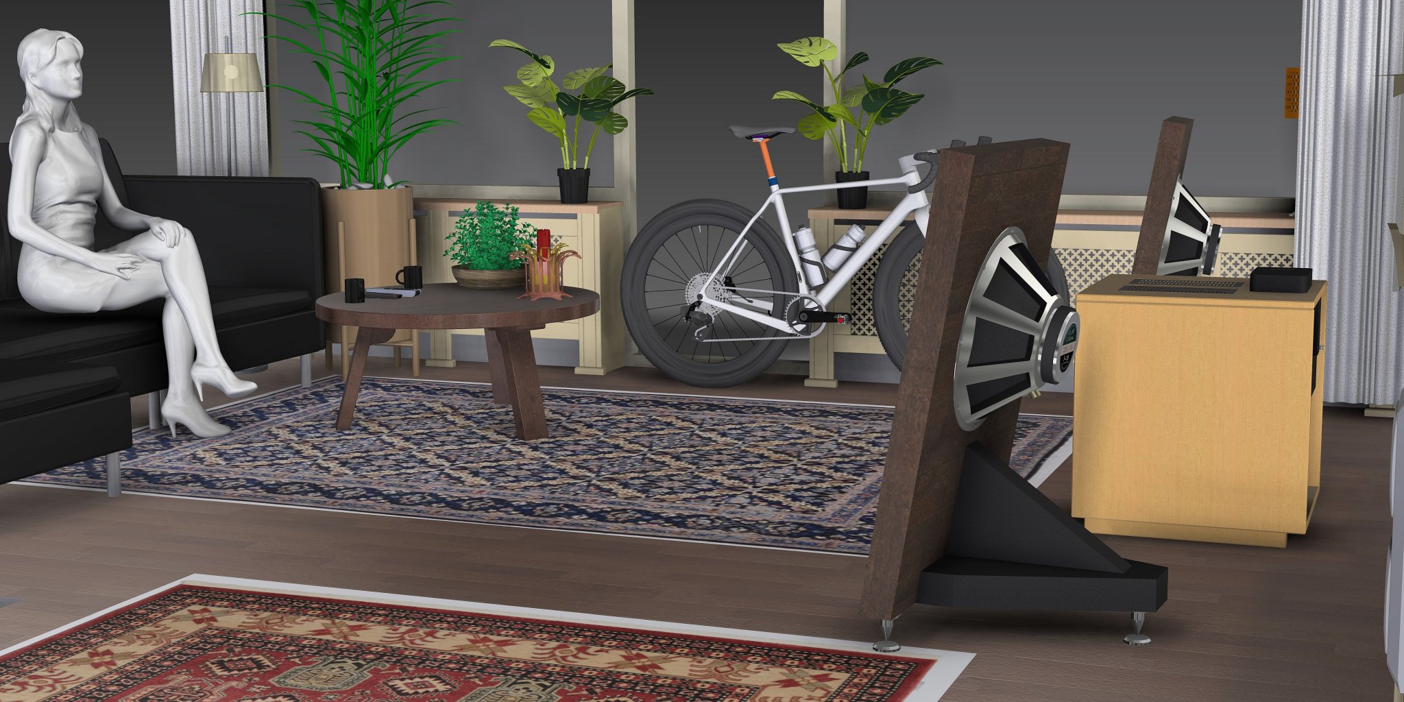

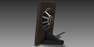

Hello friends. Hereby revised Concept without the spikes and position the driver at the frontside of the baffle.

Indeed + if setting perpendicular it halves the needed baffle area, lowering gain BW ~0.707x.You'd probably get better bass by removing the spikes and placing the baffle on the floor
Is there any reason to tip back a FR speaker? I always thought stands that did that for planar mounted 2 and 3 ways pulled the tweeter backward in time - some - making the speaker a bit more phase-aligned and sounding a bit better.if setting perpendicular
It won't help with time alignment, you add an outboard tweeter somewhere just north of the horizontal to right for right speaker and vice versa and find the best overall baffle left/right offset; tilting back would be for changing polar response, room modes interaction and if wanting to 'fan' the sound, setting the driver on the baffle at floor level and tilt forward to create a 'V' slot mirror image.
Fun to experiment/learn with, but all are ~'head in vice' options when done with 'FR' drivers.
A driver that size will be very directional from the midrange up. Without the tilt highs will be maximised toward seated calves. Since the planned baffle is so small anyway playing the raw drivers on ground at different angles to get a sense of the trade offs before committing is an option.tilting back would be for changing polar response

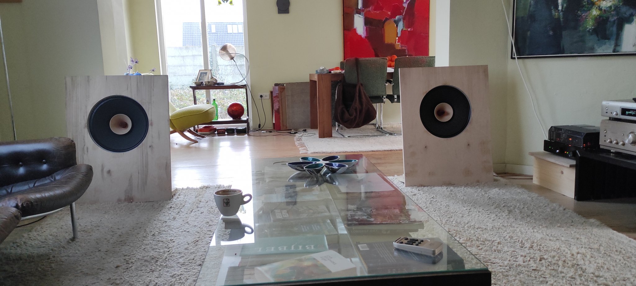

Looks great.Have to make final baffles for my f15's also.Have made temporary ones to see if I like them.I like them a lot!.
How do the 18' s sound compared to the 15's?
I've been a Magnepan listener for 10 years and like the smaller baffles compared to my maggies.
Very nice and clean looking setup Alffie!!Looks great.Have to make final baffles for my f15's also.Have made temporary ones to see if I like them.I like them a lot!.
