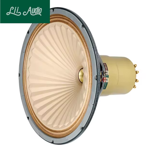

As some of us quickly learned from this thread that Lii Audio (established in 2006) is not Lii Song (established in 2019) now it's easy to define the original manufacturer by a line of brand new Coaxial Drivers.
As a fan boy of Tannoy I'm glad the Lii Audio (not Lii Song) is now making not only full-range, but new BIG Coaxial Drivers.
In this thread I want to discuss their new line, please do not post here about Lii Song as they have been separated from each other due to war between two ex partners. This is why you will not find coax drivers in the Lii Song catalog.
I hope Lii Audio will continue manufacturing unique drivers and will be able to expand their sales internationally, at the moment you can follow them on instagram for updates.
If some of you will find any reviews or have personal experience with any of Lii Audio COAX drivers please post in this thread.

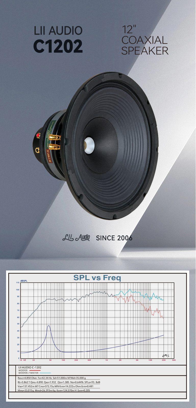

On Ali Express for international buyers at the moment I can see '12 inch (C1202) , also '15 inch (H1502) and even '18 inch (Lii Audio TRIAX 18 and C1802) models and they are working on a bigger size as you can read on instargam page.
Some of them are good looking units, but pricey! What about sound quality?

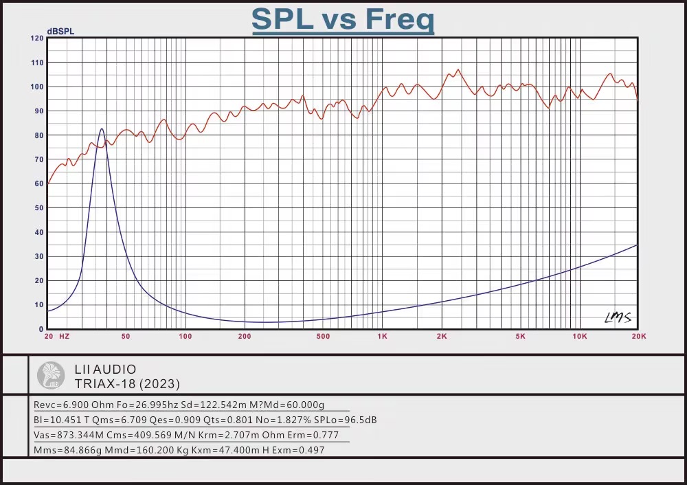

For coax, it is customary to provide data for the woofer and the tweeter separately. I have no idea how they came up with the curves provided.
And I didn't have time to check, but hopefully the data will not be a mess like the previous drivers made. It was inconsistent across distributors and some of it was wildly off.

Funny that the second site mentions that they did not bother with a complex crossover, but opted for a "simple" one. So, probably just a cap on the tweeter. To pair with a 12", 15" or 18" woofer? yikes....
I'll reserve judgment on these until someone has a pair in hands and actually measure them. The whole thing, T/S, impedance, FR, distortion,...
Those impedance plots given by the company look so.... perfect, and wrong if it's the combined of woofer + tweeter.
@perceval what looks suspicious to you? Just curious.

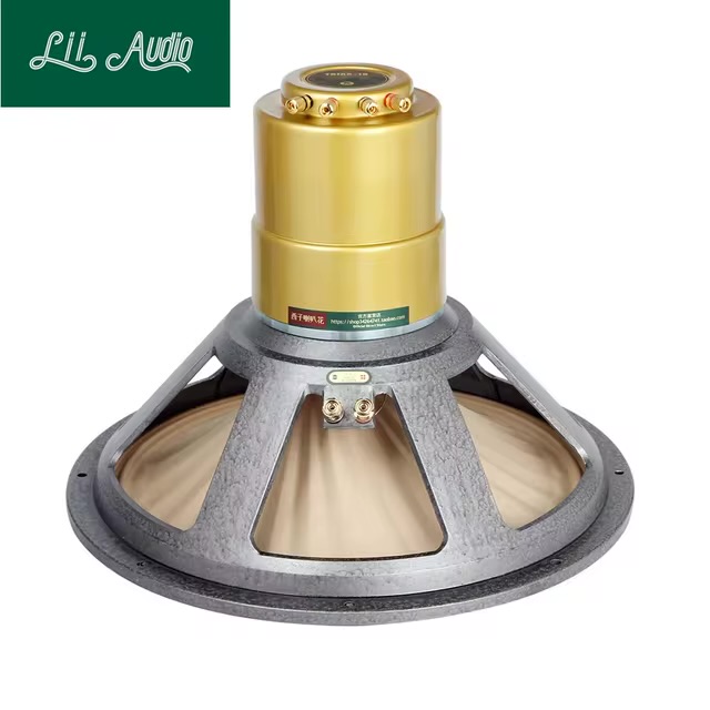

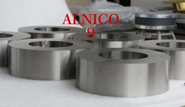

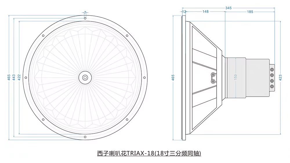

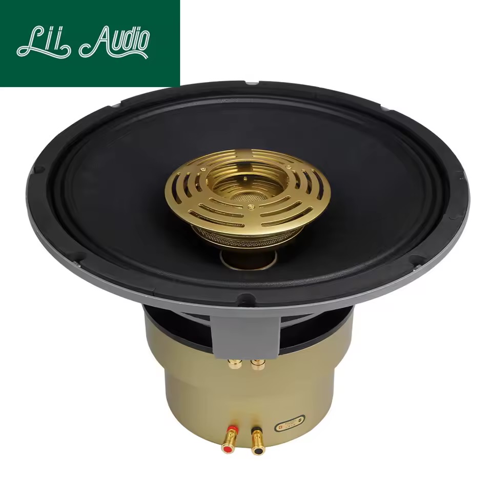

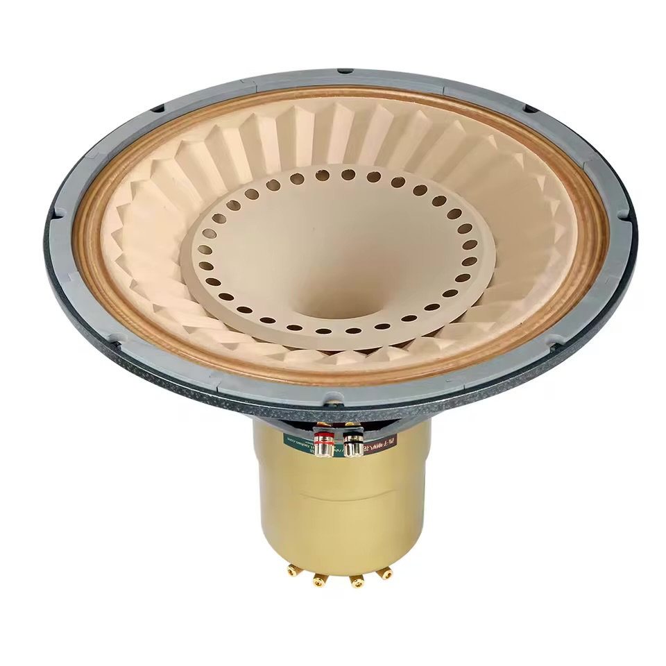

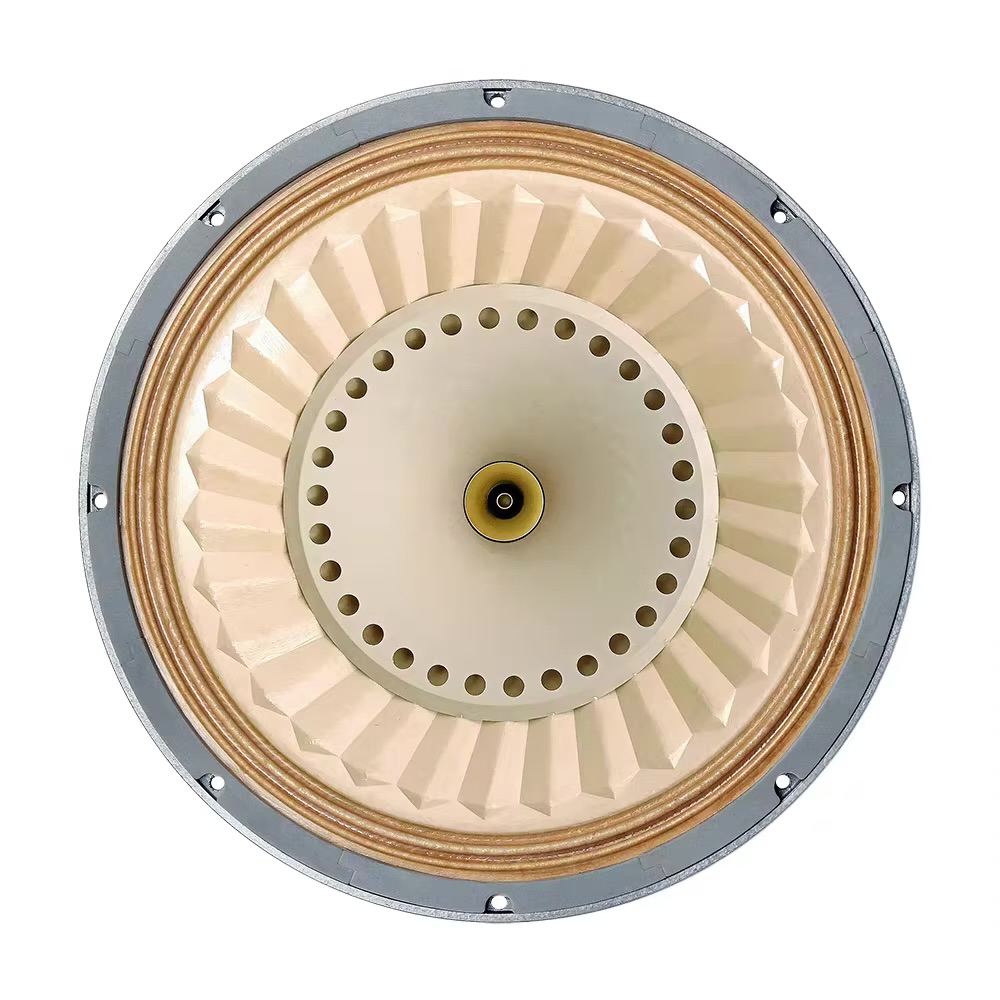

This is top of the line at the moment (most expensive) LII AUDIO HIFI 18 Inch AlNICO9 TRIAX-18 3-Way Coaxial Speaker
Technical Parameters as stated here:
Resonate Frequency fs:27hz
Frequency Range:27-22khz
Sensitivity (1w/1m) :96.5dB
Nominal lmpedance:8Ω
Shortterm Maximum Power:200w
Total Quality Factor ,Qts:0.8
Voice Coil Diameter: 44mm 50mm 100mm
Magnet Diameter: 150mm
Magneric:Alnico 9
Equivalen Air Volume to Cms,Vas:873L
Mechanical Quality Factor,Qms:6.7
Nominal Diameter:465mm
Net Weight:14.2kg
Magneric:Alnico 9
Net Weight:14.2kg
First, this is a coax but the graph doesn't show the tweeter. Every company I know that makes a coax gives that information.@perceval what looks suspicious to you? Just curious.
No Le, no XMax, ...
And from reading other threads about Lii where people find out that the specs published online are way off.
So, until someone decides to buy a pair and confirms whether the data is correct or completely made up, I would be wary of anything published by them.
+1...........just as bad based on the H1502.I have no idea how they came up with the curves provided............and some of it was wildly off.

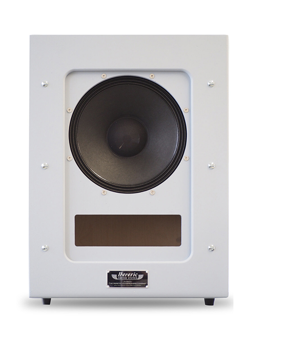

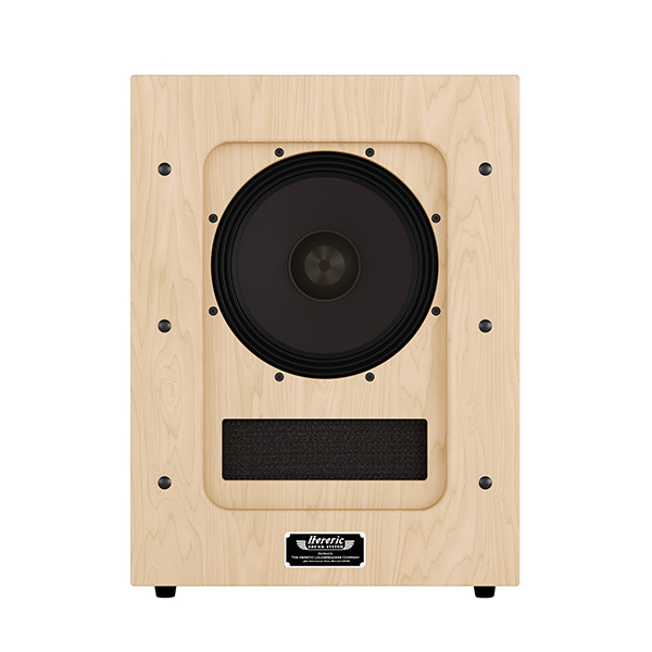

Faital coax drivers installed in the beautiful Altec-style cabinets made in Montreal, Canada by Heretic.
Anyone can comment about drivers?

The review by Herb Reichert is positive.
"As much as these speakers look like vintage Altecs, they do not sound like vintage Altecs. Compared to the various Altecs I've owned, or to Alex Halberstadt's Valencias, which used to belong to Art Dudley, the AD614 is dramatically smoother, more precisely focused, and more evenly balanced across its bandwidth. Art thought speaker imaging was overrated, but I loudly disagreed. For me, if tone, texture, and tempo are properly recovered, then vivid imaging is added proof that a majority of small-signal info is getting through.
In my room, with my sources and amplification, the broad-chested Heretics project the widest, most intricately focused and evenly lit soundspace I have encountered, and they did it while sitting only inches from the wall.
he Heretic AD614s played larger, louder, and more electrifying than my Falcons, Magnepans, or DeVores. They sounded more like studio monitors than Harbeth's 30.2 speakers. But I doubt they sound much like any contemporary speakers you are familiar with. I could always hear the paper in the Heretics' cones, and I was never not aware of the location, mass, and volume of their thin-walled boxes. But for me, those things were more of a comfort than a distraction.
You know how I'm always saying that I can't find what I'm not looking for. Well, the Heretic AD614 seems to be the kind of loudspeaker I've been searching for. It works well with all types of amplifiers, suits my taste in sound, and is sized perfectly for my room. I am happy I discovered them. Give them a listen. These Heretics might be the speakers you've been wishing for, too."
-Herb Reichert (Stereophile)
Faital PRO 12'inch drivers in Heretic AD614 speakers:
