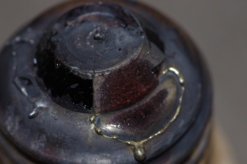

Not audio, but lightbulbs are tubes, right?
Last night I heard a nasty growling sound from a light, as it failed.
Upon inspection, this is what I found (See pics).
This light (it's actually a heater bulb, for a bird), has been on 24/7 for probably 10 years.
I'm wondering if the damage I'm seeing happened all at once, when the bulb/socket failed. Or if maybe metal was creeping, and eventually created a short.
Basically, on pic one, in the circle is a very fine coating of metal, on the glass insulator of the bulb socket. It is partially conductive. I measure about 4k ohms across a couple mm of the substance.
But, pic two has some amazing metal migration.. (This, I'm pretty sure happened all at once when the bulb failed) The brass of the bulb socket is coating the glass insulator. Along the edges of the metal (which is now on the insulator), It's fully conductive. The middle of that area is coated in glass, and not conductive, where the ceramic bulb socket must have vaporized too, and then been deposited as glass on top of the brass, which was deposited onto the glass insulator.

Not metal migration, arc from center contact to socket center contact resulted in increased resistance. This resulted in more arcing until it melted the center conductor and the arc blew it away from the center point.
Look at the socket for more damage.
Replace the whole shebang.
The socket is completely empty at the base!
There are a few rows of threads towards the top (builb) end.
But the bottom of the threads, as well as the center 'hot' conductor are completely gone!
But also, it's definitely the brass threads that somehow got blown UP onto the glass insulator.. (bulb was facing down, the base, at the top). I don't think it was an arc to the center conductor melting it down onto the insulator.. In pic two, that's not stuff on the brass threads.. those threads are missing, and the ceramic under them is melted!
That part seems strange to me.
Otherwise, I think you're probably right about what happened. Maybe the arc started at the threads and quickly sparked upwards, taking the metal w/ it...

It's amazing how much damage an arc can do in about a second. There's a lot of missing metal!
All the lights in the house dimmed when it happened. And, it was over before the breaker tripped.

I have had some rather weird failures in light fixtures where the bulb is facing downward. The base gets exceedingly hot. Heat plus Florida humidity plus copper creates the green growth which does conduct electricity. Red Florida fire ants conduct electricity too due to their tannic acid content. The bird, or any live creature exhales humidity, so you probably have similar conditions.
We have had two CFL's fail, one quite catastrophically in the garage ceiling fixture. One did the arc, flame, smoke and bang thing when the green growth grew on the PC board eventually creating a short, which created an arc, which carbonized the cheap phenolic board, which exploded in flame, blowing the little wire over to the base contact in half. All of this happened without blowing the breaker. There was no fuse or other fail safe mechanism inside the base.

Typical arc-over failure. The resistance of the filament won't allow enough current to open a fuse or breaker, but an arc can get extremely hot even if the current is limited to an amp or so. Not hot enough to weld steel, but hot enough to melt brass.
