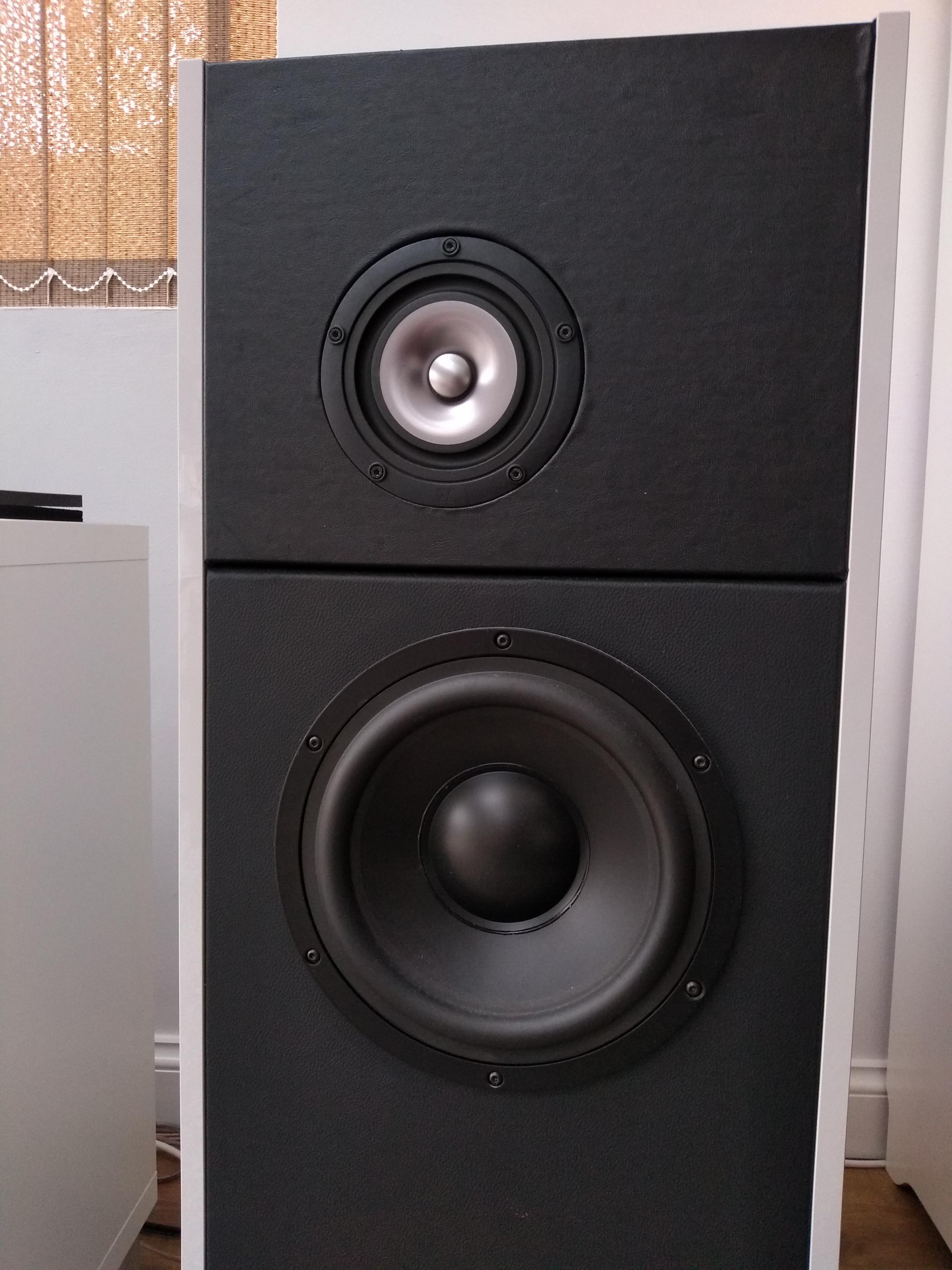

Just last night i got my A5.2eN/twin Peerless 930870 MLTL WAW and i must say it is really putting a smile on my face. The incongruity of the tallish slim speaker visual and the huge immersive soundspace with chillingly real bottom sonics is quite strong.
I have to yet try the slighly higher XO point (250 vrs 180 Hz).

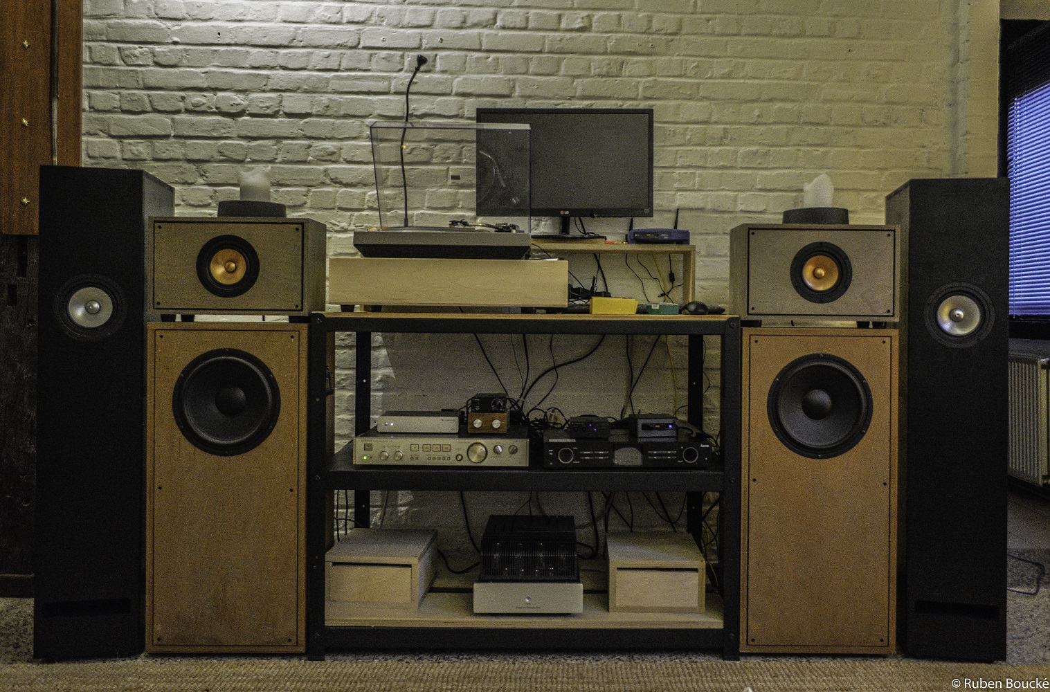

Well, i started to explore TL's after my waw with an Alpair 10.3 and a scanspeak 26W/8534G00 woofer. And i'm enjoying the sound of my cheap try out of my first MLTL design with the (cheap but excellent) CHN110 driver a lot...
Here they are standing side by side, the MLTL is the black one of course, and is now made of MDF and just fast painted black with Warnex. But i like it enough to remake it in plywood and finish it like it should.
