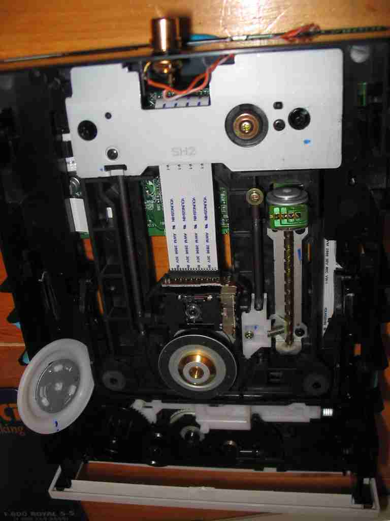

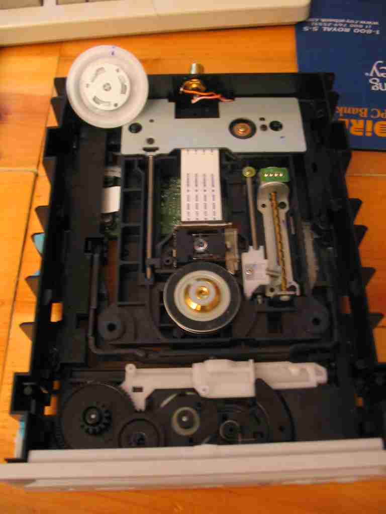

Attached is picture of the drive with the tray removed. Toward the back is the centrally mounted RCA jack with CAT5 cable wired directly to the output. The output level when not connected to the DAC is 5v peak to peak. When attach to a typical 75 ohm DAC termination, the level drops to 1/2 and puts out 2.5V.
The circuit board in mounted on the bottom of the unit toward the back third of CDROM unit.
I think "big" improvements could be made if the disc motor and the servo motors were locally bypassed near the motors. The big jump should be when the spin rate is knocked down to the 1x rate.
Although the castings are made out of plastic (no aluminum here), I can hear significant levels of detail using this unit over my DVD transport. It comes down to minimalist parts count and clean design of the interconnection of subsystems.
I do need someone familiar with firmware to help play with different playback speeds (1x, 2x, 4x and 8x) to hear what works best audibly. The built in RAM buffer may have something to do with the sound as well.
In the ATAPI specification, there is an opcode called "SET CD SPEED" (code BBh) which could be use to limit the playback speed.
PeAK
