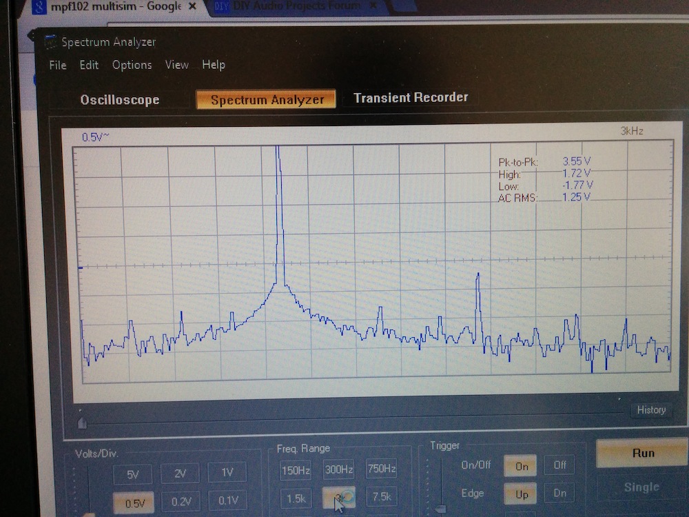

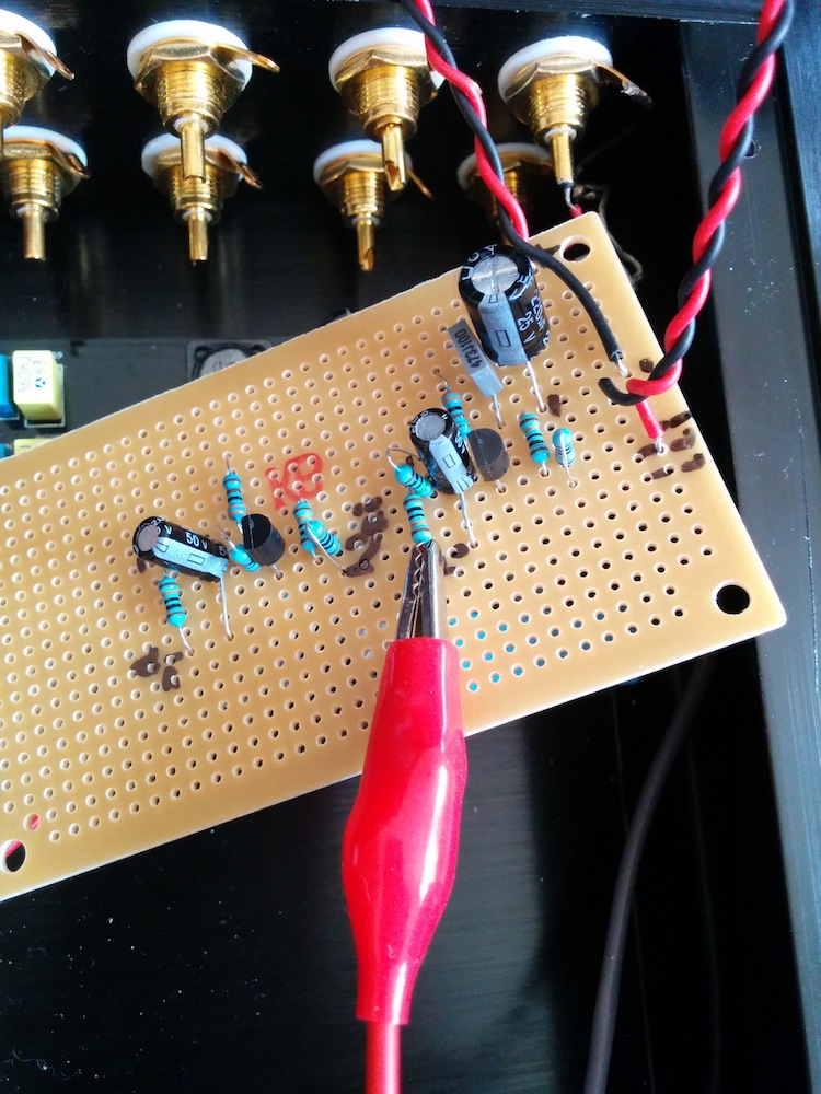

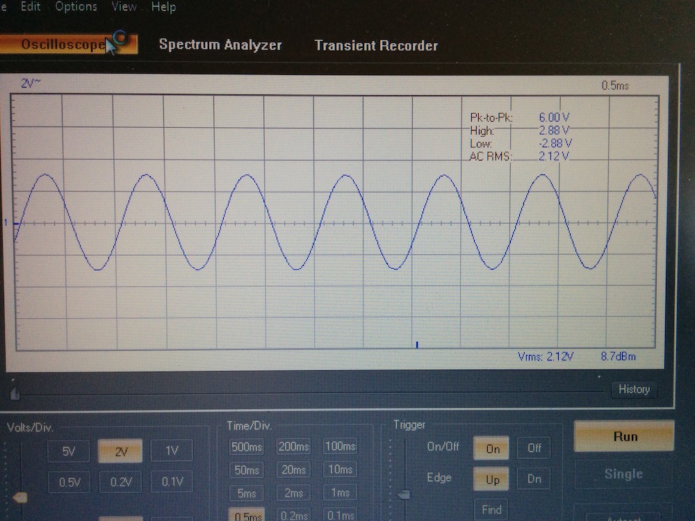

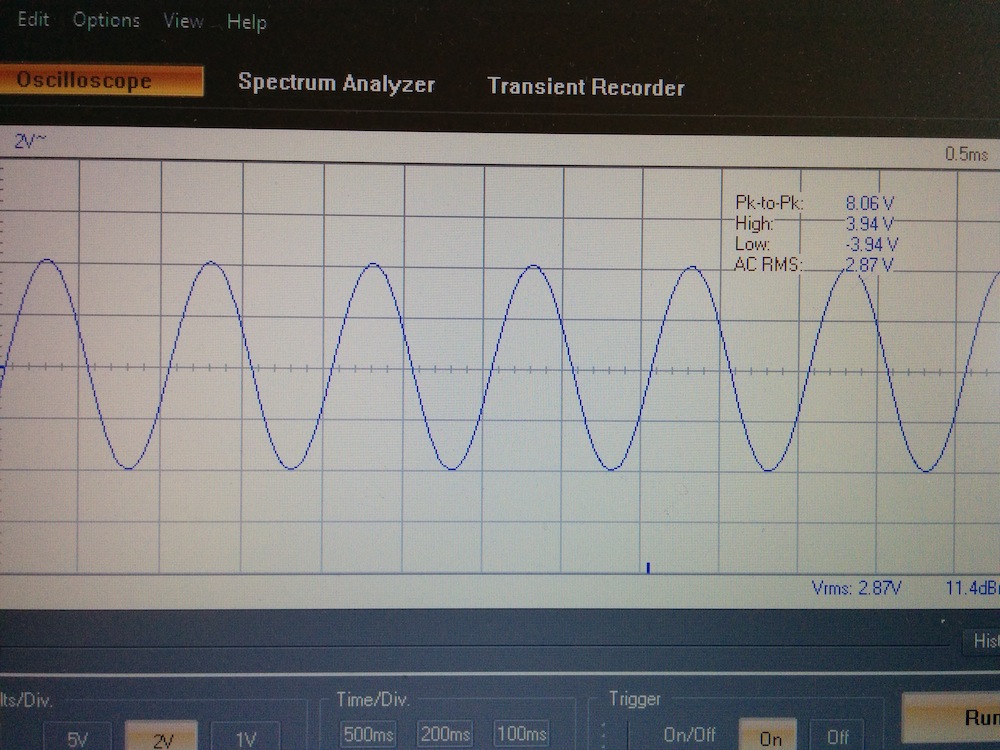

I'm in the process of building this little circuit to use with my TPA3116. Only change I did was to use 715 ohm source resistors.
I hooked up one channel to my EDU01 kit oscilloscope, and here are the results so far.
I ran a 1kHz test tone through my Rasberry Pi/HifiBerry DAC, and it outputs about 2.1V:
attachment.php
After running that same 1kHz tone through the little pre, it's amplified to about 2.9V:
attachment.php
I also ran a spectrum analysis, and from what I can see there is some 2nd order harmonics. (The signal looks really distorted, but it looks about the same directly from the DAC.):
attachment.php
Finally a picture of my little buddy:
attachment.php
I won't have time to listen to it yet, too many other things to do atm.

Very cool skrodahl! Thanks for sharing. Interesting that this is also a JFET pre. I wonder how it compares to the JFET BOZ.
I would imagine that the Jfet BOZ would perform leaps and bounds over this one. In simulations (using Multisim with the J309 transistor) it has a THD of about 1%. This MPF102 circuit has way less gain, which is important for me.
I still haven't figured out how to fit the pre in my home made enclosure yet, as a RIAA stage is more important at the moment. It will still be some time before I can properly test it. (And I have not built the jBOZ, so I wouldn't be able to compare anyway.)
