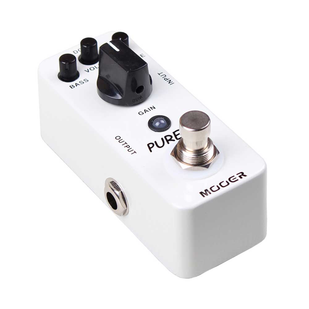

check booster pedals, etc
this one looks sweet, and not expencive 🙂

If you have any Boss pedals you can test if a mere buffer will resolve the issue. All Boss pedals (and many others) have buffering, even when the effect is "off." (I place a Boss in front of my DIY Fuzz pedal to avoid loading issues.) The eq is likely to improve with this but volume may not increase measurably. Buffered is the alternate to "true bypass."
Play thru the pedal in "off" mode and you are playing thru a buffer. For a volume boost, which also seems appropriate, get a "boost" pedal that has a low impedance/buffered-output as mentioned by others. I suspect they are all low(er) impedance on their output than a guitar. DIY for such can probably be low cost.
This can also be called a preamp IMHO.
