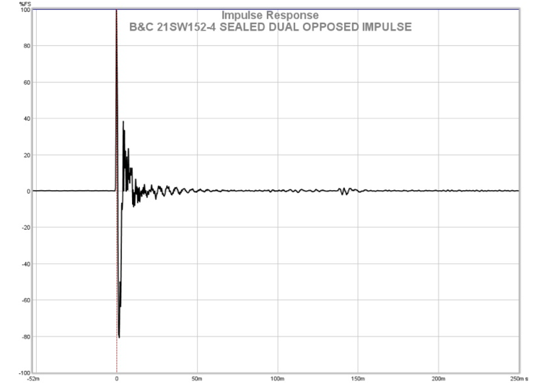

With enough BL, even huge "heavy bass membranes" can have great transient response, as the impulse response of two of Josh Ricci's 21" B&C woofers in a small sealed enclosure prove.
They also, with enough amp power, get plenty loud, well above 130dB at two meters outdoors in the upper range.
I am a fan of bass horns for their efficiency, but with amp power relatively cheap, and real estate often at a premium in a house, they are not the only way to get clean articulate bass detail.

Exactly. The kind of suspension from the transducer determines mainly the perceived audible quality:With enough BL, even huge "heavy bass membranes" can have great transient response.
