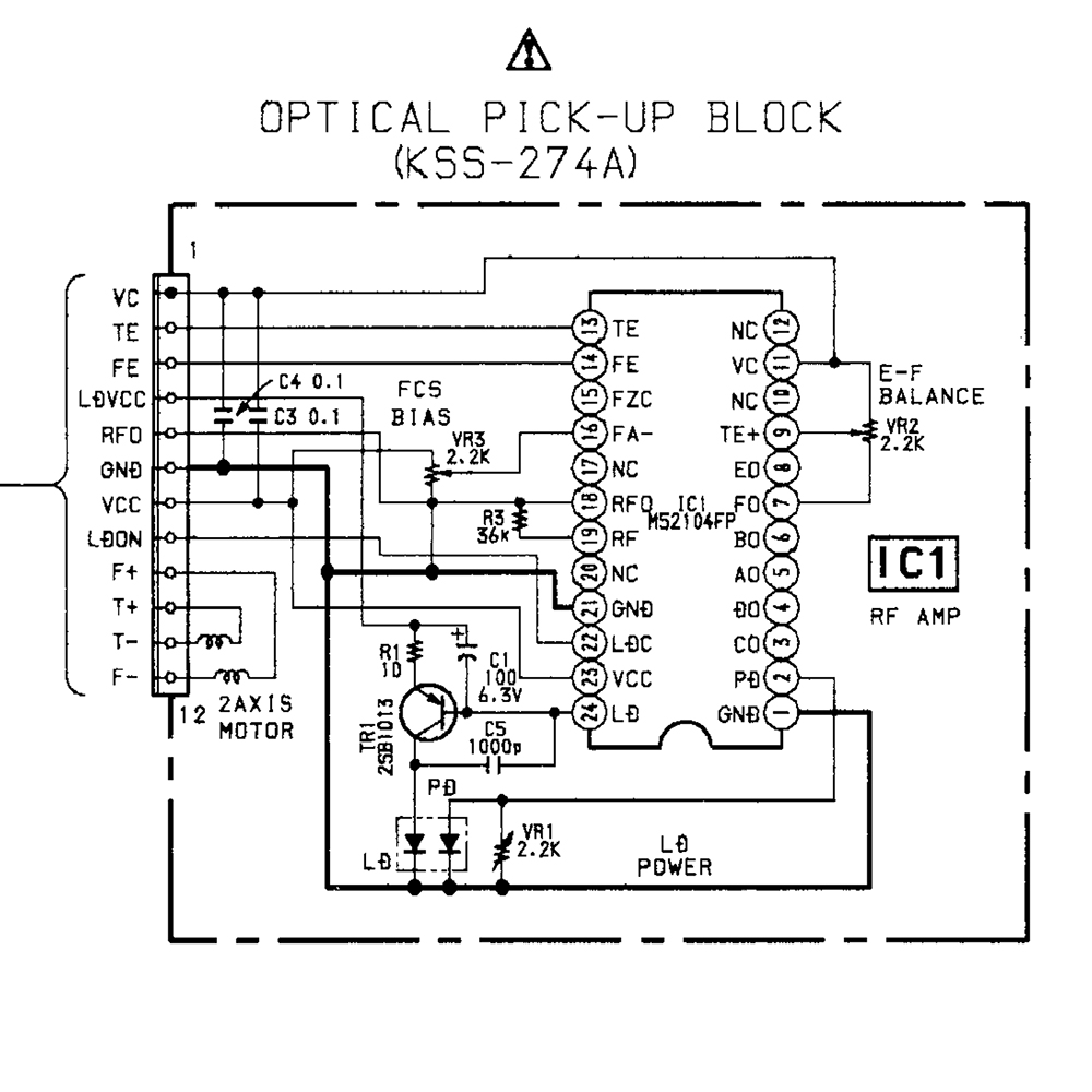

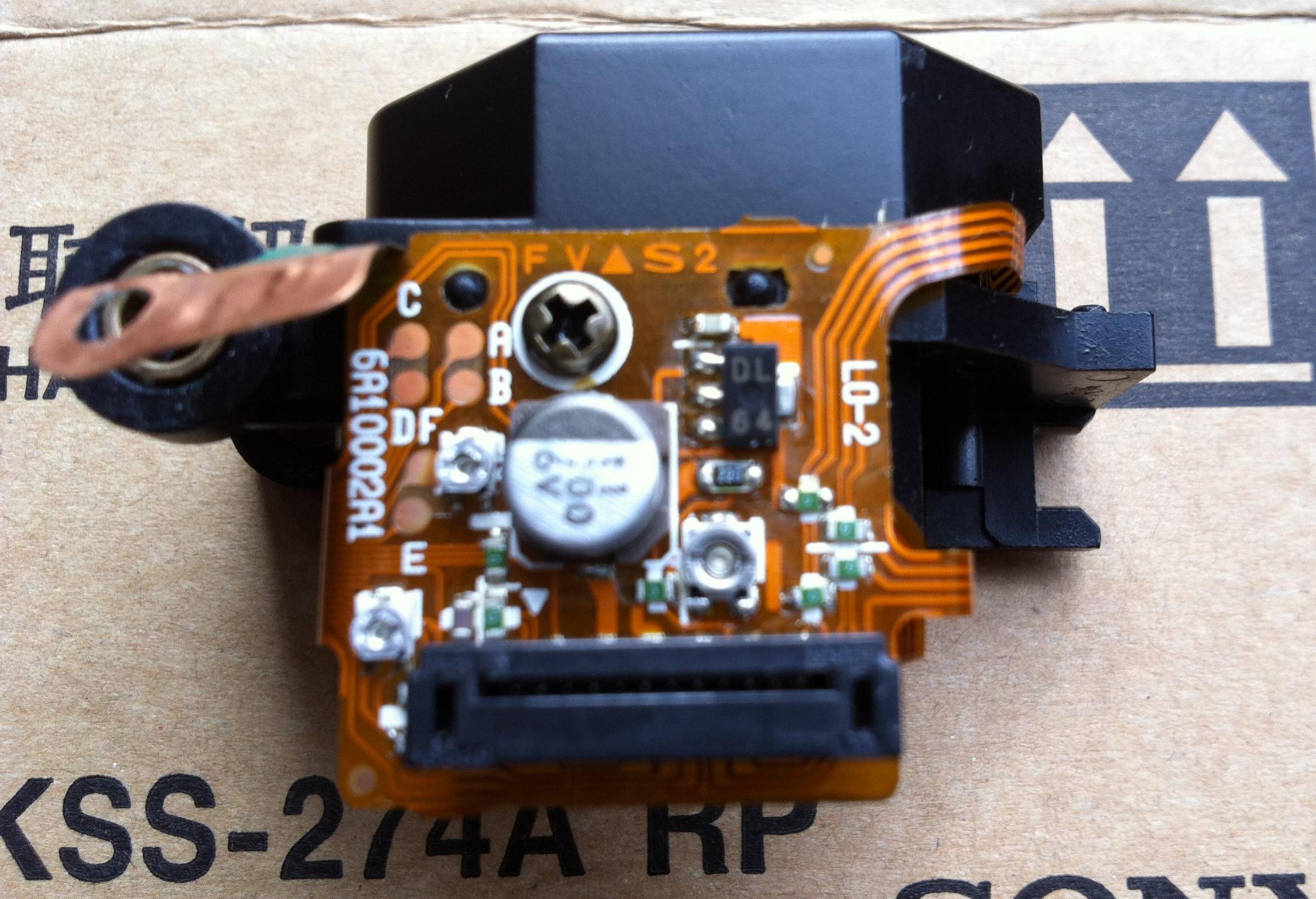

Photos of the KSS-274A and KSS-240A.
Both have an onboard IC for laser power, E-F balance and focus offset,
M52104
Both look identical besides another KSS-240 circuit diagram I found in a CDP-S39.Eveb though it is a KSS-240 as well, the IC is stated M52103.
I assume they are identical.

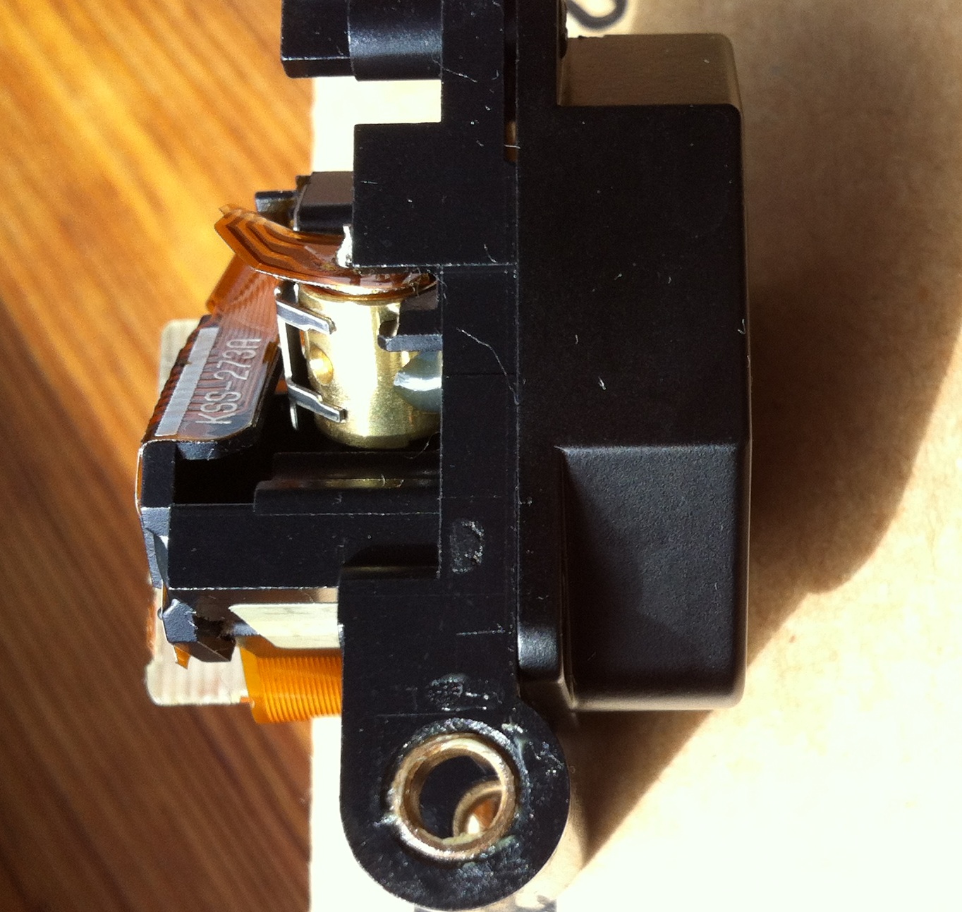

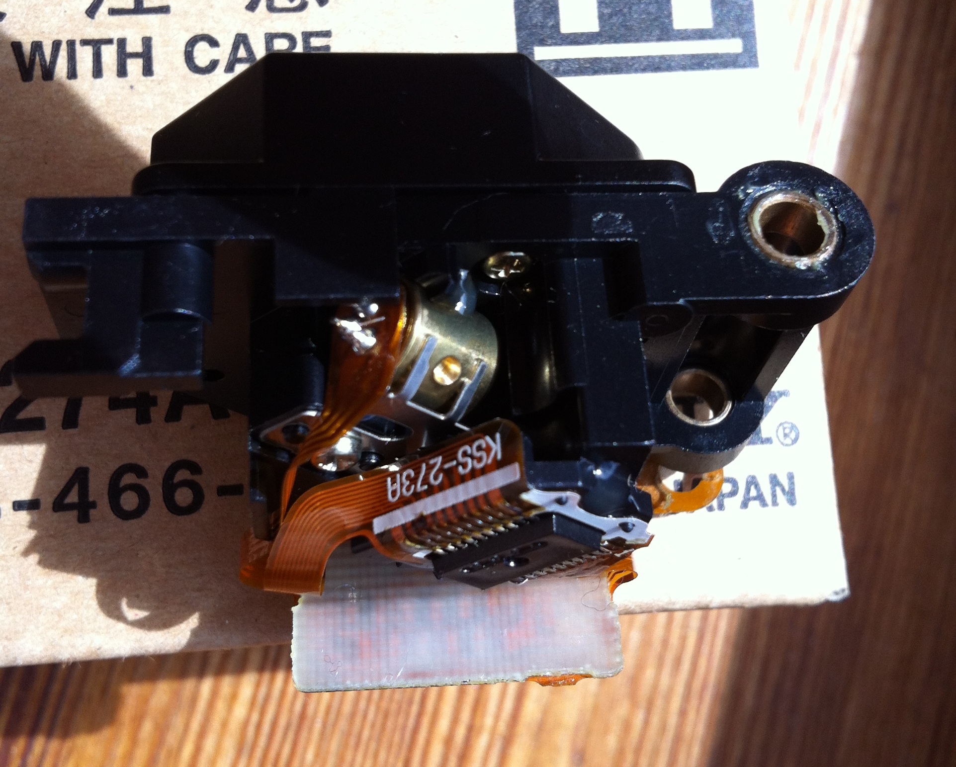

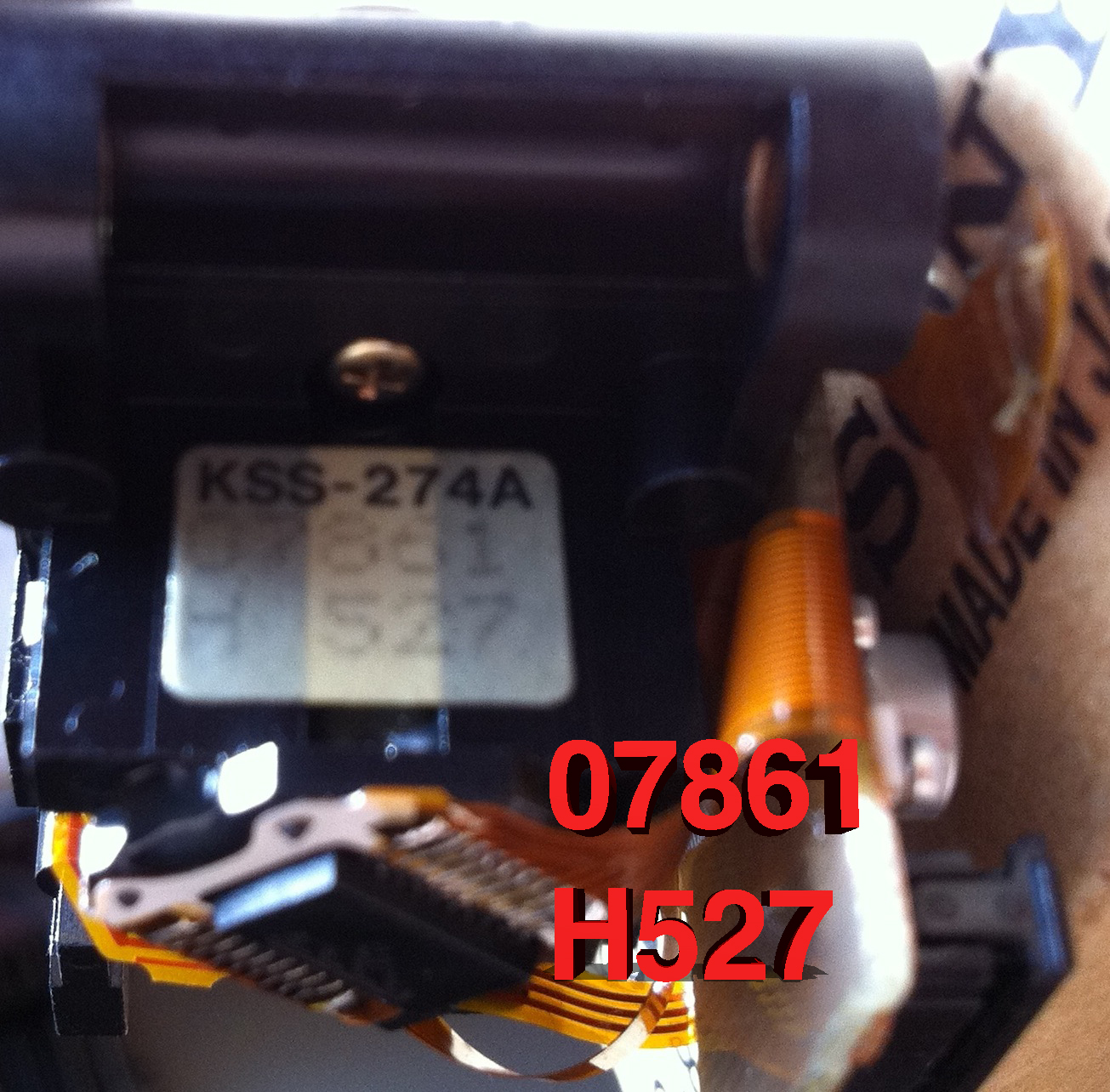

Here we go, KSS-274A. Note that the print on the flexible pcb is KSS-273A:

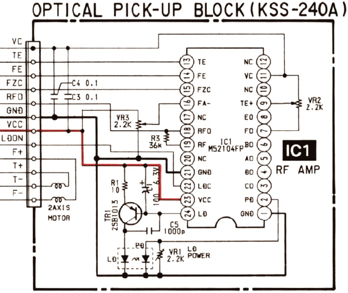

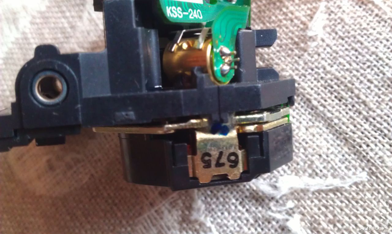

...and KSS-240:
The the size way how the diode is fixed in the housing looks the same as in the KSS-274A. Circuit diagram also looks the same compared to KSS-274A.
Inthe CDP-S39, the IC is named M52103FP. I assume, they are still the same.
