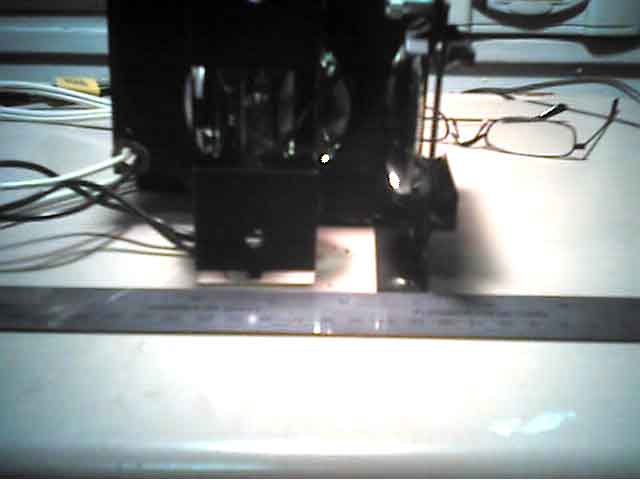

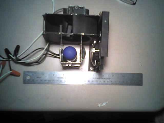

my condensors & lamp
Hi, I'm going to post some pictures with hope of a second opinion. Please before you decide to lecture me about the lamp quality not that this is only a prelimanary setup. It's the setup as it was in the old slide projector except for where I've bent the aluminum framing. I'm thinking that this will be enough to test with once I get the 5.6" lcd and triplet lense.
I have tested with this setup and a picture printed out on plain white paper between the two fresnels and focused with a lense yanked off of an old film/photo to video transfer device. It showed a picture but obviously not a very good one.
One of the things is that I'm not expecting perfection with this so called "high resolution" display. I have deciphered the manor in which many of the sellers are determining the resolution of these units and the only thing high was them.
OK from the top
OK from the top
