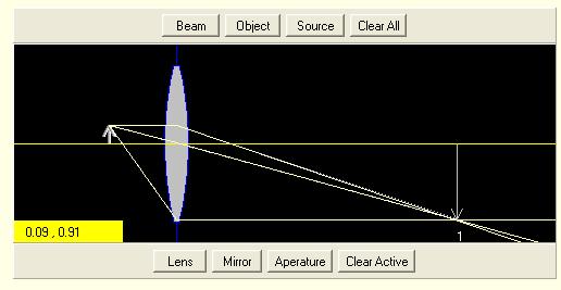

Okay, the comment on not producing an image. This is ultimately for a DIY projector, but when you shine the lightsource through the LCD panel, are you saying that through that, it is no longer a parralel beam? And if it's off by a little to not be parralel, is that a major issue?
My main question is that LCD screens seem to be larger than the emission matrix (or tube thing at the end, I don't know what the formal name is) so when I put my light through it, in order to make it fit through the emission matrix, could I focus the image. I know it would take a lot of calculation to find the proper kinds of lenses to focus it out, but could I condense the image, (or colored rays of light, or some other fancy term I should be using) and then put it through the emission matrix to produce my final projected image? I was just under the impression that if I were to do that, all the different little rays of color would be condensed into a smaller section of such rays but in the same realitive posistion after all the other rays were condensed. If I am completely wrong on how that works, do not hold back explanations.

Take a look at the attachment, I did this one to kind of show you how basic projection works. The small arrow on the left is the "object" and represents the LCD. The lines from the point of the arrow through the lens shows how light goes throught the lens and gets projected. The bigger Arrow on the right show how much the projected "object" is magnified and how far away it focuses an image from the lens.
When you say emission matrix, do you mean the projection lens?
Ya, I couldn't think of the right word but when I say emission matrix, I mean the final projection lens. And thanks for that optics simulator link.
I'm not sure what you mean though, by that image. I understand that a projection image is a collection of beams of light with secific color to them. Correct me if I'm wrong there. And that the initial image is small, so then after it exits the projection lens, it gets larger. Thus making a projector possible. I'm asking if it works the opposite way. Take your image and make it a little smaller, but before it hits the focal length, put a concave lens there to straighten the beams out again. I'll try to get an image soon.

The answer to your "main question" is yes! You have re-invented the light condensor system used in almost every projector.
If you build a projector with a small LCD (or CRT) and a very large lens that can be very close to the LCD or CRT, then you don't need a condensor. Most of the rays coming from each pixel will hit the lens and get focussed to a point in the screen image.
If you build a projector with a large LCD and a small diameter projection lens, then you need a condensor lens to direct the light from all the pixels into the projection lens. Without the condensor, you would see a very dim image because most of the rays from each pixel would not even hit the lens.
Most DIY LCD projectors use a pair of plastic fresnel lenses (like page magnifiers) to implement the condensor system. These can be as cheap as $5-10 by using actual page magnifiers, or you can buy better fresnels for $20-35 each. Since almost all such projectors use a Metal Halide lamp as the light source, they place the first fresnel (the condensor fresnel) so the lamp arc is at the fresnel's focal point. (Usually 200-220 mm from the fresnel.) The result is a fairly uniform beam of pure white light coming out the other side of the fresnel. The LCD is placed at least 1 centimeter from the condensor fresnel (so the focussed screen image will not include the fresnel's ring pattern).
The field fresnel is placed at least 1 cm after the LCD, to bend the parallel rays into the projection lens. The field fresnel does slightly magnify the screen image, but it is placed so close to the LCD that this effect is minimal.
So the standard DIY LCD projector really consists of two interacting optical systems. The "projection system" uses the projection lens to focus LCD pixel rays into a screen image. The "condensor system" uses the fresnels to focus an image of the MH lamp arc into the projection lens. That gets most of the usable light on the screen for a bright image.
