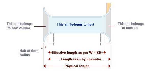

I am about to start building a pair of loudspeakers using Seas A26 drivers. I will be constructing the cabinet out of Birch ply and was planning on making the port out of a drilled stack of plywood. The entire cabinet will have a 20mm radius roundoff milled on all the edges and I was planning on doing the same around the edge of the port hole.
My question is, should the length of the port include the 20mm roundoff or not?

Usually the half of flare radius is included.My question is, should the length of the port include the 20mm roundoff or not?
You will have to account for the roundoff, there is already a lot of info at diyaudio.com about how to calculate when using a flared port.My question is, should the length of the port include the 20mm roundoff or not?

That would be a perfect opportunity for an even more flared port, using my port optimizer tool: https://www.diyaudio.com/community/...rbers-and-port-geometries.388264/post-7943524making the port out of a drilled stack of plywood.
And then again, don't focus too much on the exact alignment. You won't hear the difference if it's 5Hz off.
