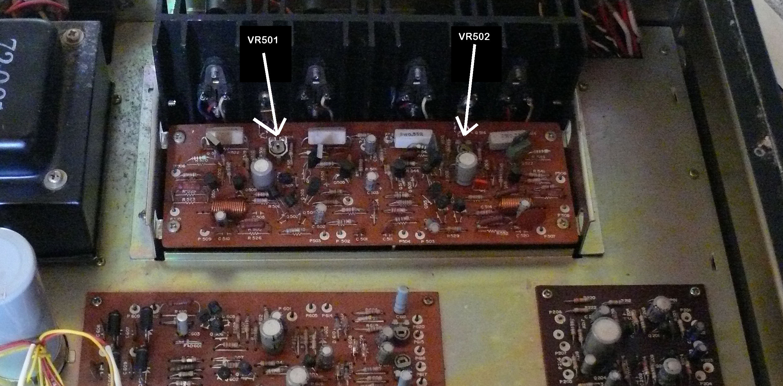

i believe adjustments for Vbias are being done with potentiometers ( there is 2 of them in total) so one is for left channel other is for the right?

P.S. Can you point to the trimpot(s)?

trimpots:
vr501 and vr502
