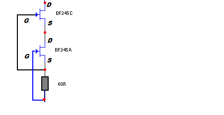

Hi
OK, I've tried out a few ideas, and have come up with a couple of modifications to the already excellent Legato, which, to my ears, are very worthwhile.
Firstly replace the BC550B's with 2SC2547E. This has very low noise- about as good as it gets- and about double the hfe. It's also reputedly very linear when used in common base mode. Whatever the reason, it does the business. With BC550B fitted piano from CD was the best I've heard (piano on CD has always sounded wrong to me). With the 2SC2547E fitted, it's better still!
I matched the transistors for hfe, though the batch I have were probably close enough for this to be unnecessary. Note the pinning of these devices is bce, not cbe, so some lead bending and insulation is needed. The biggest problem is that-like all good things it seems- this transistor is no longer made, though it's not too hard to find. 2SC2240 is a near equivalent, though whether it sounds as good I don't know. BTW I also tried replacing the BS250 Mosfets with the 2SC2547E's complimentary pair, the 2SA970. This worked, but- as I've found in similar applications in the past- the combination is unstable, and generates program-related frying noises and clicking. Avoid!
Perhaps even more effective is fitting the current mirrors with constant current sources. To achieve this I replaced R19 and R22 with a CCS composed of cascaded BF245C and BF245A JFETS (see attached). A value of 68R for the resistor gave the required current- 2.7mA, and little adjustment was subsequently required to reset the input voltage to 1.70V (one half AVCC). Leave the circuit to stabilise for a few minutes before final adjustment.
Well, there you go. Apologies if you don’t hear what I hear! 🙂
Paul

Perhaps even more effective is fitting the current mirrors with constant current sources. l
If this were a single ended circuit you would be totally correct that adding CCS would help quite a bit. In fact with an SE DAC it will help significantly.
But in this case, with a truly balanced source, both the upper and the lower half of the circuit are already a constant current source/sink by virtue of the symmetrical nature of the circuit. In other words, the circuit is always in relative stasis. One side of the circuit is always counterbalanced by the other, so that the entire circuit is always in balance. Any impedance effect at one half is countered by an equal and opposite effect at the other. I had actually tried simply adding a cascode(in the form of a ccs), but I actually found this to reduce dynamic range far too much. Essentially what you have done is add a complex cascode.
I think you have probably been reading I/V threads that concentrate on single ended DACs.
As for the transistor choice, it is certainly a good part, and worth using, but not likely to yield astonishing results. I only say this because the noise is already vanishingly low. Still there are dozens of great transistors that will work very well. That certainly would be one. I would choose one with the same pin-out as the stock part. 😎
Good work with your experiments. I hope my constructive criticism does not dampen your enthusiasm.
Cheers!
Russ
