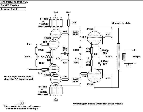

Ok, so I have some leftover transformers that are looking for a project and I don´t know what to make with them. Do you have any suggestions?
I have just compleated a KT88 based amp so this is no option.
I would like to use them in an stereo integrated amp.
Power Transformer:
Primary:
230VAC
Sec:
1x390V 0,5A
2x5V 2A
2x6,3V 4A
2x3,15-0-3,15V 2A
1x40V 0,1A
Output transformers:
PP 4K

It screams push-pull EL34 with fixed bias to me. That's probably not a heck of a lot different than your previous KT88 project though.

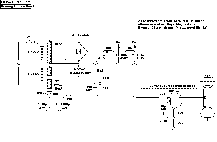

I vote for Petes red board:
http://www.diyaudio.com/forums/tubes-valves/151206-posted-new-p-p-power-amp-design.html

Don't know about that power xfmr, but that 4K P-2-P OPT would work nicely with 6BQ6GA/GTB finals.

Hi taj
Yes! this is what I was thinking too but would 4K OPT´s work? You don´t happen to have a stereo integrated PP EL34 schematic somewhere?
