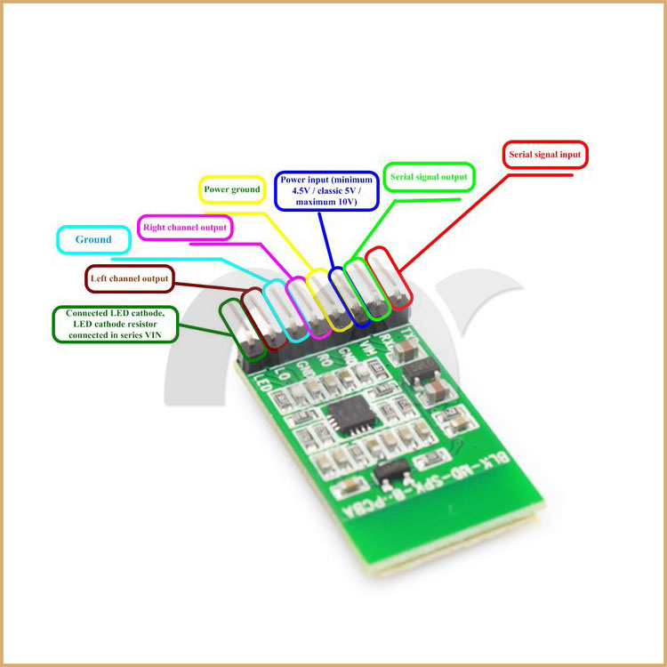

I have this little bluetooth module (wiring guide picture attached), but I don't understand...as you can see, it only has a common ground for the left and right signal. It's then being fed into an amp that requires a Left + and -, and a Right + and -.
Do I just solder two wires to that ground and send one to the left input and one to the right? I didn't think the two signals could share the same ground.

Out of curiosity, could you explain why? Other things I had read indicated that the positive lead makes the speaker cone modulate one way while the ground lead makes it modulate back the other way. If that's true, how can they both share the same ground and not be messed up?
In general, if you have two completely isolated, floating circuits, they can be connected together at any point A on one circuit,
and any other point B on the other circuit, without changing their operation in any way. No current can flow from one circuit to the other, since current flow requires a loop. (This is disregarding parasitic coupling between the two circuits.)
In stereo circuits, you have two (more or less) identical circuits, usually connecting their commons together (often unfortunately called "ground"). Sharing their commons can allow good results, if done carefully. If not, then you can get reduced separation (crosstalk) and/or hum.
