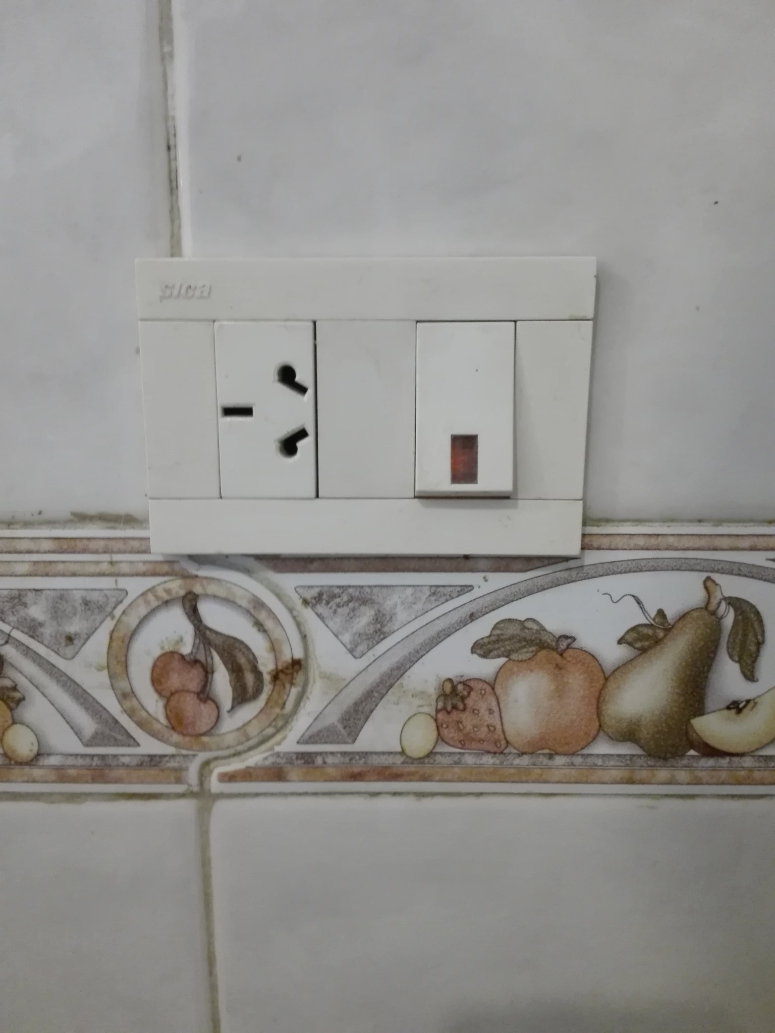

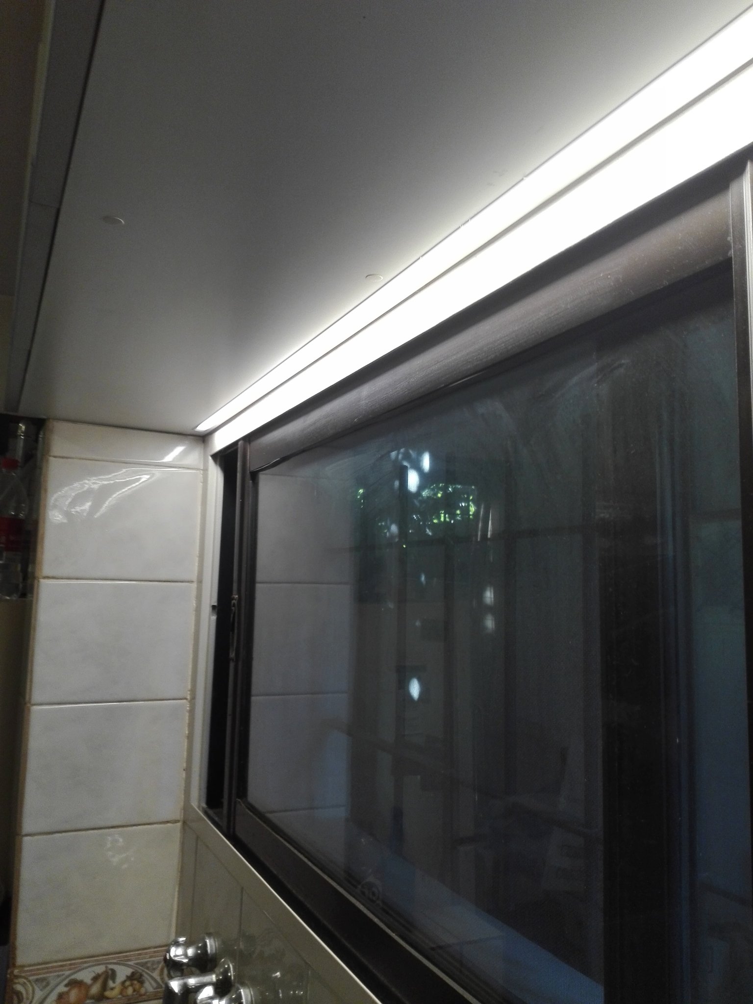

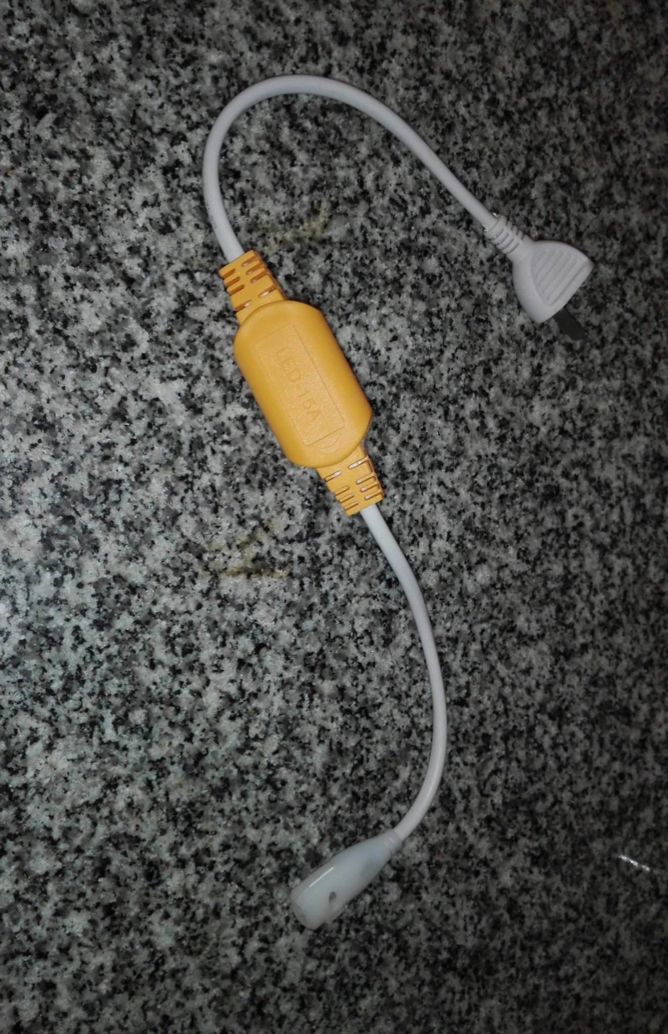

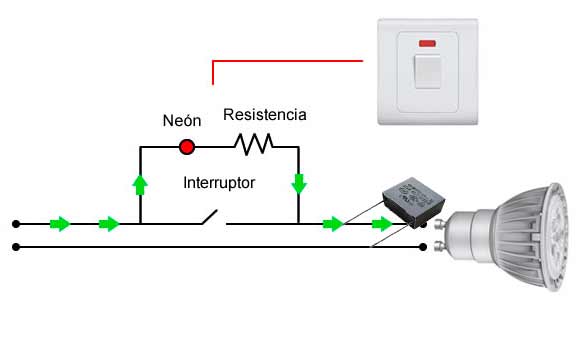

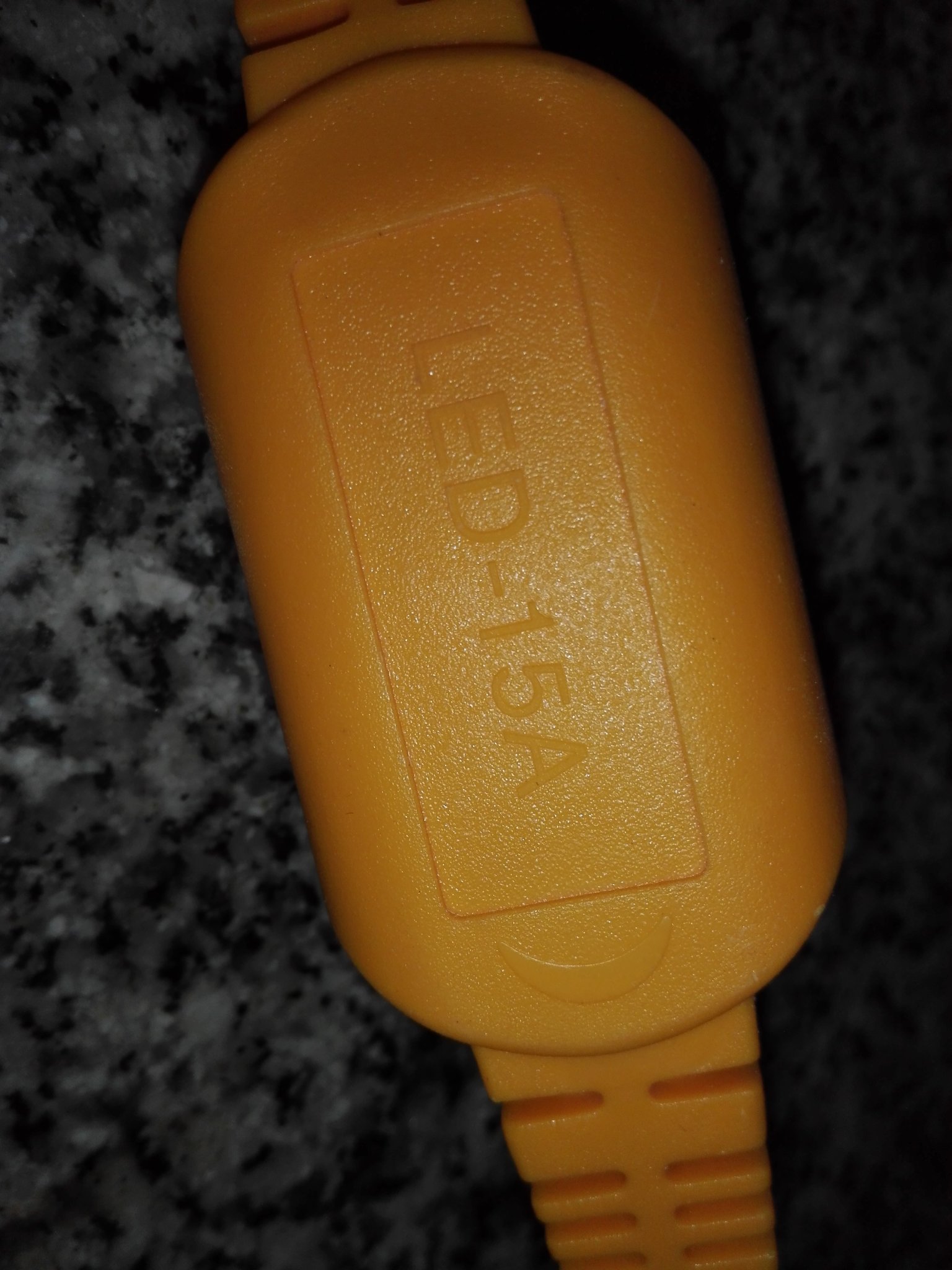

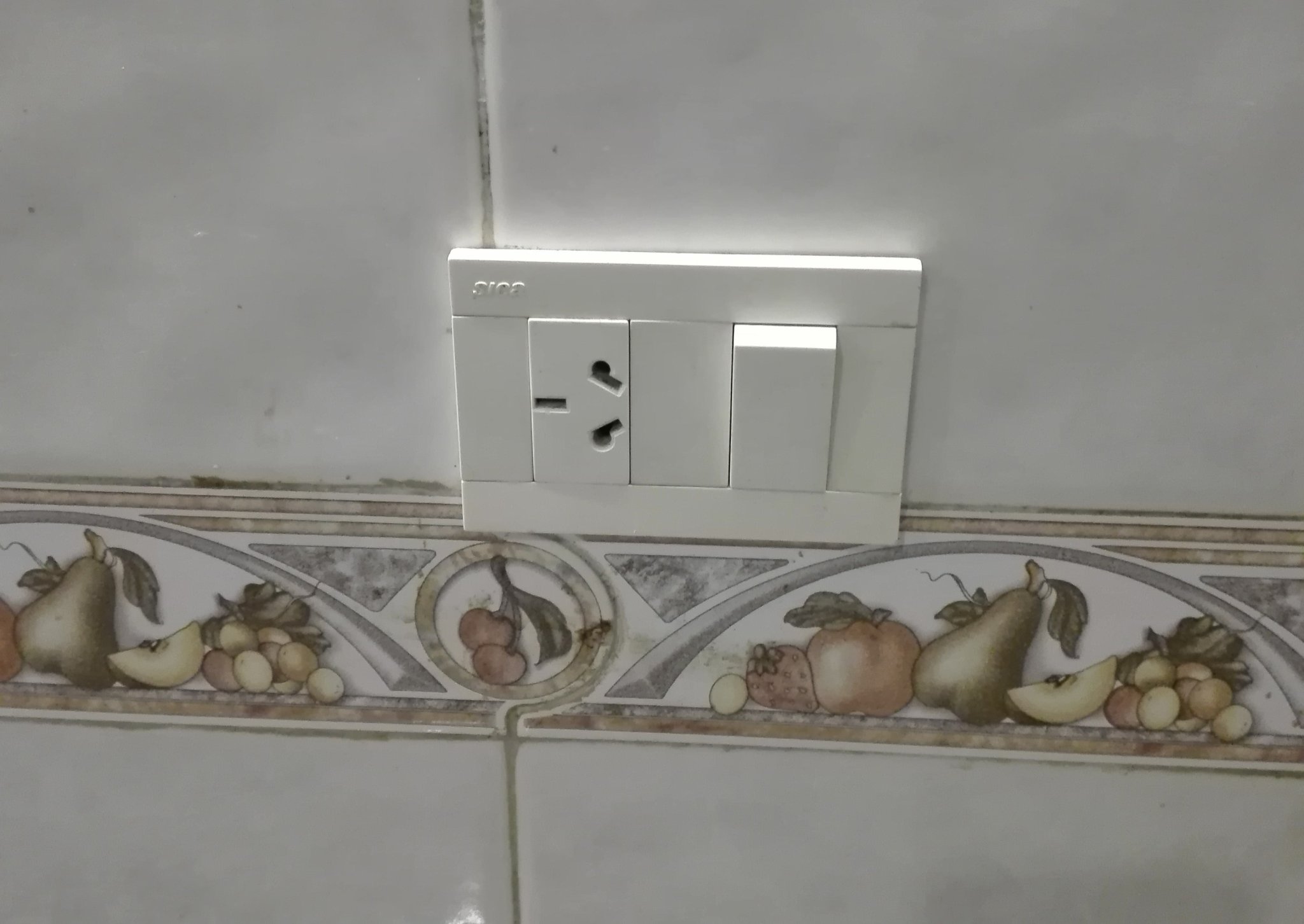

The LED strip that I installed in a new kitchen cabinet blinks when the switch is off. The culprit is the neon, which allows a minimum current to pass that fluctuates depending on the network frequency.
Searching for info on the web, it seems that it is eliminated with a parallel capacitor, but I can't find how to calculate the value exactly. Some YT tutorials mention 0.47 mf. x 275 VAC, other 1 mf. x 400 VAC. I tried what I had at my disposal, 1.5 mf, x 250 VAC, polyester capacitor. It didn't give any results, so I looked for some more specific information, but all the manufacturers abound in the benefits of their products, but they don't provide that information, which seems to be a state secret kept under seven keys. I imagine there must be a way to calculate it according to the frequency of the network and the voltage, here we have 50 Hz and 220 volts. But it seems that these modern luminaires work with DC or AC, I imagine that the one installed is AC, from the looks of it, it does not seem to include a rectifier and it should indicate it if so...
P.S:
I don't want to override the neon indicator light, it's useful for quickly locating the switch in the dark.

To really calculate it, you would need to know at what voltage the LED lamp starts and what the value of the series resistor of the neon lamp is. Using some rough estimates, 1.5 microfarad should be more than enough, though. With a 220 kohm or so neon lamp series resistor, it should be sufficient to reduce the voltage across the LED lamp to about 2 V RMS, far too low for any normal LED lamp.
If it's not a neon lamp but something that rectifies, then no capacitor can solve the problem.
If it is a neon lamp, but for whatever reason, its voltage drop in one direction is substantially different from the opposite direction, it could also be that the capacitor won't help.
Connecting an incandescant lamp or halogen lamp in parallel with the LED light could also do the trick, even if there is something rectifying in the neon or whatever it may be light.

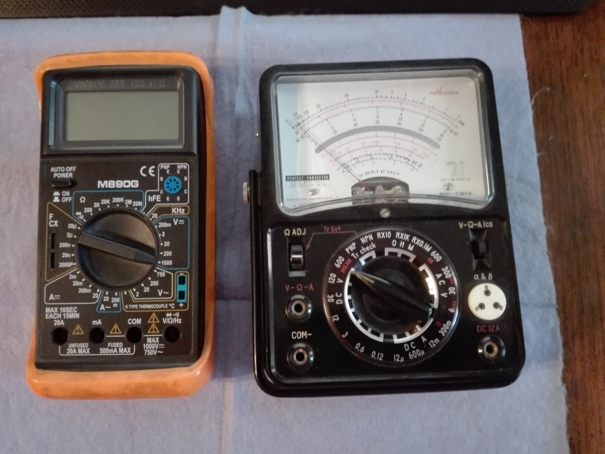

I have these, which one would you use? Which one will have better protection if I select DC instead of AC and/or vice versa ?
Hansen 600 Volts DC / 600 Volts AC
M890G 1000 Volts DC / 750 Volts AC
I seem to remember that a capacitor in series with the (+) tip can prevent damage to the multimeter, but I don't remember the value and I don't want to divert the topic, unless someone knows/remembers it exactly and tells me ! 😊
When you try to measure DC with the meter on AC or the other way around, it is unlikely to cause any damage as long as the range is high enough. That's why I would leave it in the 600 V range.
If you accidentally use a current or resistance measuring range or have the leads connected to the current inputs, then you will have damage when the switch is accidentally turned on. 220 V AC on a meter set to measure current or resistance is bound to cause serious damage.
For the measurement I suggested, I would use the analogue meter, set to 600 V DC, and check trice that it is indeed in the right range, that the leads are in the proper inputs and that the switch of the kitchen light is off before doing the measurement.

It's a possibility to do that, but there's little room to work in there, and I'll tell you that now, my wife, seeing me working in HER 😛 kitchen, tells me to leave everything as it is because she doesn't mind the flickering. .If all you are looking for is keeping the neon light as a locating marker for the switch, if the return wire is available in the switch, tie the neon to the return so the neon is always on. Takes the LED strip out of circuit completely when off then. Neon of course will be lit regardless of switch position. And you'll likely need to increase the resistor on the neon lamp since the series neon/resistor will now be full line voltage.

Having to finish repairing an amplifier, and many other things to do, I decided not to waste any more time. The problem is solved, there is no more flickering. My wife had to accept my decision because my argument was irrefutable: "It is proven that the flickering of LEDs affects plants, because they are constantly subjected to 50 Hz frequencies during the night!" And she is very proud that she is plant has flourished because of all the care and love she transmit to it ! 😊

Thanks, but as I already mentioned, the simple solution I wanted (connecting just a capacitor) did not work, and I also checked that the switch/neon was on the "hot" pole, (may be one of the causes of the flickering) and That's how it went. I have done all the electrical installation in my house personally, and it is my habit that the light switches always operate on the "live" one) which is not the "positive" one, as many confuse, since it is AC)
In addition, replacing the neon on the switch with an LED was too complex due to the little space available inside the box and the time it would take, cutting the light, etc. For easy problems, easy solutions, that's my motto.
