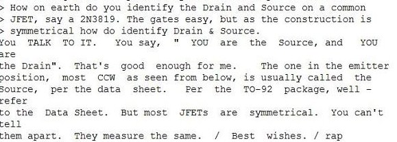

And just to go slightly off topic, where it does get really spooky is identifying the drain and source on a common JFET.
I have the "official" answer from the man himself (Bob Pease of National Semiconductor) if anyones interested 😉

Think we have covered all possibilites for testing LED polarity so here's the JFET way.
He talks to them... honest 🙂
Not sure it would work for LED's though.
