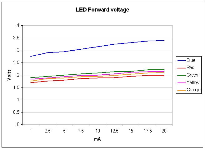

I couldn't get clear charts of the LED forward voltage and so rigged up a simple plotter and measured it on a scope.
Might come in handy for some of you.
All LED's are normal 5 mm types . The blue LED is a 3mm type. All Taiwanese origin.
Cheers.

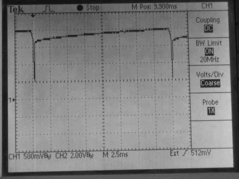

Scope shot
Here is how the scope plot looked.
The source was a ramp voltage which controlled a current source connected to the LED. The voltage across the LED is measured on the scope. The ramp starts at 1 horizontal division and stops at 9 divisions. Each horizontal division is 2.5mA . So it goes from 0mA ( 1st div ) to 20 mA at 9div.
Vertical scale is as shown at the bottom of the screen.
( this LED is red ).
Note: For the vertical scale 0 V is not in the middle of the screen but at -1 div . Look for the pointer on the left of the screen.

This will come in handy. . . Thank you, ashok! I subscribe to several
threads that will find this information useful.
This will come in handy.....
I needed the info and couldn't find accurate measured information and was forced to build the jig to measure it .
I was sure that it would be very useful to many others and that's why I put it up.
Glad you find it useful.
Cheers.
